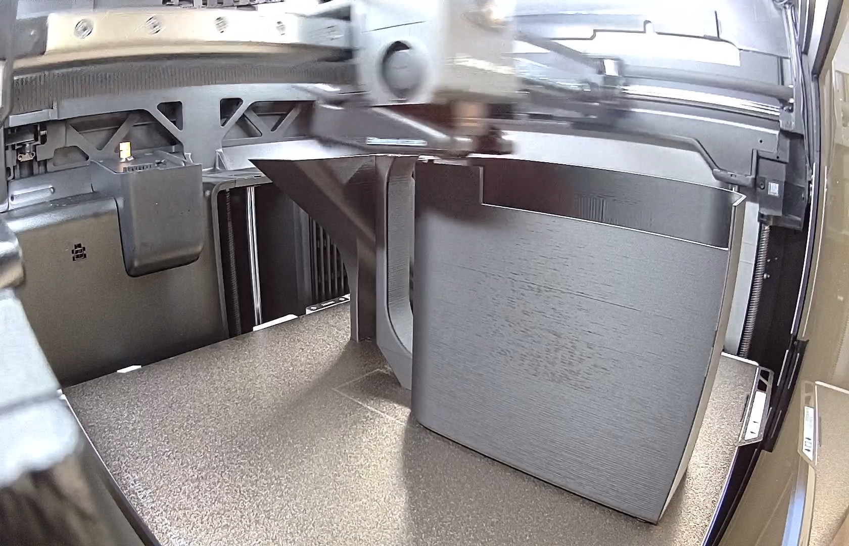

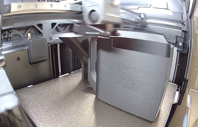

Hey all, just got a new H2S and while the experience has been mostly great, I’ve run into a few prints where the quality has been very disappointing.
The issue manifests as irregular wavy or blobby horizontal lines on taller flat parts. It doesn’t show up every time (although I have not attempted re-prints of any of these problem parts yet) but does seem to be linked to tall flat parts.

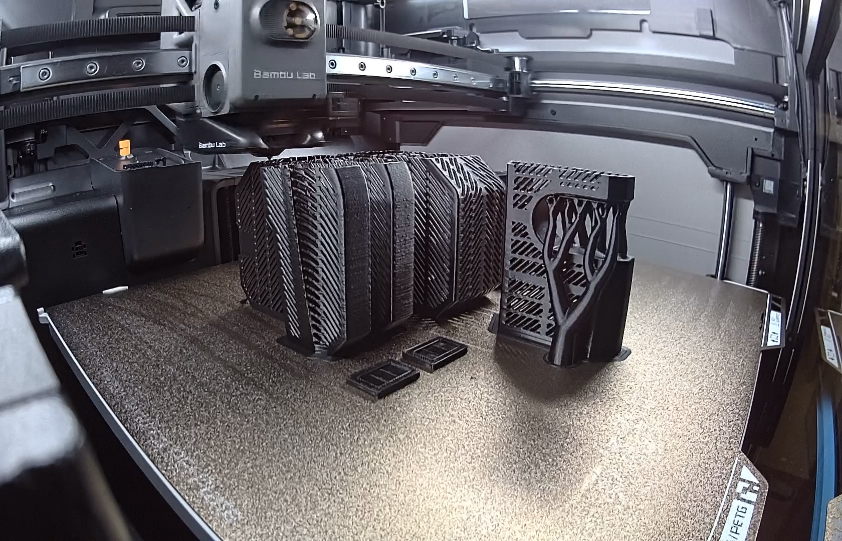

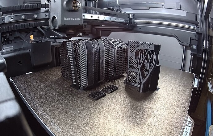

First part is this model printed in fresh black Bambu PLA. The second part is this model printed in fresh black Bambu ABS.

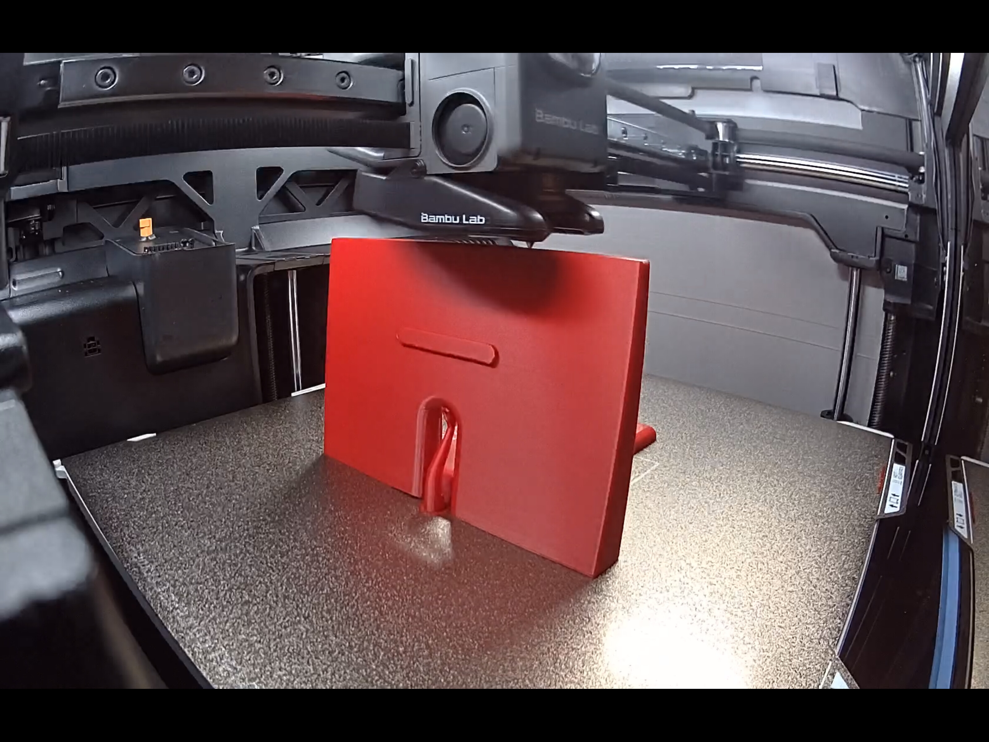

Thie third model does not have the issue although it’s a similarly tall, flat part. It was printed in fresh red Voxel PLA.
I’ve done all the calibrations, etc but I’m really at a loss here. Help!

I guess the question is does this look like a “classic wet filament issue” or is it just a data point?
It looks like wet filament to me. In general, filament should never be considered dry even when freshly removed from its shipping packaging. I would not consider 35-40 percent relative humidity dry.
Cool, thanks for the help. I’ll try doing some tests before and after drying.
I haven’t done any 3D print A/B testing before. Any advice? Ideally I’d like to try and print only partials of those parts (e.g. top or bottom half) but I’m wondering if it needs to be at a certain height to really start seeing issues.
The outer loops in the spool may be drier than the inner if initial drying wasn’t long enough. This could be why you are seeing issues further up as the spool uncovers filament with more moisture.
Weighing the spool at the start of drying and drying untill the weight stabilizes has always been my go to method.
Thanks! Makes tons of sense. I’ll give it a try and report back.
