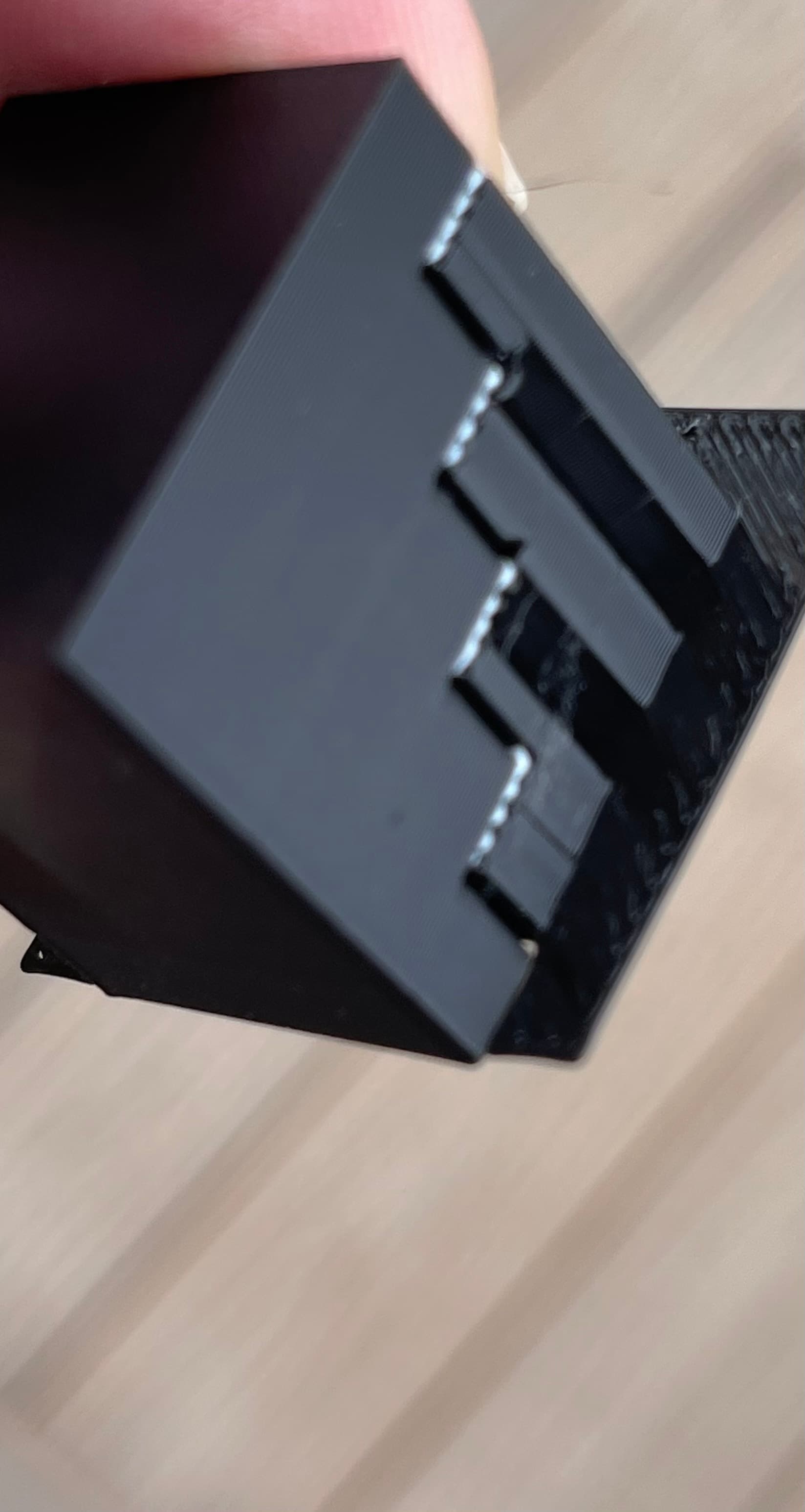

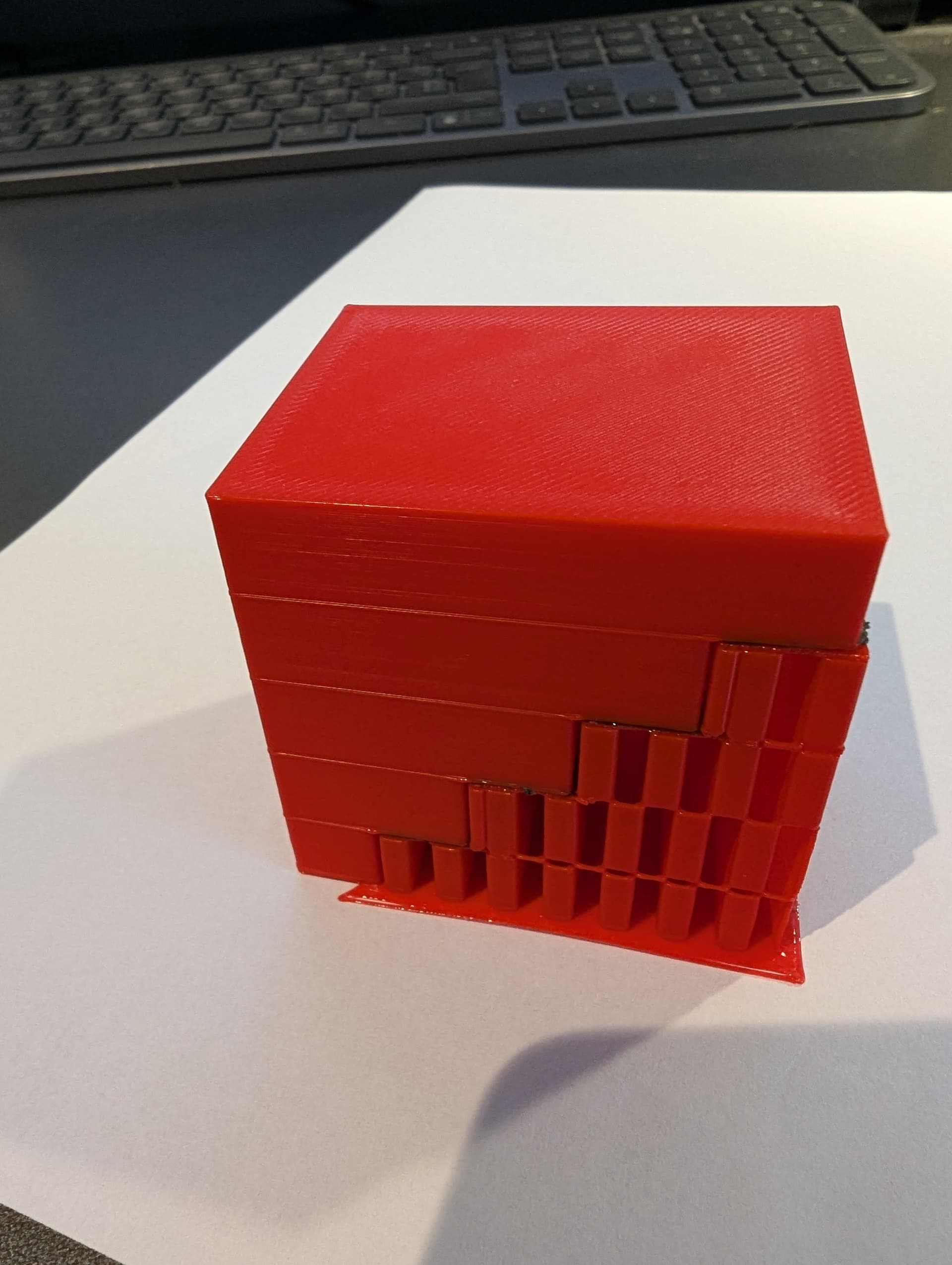

I’m using the second nozzle on my H2D for printing support interfaces, and I noticed an irregular surface on the layers a support interface was printed.
While this is a test piece, I could observe this behavior on all parts so far, where I used support interfaces.
First I thought it is an inaccuracy caused by the nozzle change. But this does not make any sense, as all other surfaces are perfectly aligned. And they align also perfectly after every irregularity (also with respect to each another, below and above this “seam”).
I also printed 2 normal cubes, one higher than the other, with the 2 nozzles. And I expected those irregularities on every layer until the first cube is finished, as the nozzle stops switching then. But the prints were just fine.
So, has somebody an idea what causes this “brims” on the layers a support interface is printed? And how to get rid of this? Looking at the other layers, it does not seem to be an accuracy issue of the axis.

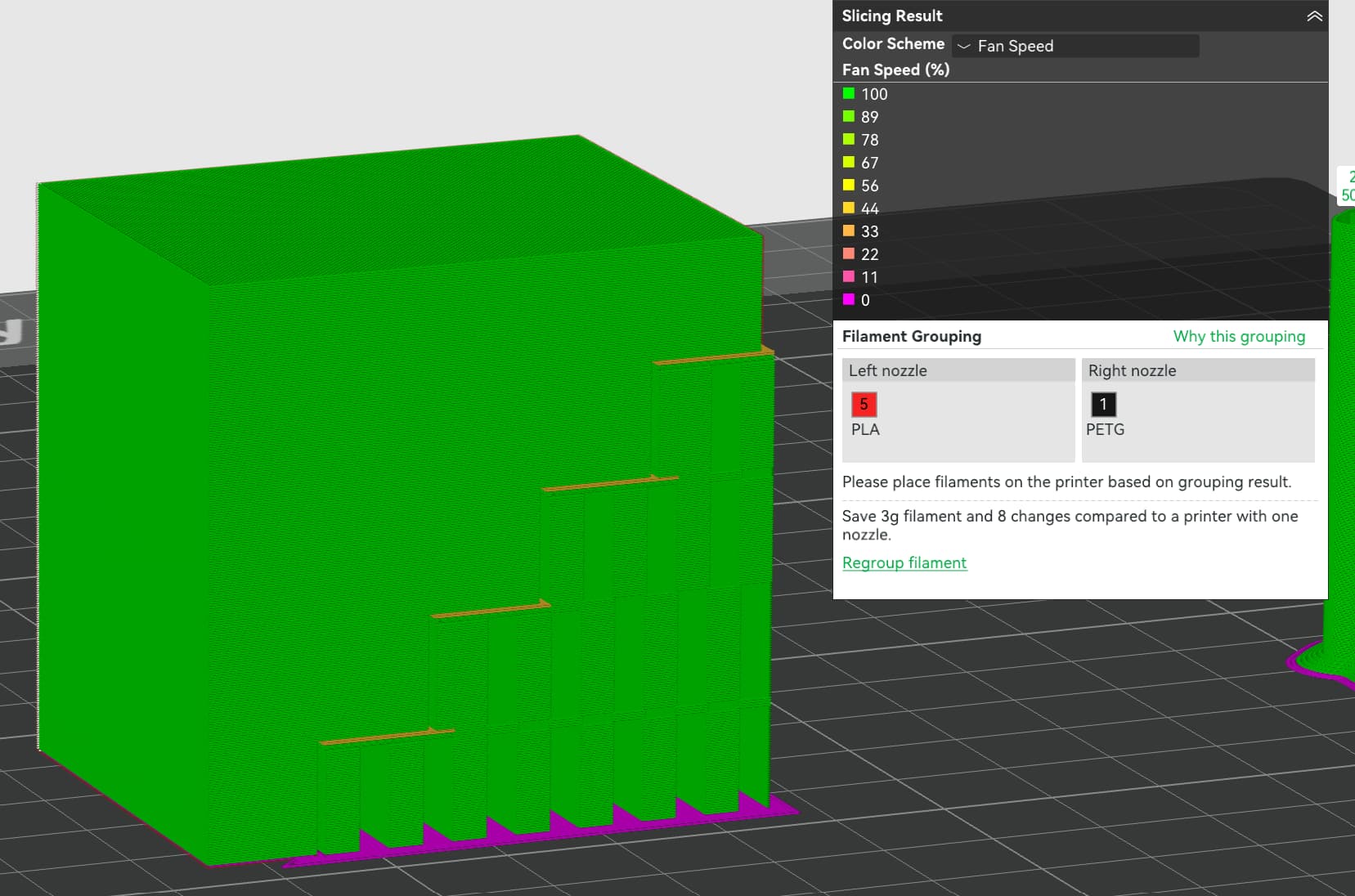

I run 2 tests now:
  1. I printed a part with PLA and another part with PETG. The PLA part was higher than the PETG one, which means, after the PETG part was finished, I should see a difference in quality on the PLA part. But this was not the case. It seems, that it’s only affecting surface quality when printed in the same part.
  2. I switched off the auxiliary fan and changed the cooling settings in the PETG profile to the same as in the PLA. If I understand you right, this should lead to the same cooling the part receives when printing the PETG interface as when printing PLA. But it didn’t change, these lines are still there.
And according to the slicing results, there is nothing different on these layers. line width, temperature, speed…
I’m really under the impression that for some reason the printer is overextruding. However, the only parameter I can find is the first layer line width. And reducing this has no effect either.
So, I’m not sure whether the cooling is really the problem, or is it a bug in the software? Layertime could it be too, but i can’t get equal layertimes, no matter what i try in the material settings…

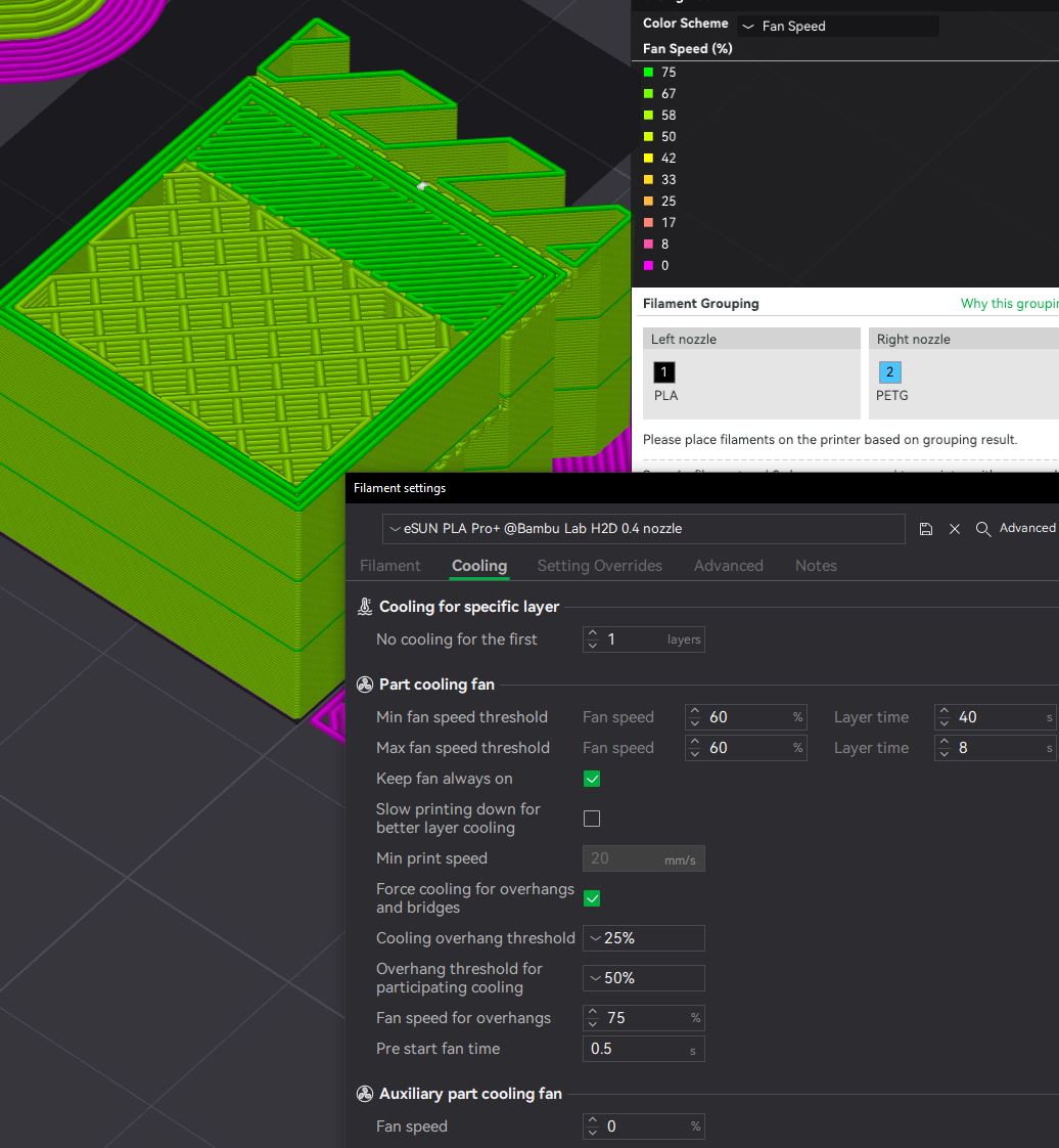

I’m running another test print right now, where I reduced the fan speed to 10%. I don’t really see a difference compared to the other tries. I however observed, that printing on the interface is treated like printing a overhang. The fan goes on full speed and the print speed is reduced. Maybe this is the problem?

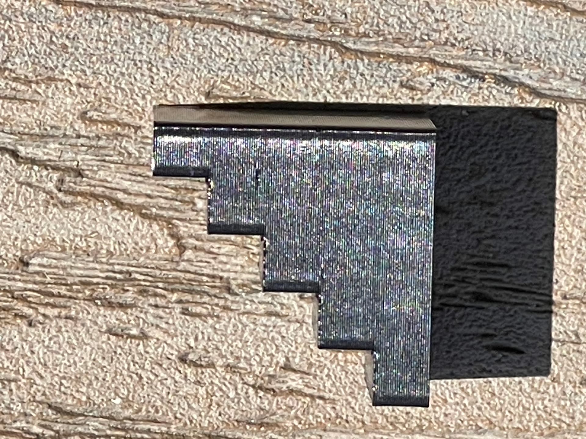

I didn’t get a chance to run the larger 50 mm block print today, but I did manage a quick test using some two-year-old eSun basic black PLA. I just don’t use PLA very often.
Setting used on this support block
Nozzle 215c, small component and low gloss finish.
Layer height 0.2 - standard process
Prime 5 & 55
Wall gen Arachne
3 walls - I-O-I
Shell layers top 5 botton 4
Bridge 30 speed and 135 direction
20% Rectillinear infill do to pla and no overlap
Top & outer 100 mm/s max
Top surface line width 0.38
Inter wall acceleration 6500
Prime tower infill gap 100
Support fan 60 %
Slow down for overhangs off
Model print time 26m4s
I had to reposition the block to make the transitions lines highlight outdoors.
Front of block by glass door - size 25 x 20 x25 mm
Left side (Aux fan off)
Fan Settings:
Speeds:
Layer Time:
I hope this information gives you some new ideas to try as you figure out what works best for your filament and part designs - Keep in mind, some filaments simply aren’t as good as others.
I tried with your settings, it’s not perfect, but i think somewhat better.
That some filaments are better than others is true of course. But I also tried ABS and it’s the same result.
I think I have also to consider: what is a good surface? It’s hard to see in your picture, but I think you got some minor lines as well? Perhaps, it’s the best what I we can achieve right now with this printer and software…

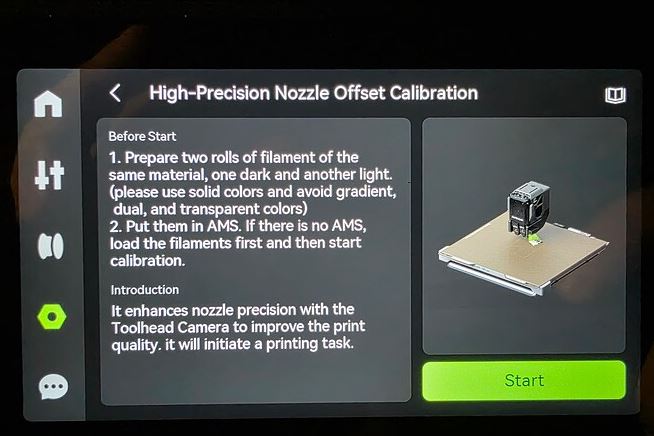

Have you done the offset calibration with the white and black pla filament? I can’t remember if you said you had ?
I also have the vision encoder calibration done on my printer it wasn’t far off, but every bit of adjustment can help.

Have you done this offset calibration ?
Now I have. Thanks for pointing this out. The print quality improved now with all your tips, even though I’m not yet there where I want it.
