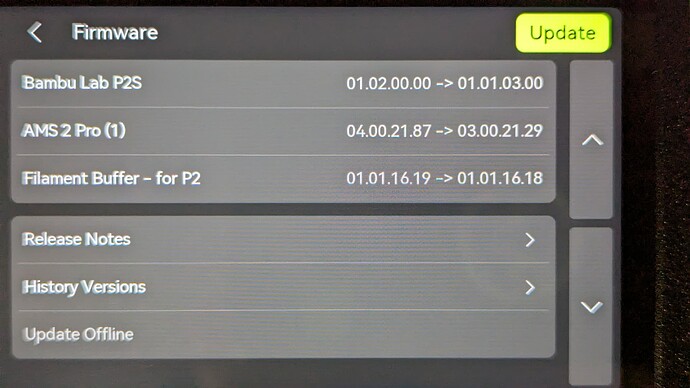

It installed on my system. From version 01.01.02.00 to 01.02.00.00, and 5 hours later it wanted another update. This time it reverted back to version 01.01.03.00. Has this happened to anyone else?
I am getting that same request
Unfortunately, I made the mistake of installing this update. However, I also see that AMS 2 is getting the old version there.
Same issue here with the update that appears to be a rollback. I submitted a ticket for clarity.

that would explain why mine failed when i first got the prompt to update and then it never came back
Now it’s again info about upgrade - I did rollback before.

I power cycled my printer and it hasn’t flagged me to revert back.

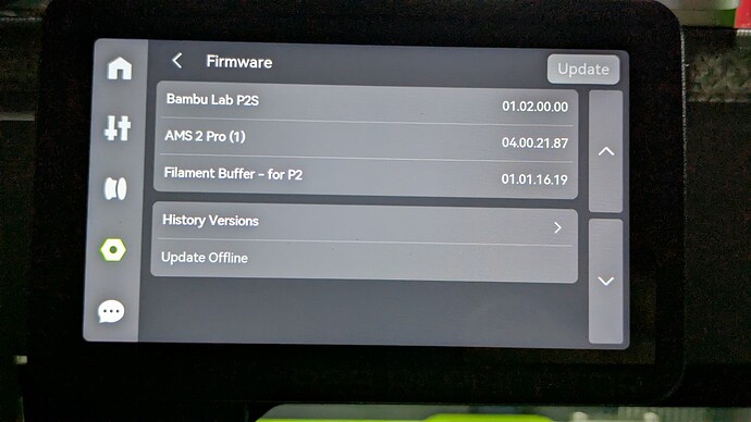

I switched off the P2s for about 20 minutes and restarted it. Now I was able to update it to version 01.02.00.00 again.
Habe eben meinen Drucker eingeschalten und es wurden diesmal auch drei Updates (Drucker, AMS 2Pro und Filament Buffer) angezeigt. Hoffentlich bleiben sie uns jetzt erhalten. :slightly_smiling_face:

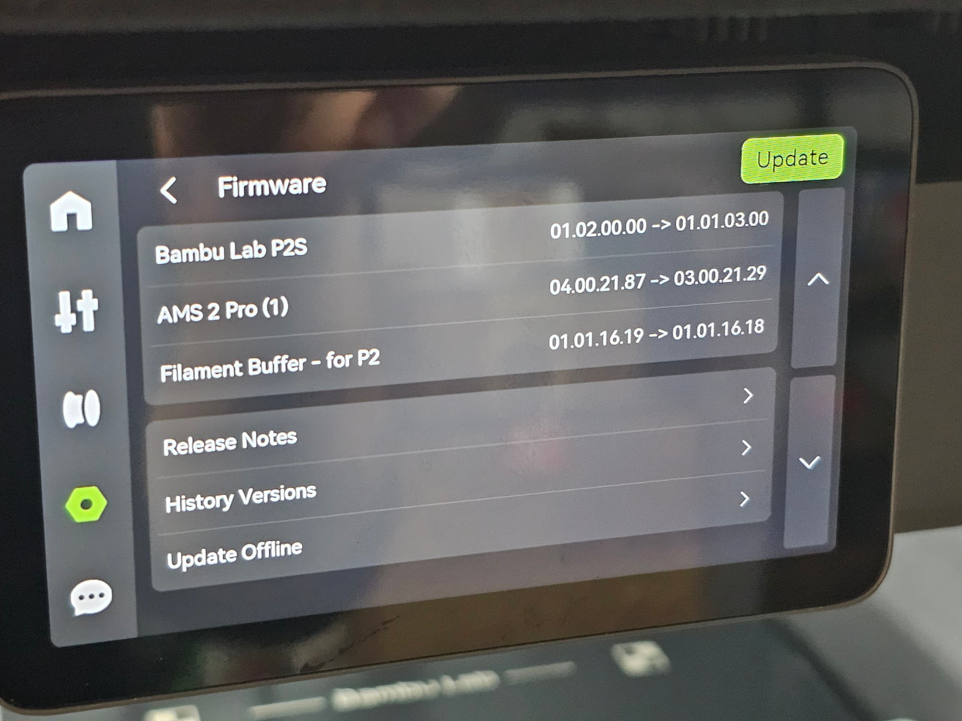

Support suggested I power cycle, after it booted back up I received a warning that the firmware was abnormal and I updated again, everything seems to be in order now after updating again and power cycling again. Going to run another calibration and power cycle just in case.
i updated last night and printed 2 fidget eggs np no issues now it wants to roll back again thanks for the tip in case i get the errors
Yes same here, kind of because it said update to version 1.02 - i did the update came back 10min later and it installed 1.01.03 - don’t ask me why!
