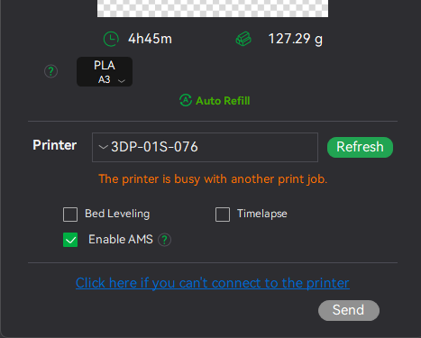

So I was one of the ones who returned the A1 during the recall, I took that opportunity to give Core XY a try and get a P1P combo, I really loved everything about the A1 with an emphasis on the auto flow calibration. Now on the P1P with either the textured or the smooth plate, I do not see a prompt for Auto Flow calibration.
Screenshot 2024-05-24 210241
Is this not a feature for the P1P?
