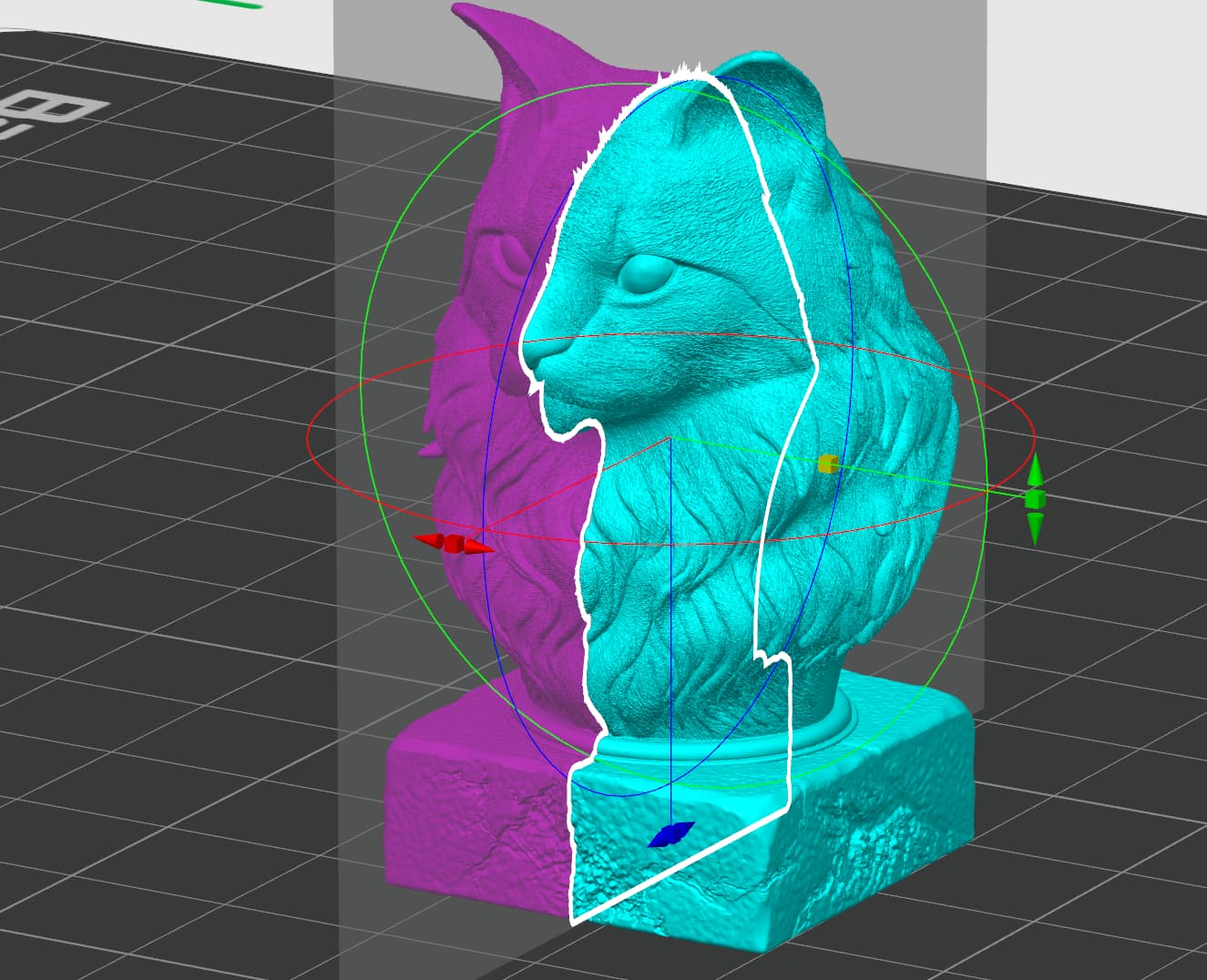

I have a large model that I would like to print and (eventually) fill with resin for strength and stiffness.
When I cut the model into parts, walls are created, which is logical for most cases. However, I’d like to leave those sides mostly open so that when the object is assembled I can pour the resin in and it hardens as a single contiguous piece.

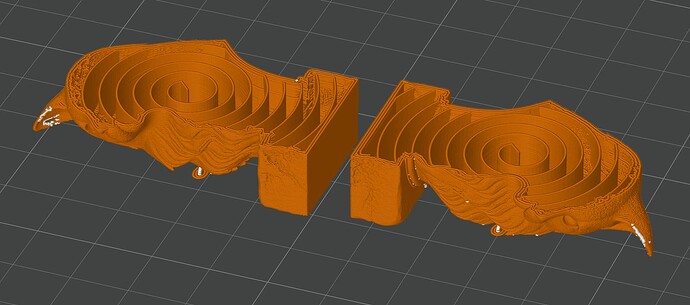

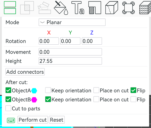

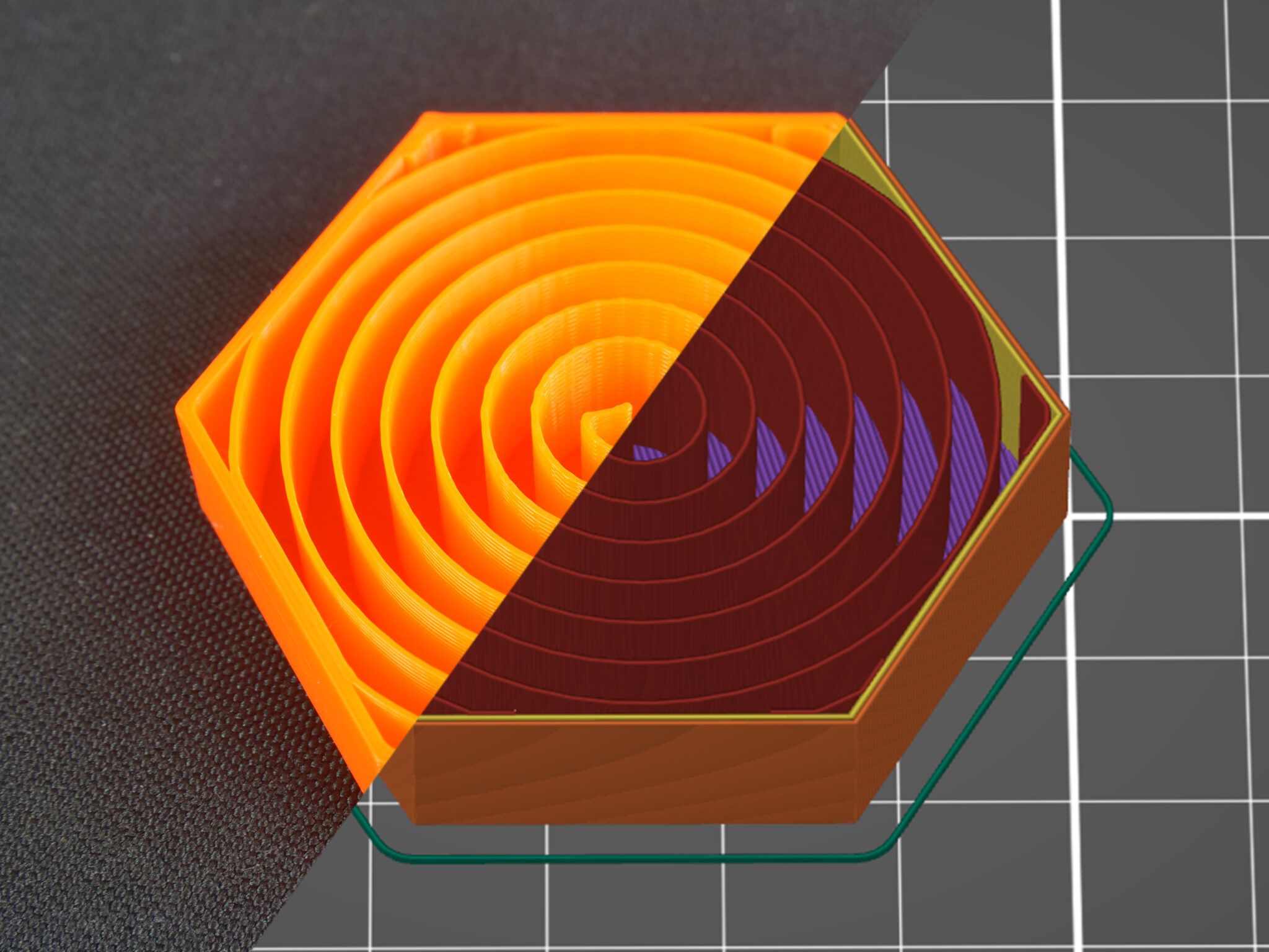

Yes, that is possible, but it involves a few extra steps and you will lose maybe a few millimetres in the process. First, it is important to select an infill that also supports filling like Archimedean chords

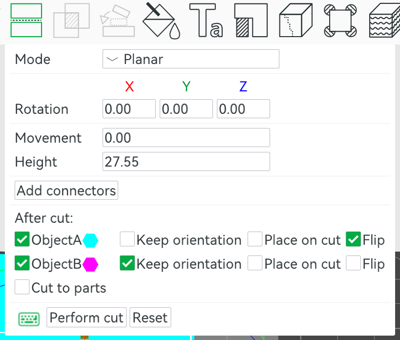

Then make your cut: Also make sure that you set the checkbox for flip if necessary on an object, for example.

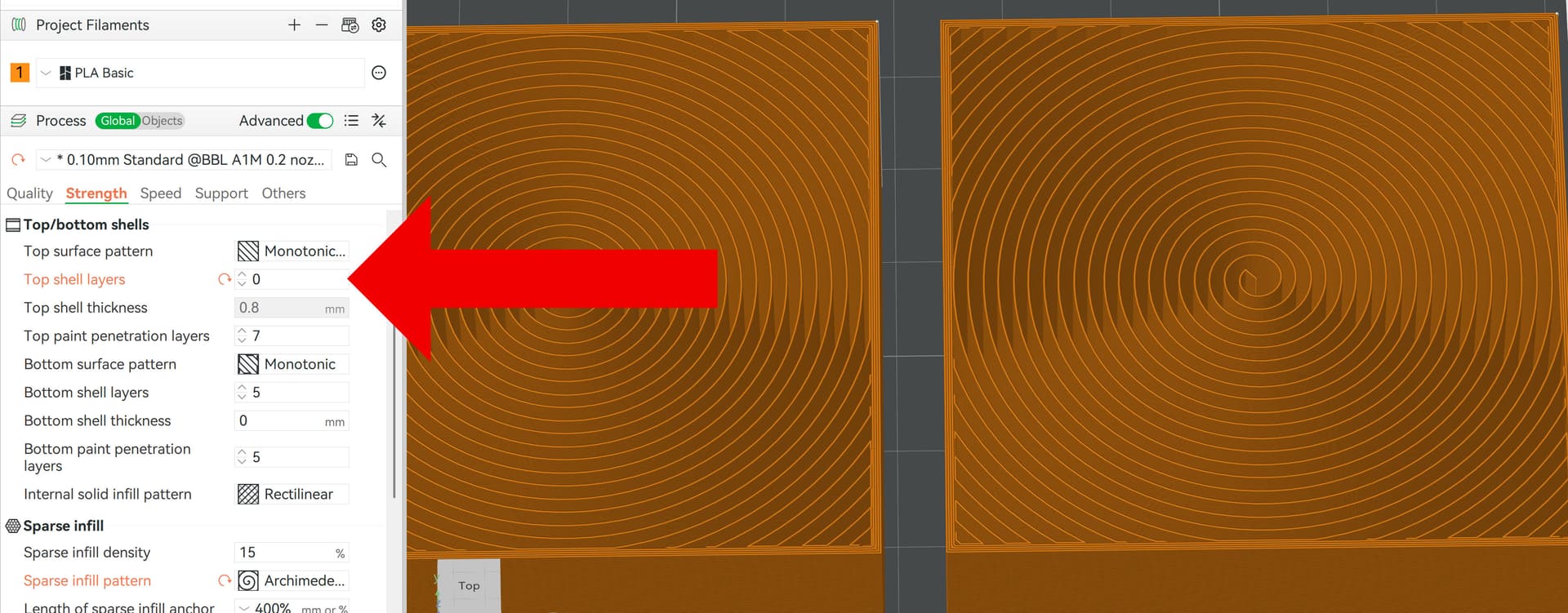

Now you need to set the following settings: Top shell layer 0
However, this approach has one drawback: it only works with objects positioned upwards. Or, to be more precise, the area where the infill should be visible. This means that you have to make sure that the object is actually positioned upwards.
