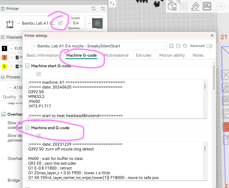

Is it possible to make the build plate not move forward after finishing?
A1 mini- I am wanting the build plate to stay in the same position it uses for the timelapse feature so that it doesn’t ruin my timelapse videos… when it moves forward at the end it moves the print out of frame entirely. ty

You will need to edit the Machine gcode in Bambu Studio.

This is hard to see in the small box, copypasta it out to notepad++ or something if you want a more pleasant experience
Start at the end, scroll up scanning thru it, the code is reasonably commented in english
You’re looking for G1 or G2 commands with Y in them (Y axis being your bed)
The nearest one to the end I found for an A1 on firmware 1.04 is
G1 X-48 Y180 F3600
Change that 180 to the coordinate you want it to land on instead
