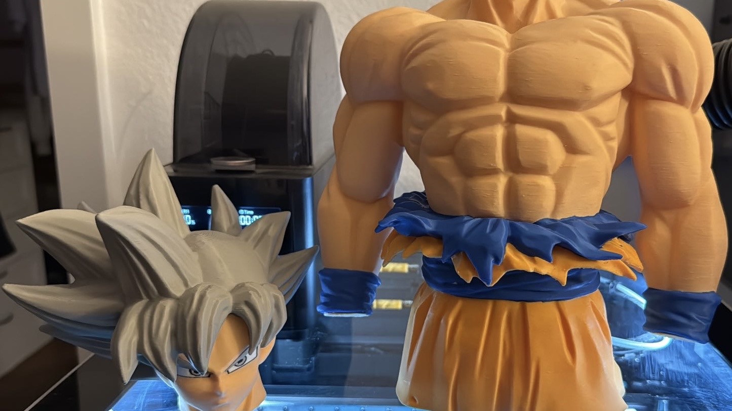

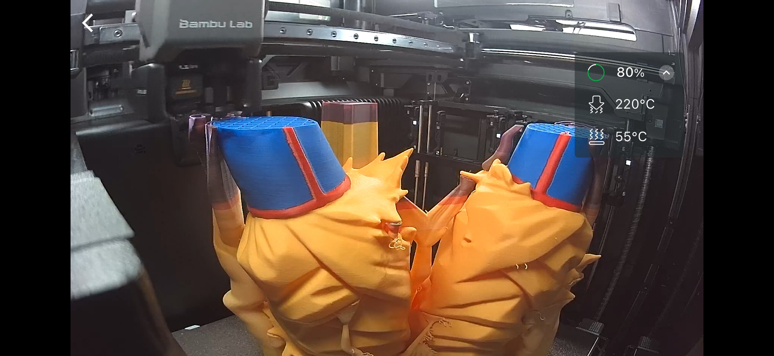

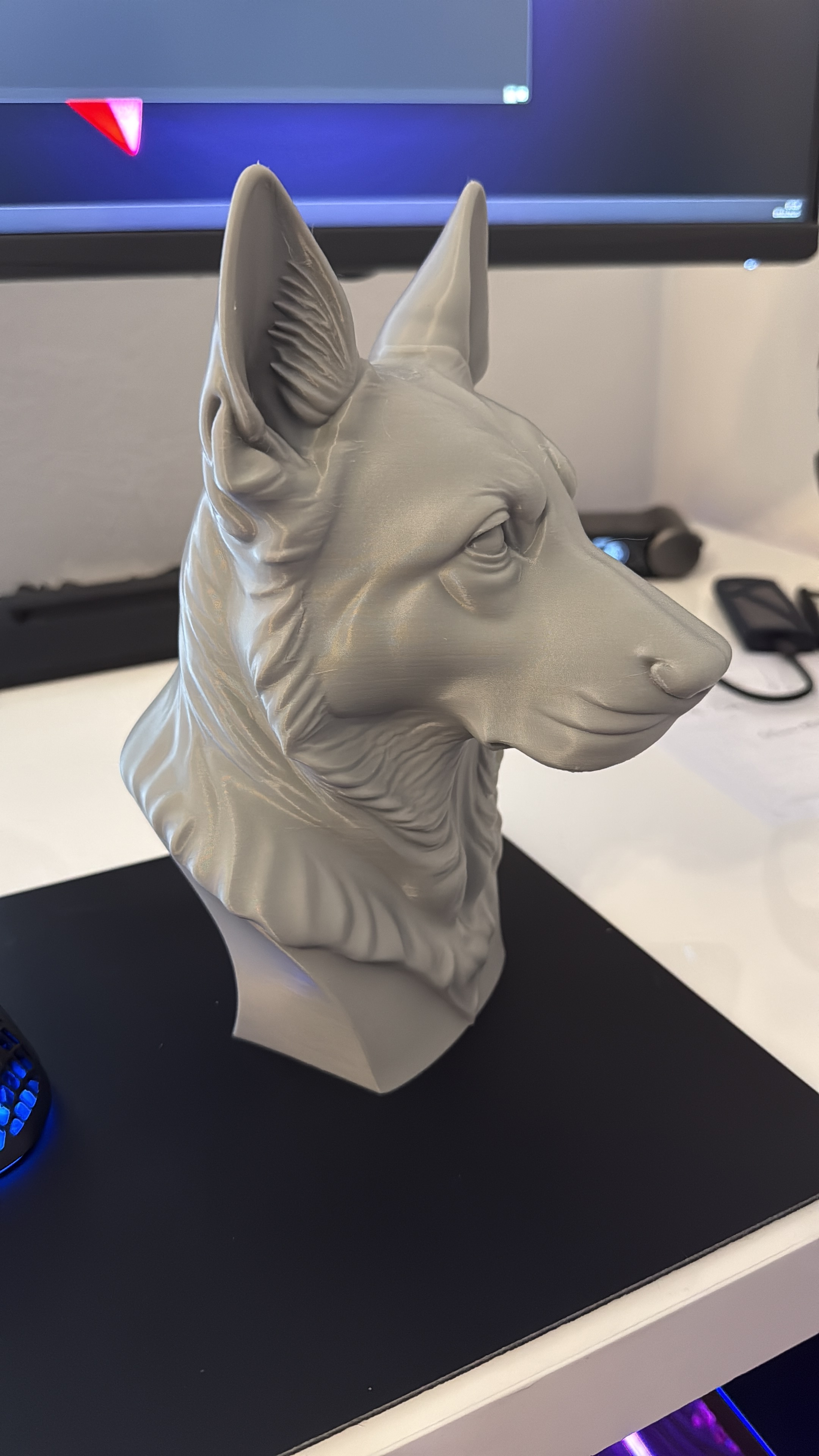

This was our first H2C print for our protection dog club and a Dragon Ball Z character
This is an almost 3 day print of the 70cm tall Son Goku legs part. I choosed the less waste purge tower method, so there are some strings left on the parts, but nothing serious. We are very happy about the results

Or maybe the toolhead got lighter and has a better effect on the input shaping algo. That what can be seen as Z banding on the dogs head are artefacts of that AI based stl files
