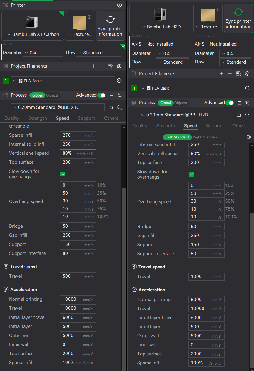

  1. You CAN print as fast, but the default profile is different, so you have to match up that profile to make it print as fast. Default acceleration for H2D when printing is 8000 while X1C is 10000. Both are capable of doing 20000 at the cost of print quality. You can tune it yourself.
  2. H2D currently has an annoying forced cooling for PLA, TPU& PETG. You can turn it off by modifying the start up gcode in slicer. Not too hard but it’s an extra step anyway.

The H2D nozzles / extruder are FAR superior to the X1C. I get 20-40% more flow for the same nozzle size. This will far surpass any “perceived” acceleration differences with the default acceleration settings. (I’m calling BS on anyone that says they can tell 8k vs 10k accel on 99% of print times.)
Uhm, no, acceleration is the most important part about print speed. It’s probably more important than VFR. A higher acceleration means that even for short moves it’s still moving faster than before. Unless you’re printing very large but simple geometry (e.g., a 30x30x30 large cube), otherwise 99% of the time a machine with 20% higher acceleration but 20% lower max VFR would be faster. With 0.4mm nozzle it’s pretty hard to hit the VFR wall.
Play around with the Acceleration chart on this web page before you spout nonsense. RepRap Calculator - Original Prusa 3D Printers
8k vs 10k wall acceleration default is going to be imperceptible. we are not talking 1k vs 10 k vs 100k here.
exactly, so if you cant hit the max VFR why do you care about acceleration on walls? If you are flow limited you are velocity limited. Peak print speeds of 200mm/s or 300mm/s mean the time difference to reach those with 8k vs 10k is microscopic. Have you even tried comparing the slice times?
The default slicer settings are almost IDENTICAL
If you were printing at 10,000 mm/s you would have an argument. Without this mystical printer and plastic you have no argument to stand on.
edit: oh wait…H2D has 1000mm/s travel speeds. so it would be faster. thanks for attending this ted talk.

I’m not talking hypotheticals or saying “I think it is slower.” I’m speaking from my factual experience in many of the same prints done on both machines. I know it is slower especially w/PETG. I’ve actually compared screenshots side by side on color models and I’ve also printed those models on the H2D and P1S. I’ve posted results. The H2D is up to as much as an hour slower at times. Sometimes some prints it’s only 10m slower but sometimes it is much more.
Alright here is a real world example printed in Bambu PLA. I designed this helicopter. Here is a 4 color TMNT version.
4 color Cockpit body on P1S 12:39
4 color Cockpit body on H2D 13:21
1321 - 12:39 = 82 minutes (1h 22m more on the H2D)
It’s the same thing on 2 colors with 66 color swaps when printing the engine. The P1S is faster. It visibly prints faster. I tried changing the acceleration from 8000 to 10000 but that doesn’t do anything because it probably never gets a chance to hit those speeds.
Not for nothing but when you are paying big bux for a machine with 2 nozzles I thought it would print faster but it’s only when you get to hundreds of swaps that the h2d is faster. I have another cockpit body with gold lining the cockpit, 3 colors total, it has around 450 color swaps. In this case the P1S takes around 24h, the H2D takes 16h. Before the H2D I just painted the gold on.
The photo shows the TMNT Helicopter sliced and compared and printed on both machines.
