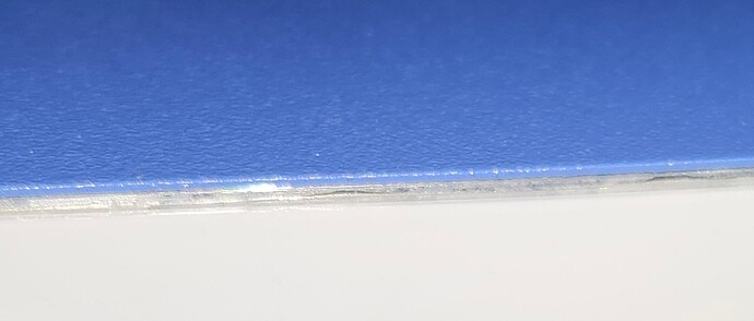

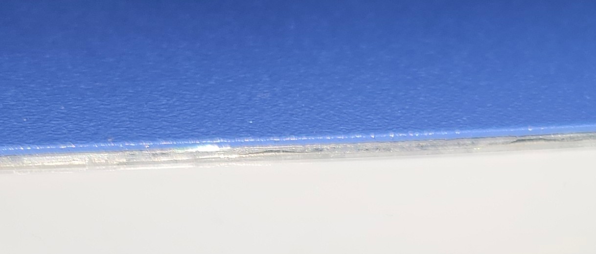

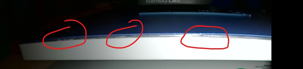

Is the A1 heatbed supposed to look err..wonky from the side?
I have a new A1 and I don’t notice it from above and it prints fine, but i’ve noticed when starting prints through the camera view my heatbed looks almost like it has large crackes and uneven spots running through it..Is this normal? it just looks very off.
Use your eye not the camera.
the camera distorts the image. It’s not a good camera.
The onboard camera does blow it out more, but they are visible to the naked eye and still there with a “better” camera. While small I’ve owned quite a few 3d printers in the past and never had what looks like delamination in a new heatbed like this

Just want to mention that that’s not an official Bambu plate… It’s blue bro.
my question/concern wasn’t about the plate, it’s the heat bed under the plate..the two are completely unrelated. The third party plate is, ironically flawless(bought it because the textured PEI that came with the printer had some patches w/ the texture stripped off that I didn’t like showing on the bottom of my prints) (it’s a biqu)
From what I can tell from the pic (I don’t own an A1), it appears to be the aluminum bed plate which appears to have been cut using a shear that double tapped the cut. IE it tried to cut the plate in two presses. Either way it’s just a cosmetic finish, it will perform just fine. It also looks like they wire wheeled the edge to smooth it out.
Bottom line, it’s nothing I’d be worried about at all. Perhaps others with an A1 can chime in and confirm their’s look the same as your pic.
