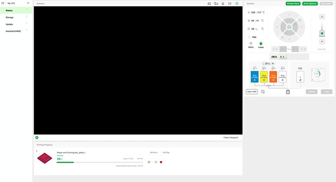

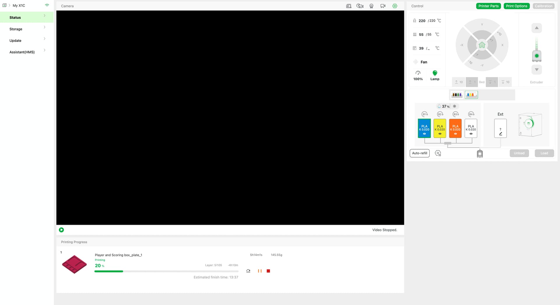

All,
I’m running two AMS through a X1C. When I look in Bambu studio in the device tab it shows all the filaments there in the kinda display traditional printers use for ink, but they all look equally full but at least two of them are halfway gone from Prints I did on my X1C. Is there a setting somewhere I need to enable to have it track the amount of filament left?
In my AMS I am only using Bambu filaments, sorry I didnt put this in the first time.

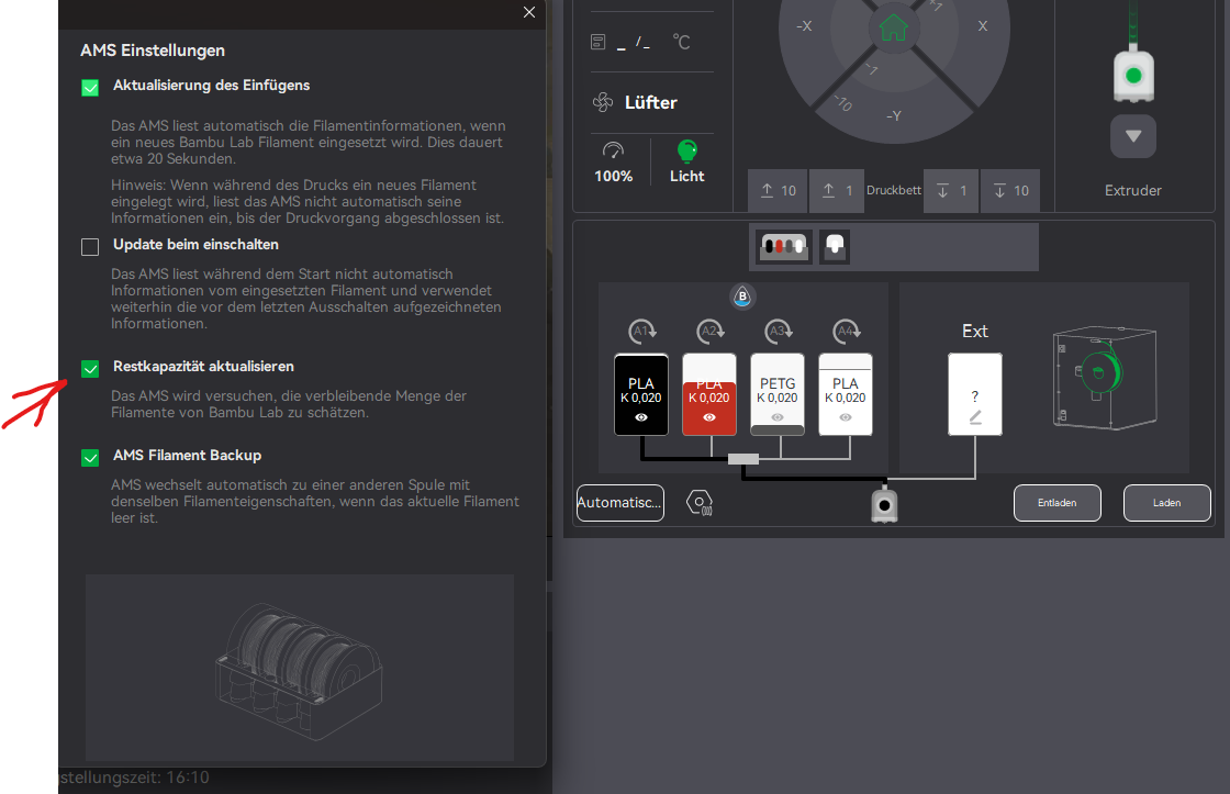

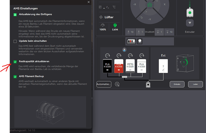

Bei mir wird der Stand der Spulen im Studio angezeigt.
Ist aber sehr ungenau …
Ich musste das allerdings aktivieren (siehe Pfeil)
The tracking only works on Bambu RFID spools, and it needs a few revolutions to determine the amount left.

Einstellungen AMS.
Siehe Bild …

you click on the button next to the auto refill, then click on what marcus showed, which is update remaining capacity
