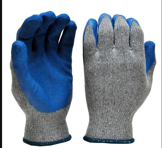

How dare you say such heresy against my IRL Power Gloves!
Those blue rubber dipped gloves are like crack cocaine to my aging body. Not ideal for thermal but good enough for a nozzle, too
