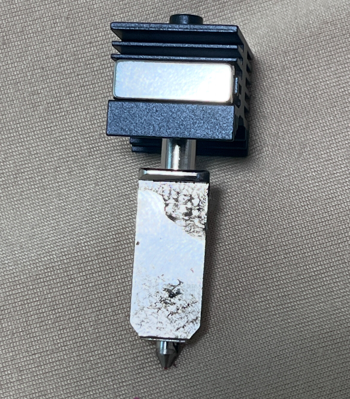

I was trying to heat on the TH and took the hotend rifht away as soon as it gets 200 degree Celcius to wipe them while it’s still hot but it didn’t work fine.
Is there any alternative method to remove them without 3D printer?

Usually some IPA works well. Spray some IPA on it and then wait a bit, then use your scraper to remove the residues. You don’t need to cook it up to 200C.

If it’s ABS or ASA, acetone might help.

Start with acetone. There’s nothing on that surface that it might harm, except the crud.
I’d recommend sticking with chemical solvents and avoid abrasives except as an absolute last resort.
I was just thinking acetone! It works awesome!

Acetone doesn’t dissolve PLA or PETG. You need more harmful substances to dissolve them.
You can google them, but if that is the case, I would try to remove it physically by gently scraping it off.
I use a fresh razor blade held at an extreme angle. It will also chop off any aluminum burrs on the edge of the heated surface, that may be creating an air gap
I use a brass brush since it is softer than the nozzle

I use a larger Dremel tool with a stainless wire brush tool. Be aware that the wire brush will start shedding individual strands of wire after a while
I’ve been using a nice new utility knife blade. It worked super well! Of course make sure to keep the blade at a shallow angle to you don’t dig into it. It’s a very fast, simple, compact and affordable solution without the need for Isopropyl Alcohol (IPA), Acetone or any other chemicals.
