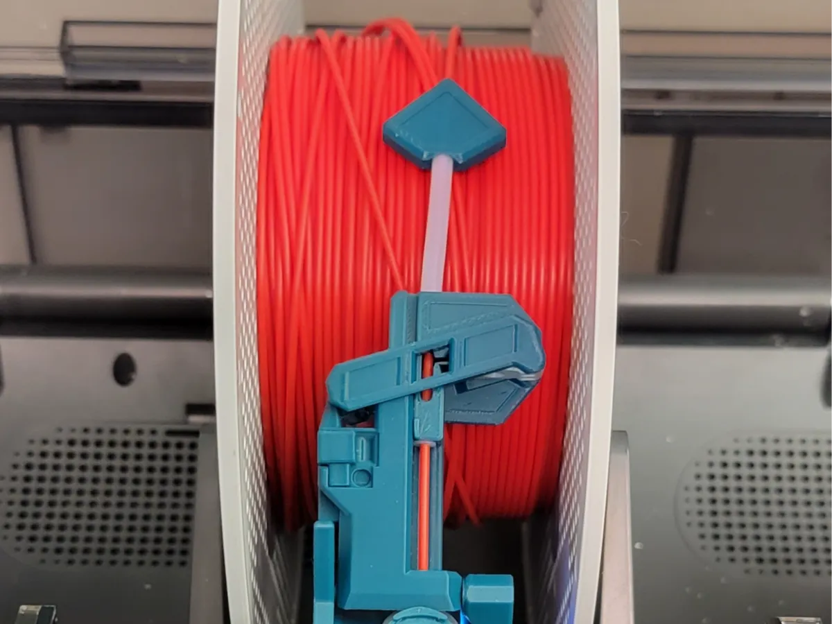

Is there such a thing as a filament tension sensor?
Like a runout sensor, but which stops a print when the filament becomes too tight.
I’ve had a number of problems with poorly wound filament that has become knotted or tangled on the spool, or where vibrations have caused the spool to move and filament to become wrapped around the spool holder.
There is still in the print feed mechanism to the runout sensor is not being triggered, but the head is pulling against a tangle and no more filament is being drawn in. So I’m not getting any feed or print, and the printer is still going.
I’m like some form of sensor that acts like a runout, but if the filament isn’t feeding. Does anybody make one?
I’m not confident that I could make my own. I don’t have the tools, experience or background knowledge.
I’m not aware of a type of sensor that could prevent it, though I imagine there’s people smart enough that could create one.
I personally use a filament cutter that triggers when a filament snags, or has tape that pulls off the spool, or anything else that prevents feeding.
