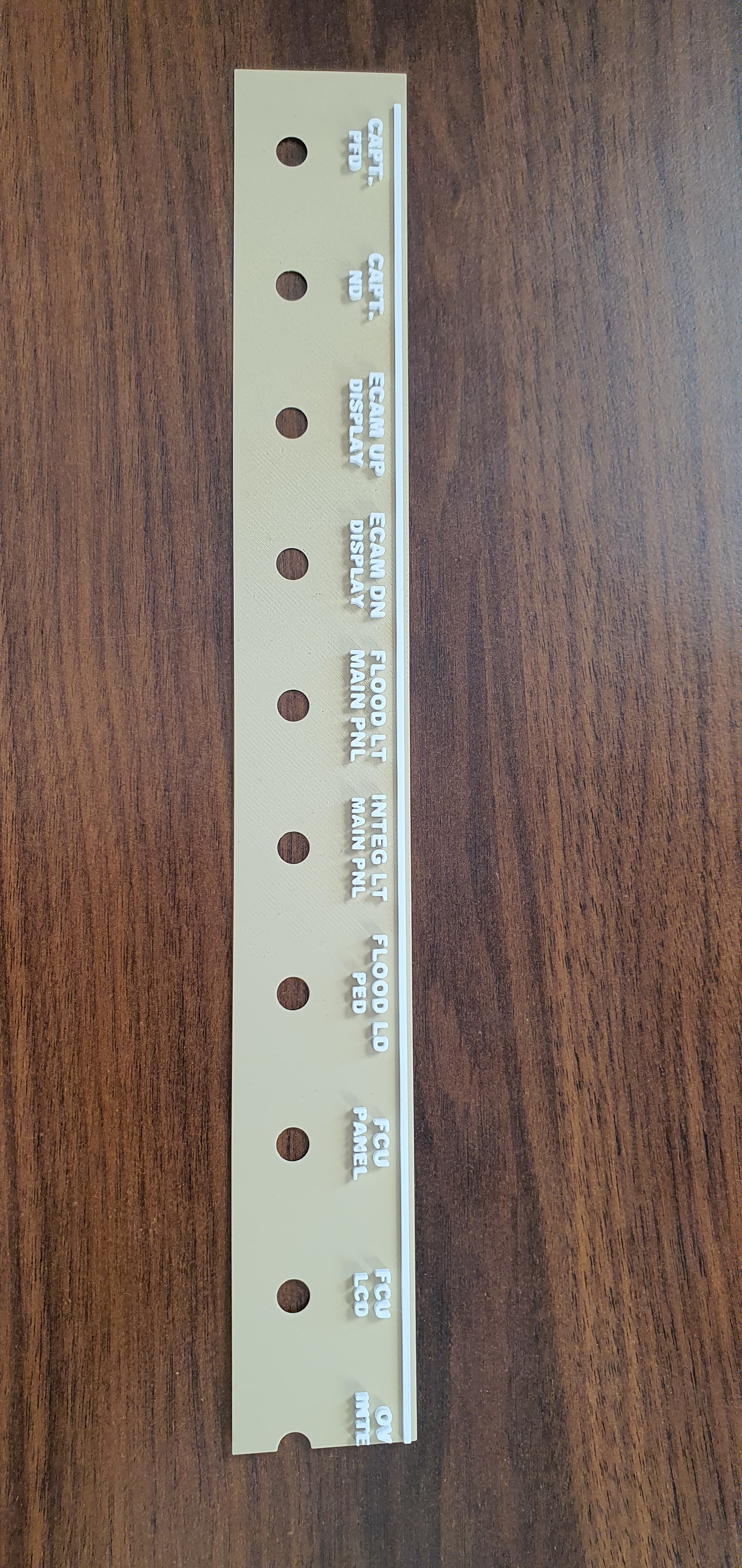

From few weeks i own a P1S printer witch prints flawless in my opinion, no problems at all … but :wink:
during the last print I noticed a problem that I had not seen before on any print. The print is a flat label for my sim panel.
During this print I used the Ironing option, which showed this problem. Additionally, the print is very low, only 0.4 mm but it is 297 mm long, so I placed it on the table diagonally. Less than half looks really great, it is smooth as a mirror under the finger :slight_smile:
unfortunately on the rest you can see something like this.
I printed this element twice in the same position and the effect is the same in both cases. It looks like a poorly leveled table to me, but I prefer to ask more experienced users :slight_smile:

the ironing occurs in a pattern, at an angle. One side is good one side isn’t.
check your slice preview
find the layer of that ironing
roll forward the replay slider and see, which end prints first?
If the good end was first, slightly increase ironing flow, try again
If the bad end was first, then I don’t have a lot of ideas other than bed level as well :slight_smile:

In my case, the good end was printed first, but this is not entirely true.

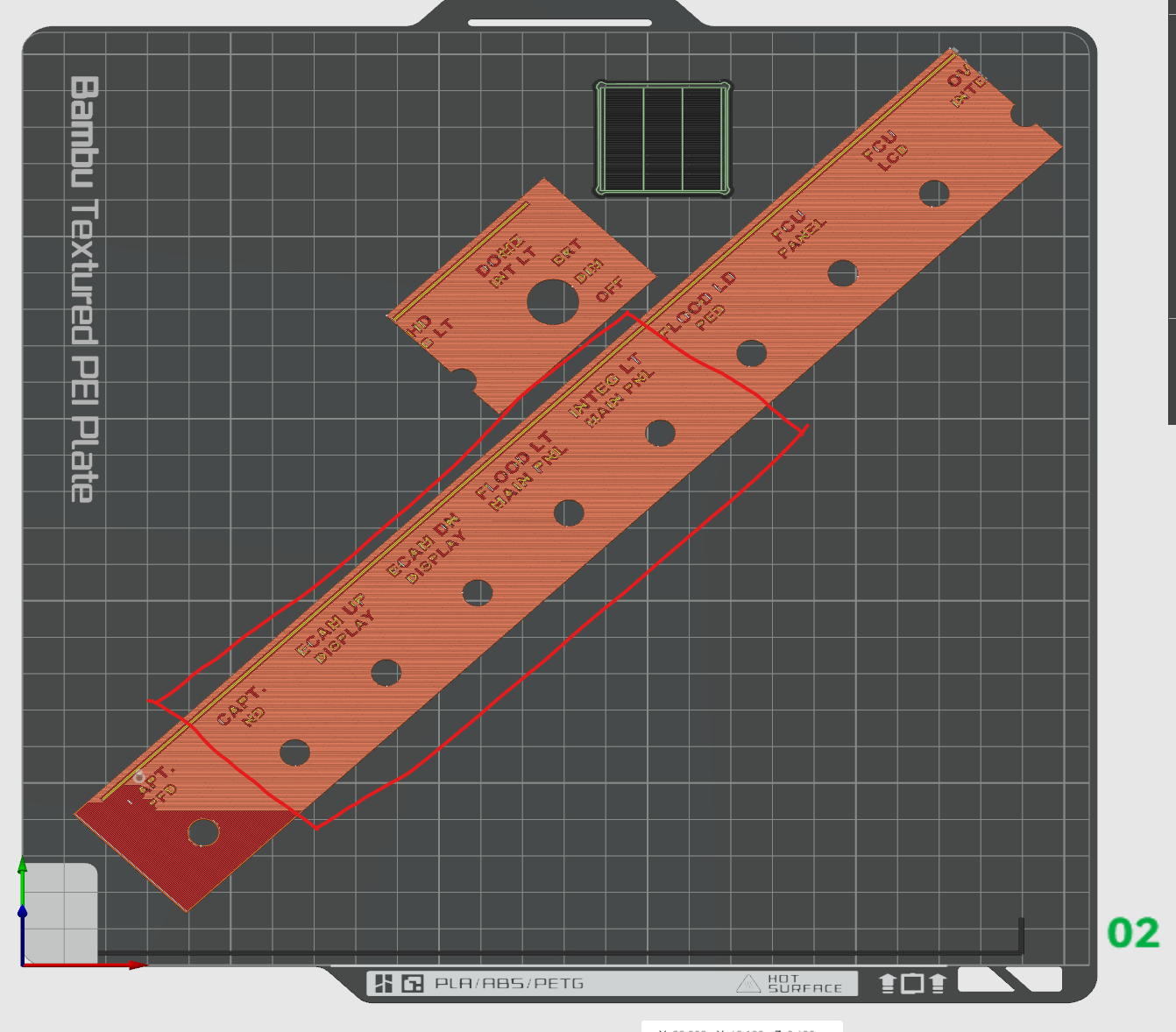

If you look closely at first picture, you can see that Ironing first looks nice (from the side of the FCU LCD text), then ugly and finally again nicer (from the side of the CAPT PFD text). It looks like the ironing was bad moslty on centrer of the plate. I checked the Plate and it looks ok to my eye, and adheres well over the entire heatbed.
Ironing was done in this order:
The second part on the plate looks entirely good, but this i think means nothing cause it is layer of another part it’s small part.
Rotate the print 180º and print again. If the problem stays on the same side of the build plate, it’s plate leveling or maybe a slightly bent nozzle. The issue is mechanical. If the defects follow the model (move to the other side with the end-to-end swap), the problem is the model.
