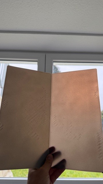

Hi,
I had some issues with my new H2C. Prints were glued to the build plate - even hours after the print was done it was not possible to get them off without force. I then did a first layer test and could hear the nozzle scraping the print causing “ripples”.
I then followed bambus first layer optimisation guide.
I tightened the nozzle heating element screws, i loosened the bottom front heatbeat screws and after that did not really help i also did a manual bed tramming with the provided gcode. I also changed the left nozzle and also used a different one on the right side. Just to mention it: the build plate is cleaned, the filament (bambu PLA) dryed and the printer is fully calibrated including vision encoder.
This is the result after all that. the left part was done with the left nozzle, the right part with the right nozzle. Regarding their wiki i would think this is not in the acceptable range. My old P1S for example was able to get this done without any ripples.
BR
Which Firmware do you have on that machine? I had a similar first layer, nozzle too close to the print bed. Gone after Beta FW Update! Now on 01.01.02.00, still a nice first layer
forgot to add. This is happening with the most current firmware (released yesterday) and also happend with the one before. After the Update the Printer was again fully calibrated.
