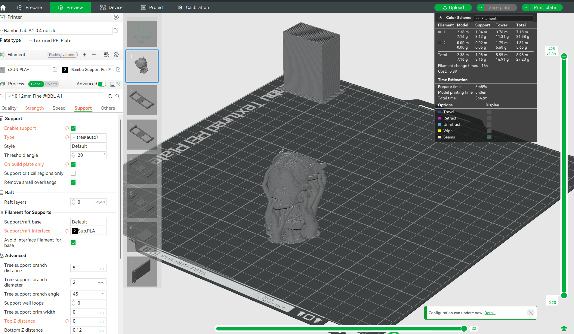

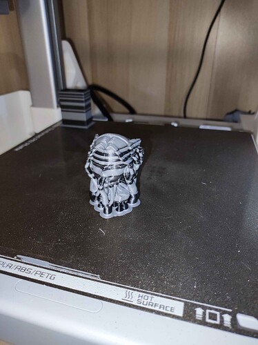

Is this how support breakaway should work?
This is how a model with gray pla and pla-support materials ended up looking, and I am not sure if this is how it should be or something is wrong?
I have used default settings with support material set up as a interface (and accepted default settings for supports when prompted to)
Slicer vs print:
You need to set your flush vilues as I suspect they have defaulted to 0. There is a “Flushing” button on the left side above the filament selection iirc. Set the “multiplier” value to 1 and recalculate.
Indeed it defaulted to 0, I will do a reprint tomorrow and see how it looks then, thanks :slight_smile:
