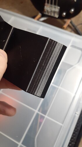

A1 mini printer, about 150 hours of print time.
These artifacts show up on all of my prints at slower and fast speed. My first thought is something is loose however it does not seem to be.
My understanding is the vibration calibrations should give an error if your belts are loose. This is especially noticeable with PETG, or anything shiny.
Is this just what bed slingers do? Or will upgrading to a core xy printer mitigate this issue? I no longer have a core XY but I don’t recall this being nearly as big of an issue.
This is normal among all printers. They are called VFA’s (Vertical Fine Artifacts.) It is when the printer hits a resonate frequency and it transfers into the print. Every printer I owned or worked with has it. The best way to reduce it is to keep it lubricated and run calibrations frequently and make sure the printer is on a stable surface. Hope this helps.

You’re seeing ringing/ghosting artifacts near and around corners? This is caused by the print suddenly changing in directions. Remember that a “bed slinger” has to move and stop the full weight of the bed and the part when this happens. Looseness in the motion system such as belts or linear/rails guides translates to these imperfections.
The easiest way is to check to make sure your motion system is tight, printer is calibrated and most significantly is to simply print slower.

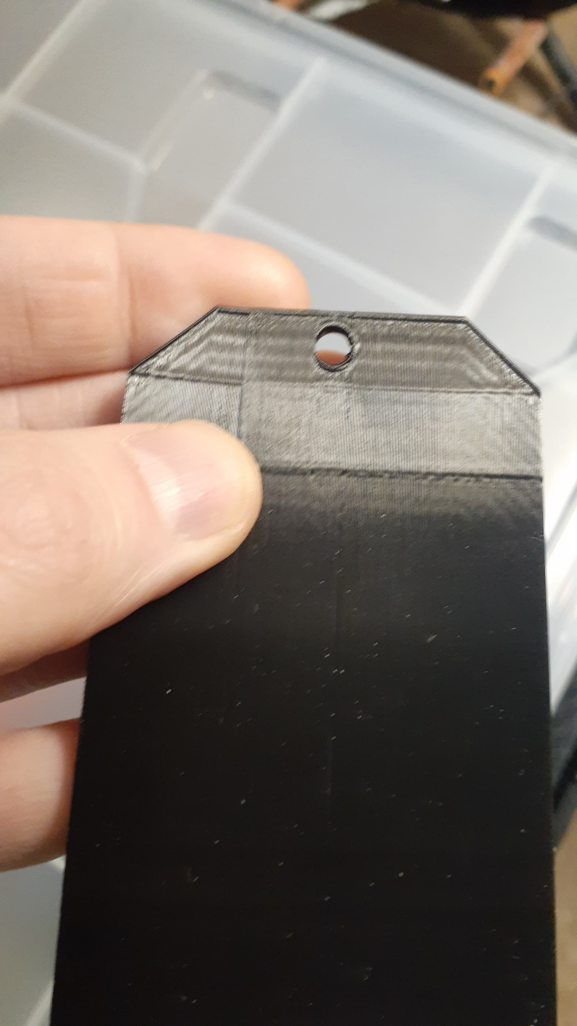

I always print at 50% and the problem is vertical ridges as if it is VFA’s. It is driving me insane as I print Christmas gifts.
Vertical ridges along the entire side of the part or only in the corners? Can you provide pictures?
