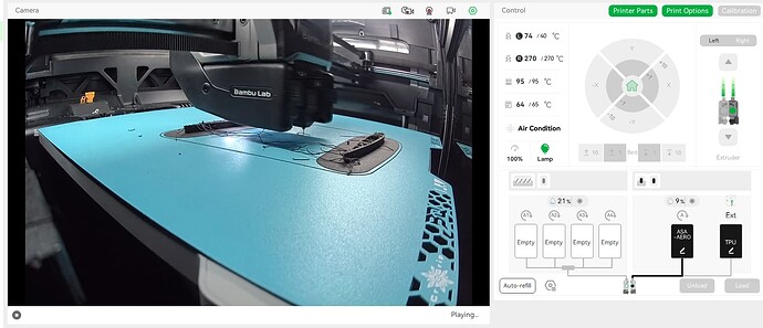

Hi folks,
First time printing a foaming filament. Spectrum ASA Ultrafoam to be specific. I’m maximising the expansion at 270deg.
I ran the Flow Dynamics, Coarse Flow Rate and Fine Flow Rate calibrations and I’m not really worried about the surface quality, it seems good :crossed_fingers: - I have also seen videos where people simply wipe off a hairy surface when a foaming print finishes. So I dont think this is completely ‘abnormal’.
However, this is not ‘hair’, it seems to be dragging filament across the bed while it is still extruding.
I’m guess its not ‘extruding’ its still ‘expanding’ out of the nozzle. Maybe I should only print one part at a time with this filament?
I dont want it to trigger the spagetti detection. I also dont want to turn off spagetti detection because the first time I tried this, it got into a big spagetti mess further up the print and the AI caught it for me.
Any advice would be welcome :thinking:
Hi, yes that’s the general recommendation I’ve read on most foaming filaments. The less movement w/out extruding, the better, since it will keep oozing for some time. I’m not familiar with this particular filament though. But you may get some tips from the BL wiki page about their ASA Aero filament: https://wiki.bambulab.com/en/filament-acc/filament/asa-aero-printing-guide

It’s filament that definitely likes to ooze.
The distance between the parts is quite large and one of the reasons for your issue. As mentioned above, printing one at the time wil help more. If you really want to print both together, reduce the distance dramatically. Don’t worry about the brims crossing.

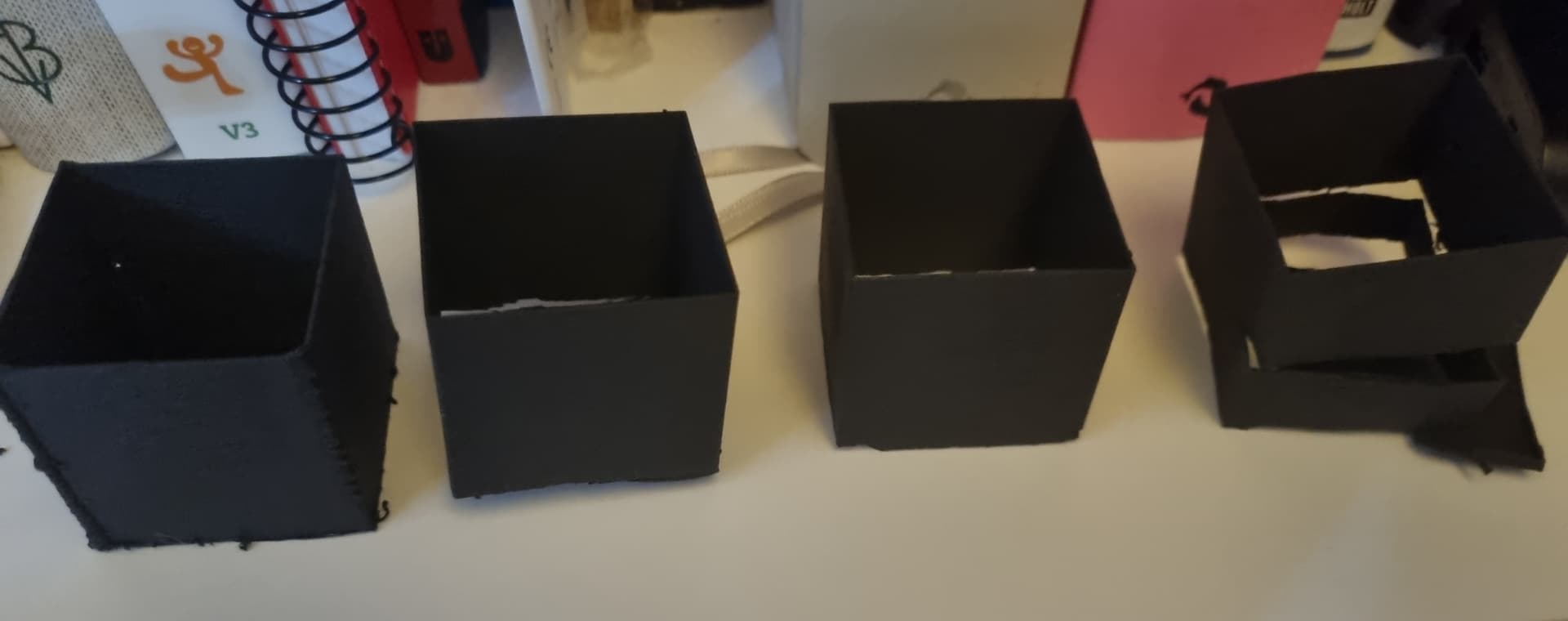

Thanks for all your comments. I’m managing to get this dialled in :crossed_fingers: . But it sticks like crazy to my Glacier plate, both with and without magigoo.
As you can see in the photo, when its foaming it tears coming off the bed and that’s even with a Scraper.

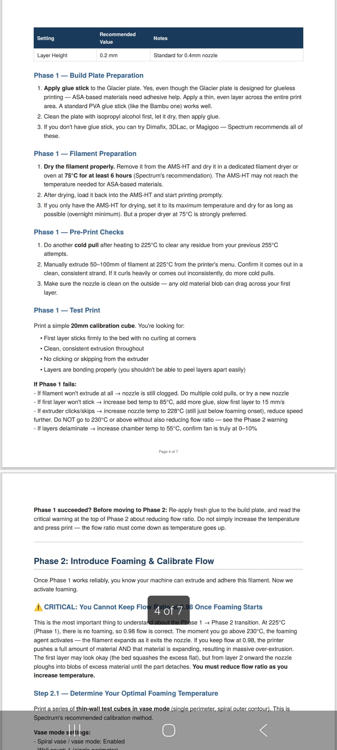

Yeah, I bought 4 rolls of ASA kevlar by accident, put the wrong one in my basket! :laughing: Dont know what to use it for so havent tried it yet. Id love to see a youtube comparison of its properties against CF, but couldnt find any. I also have their ASA glow and ASA fire retardant. Really looking forward to mixing ASA types in prints for different things.

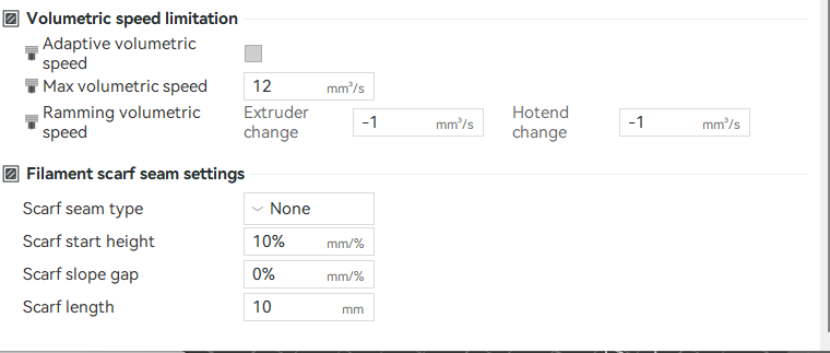

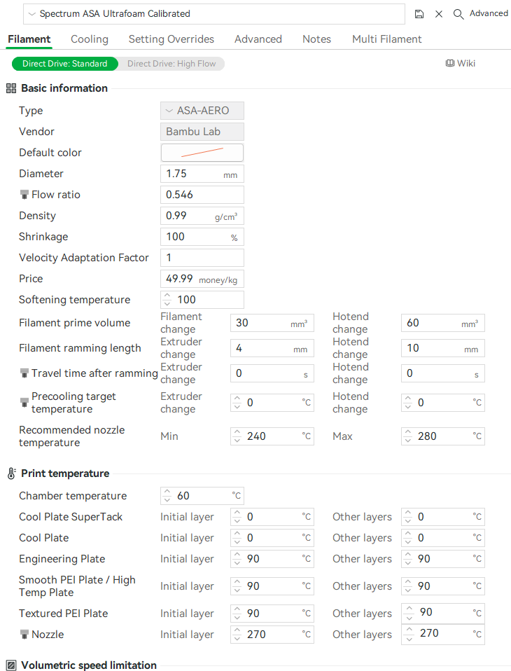

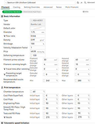

The plate is not damaged, all good, just super sticky. But im hoping to mix regular ASA275 and Ultrafoam together in the same print, so once I finish dialling this in fully, I might just have regular 275 touching the plate. The ultrafoam does need to be super-dry, I had already dried it, but put it on to dry a second time for 24hrs at 80 deg in the AMS-HT. That helped. My chamber is at 60deg and my bed is at 80deg.

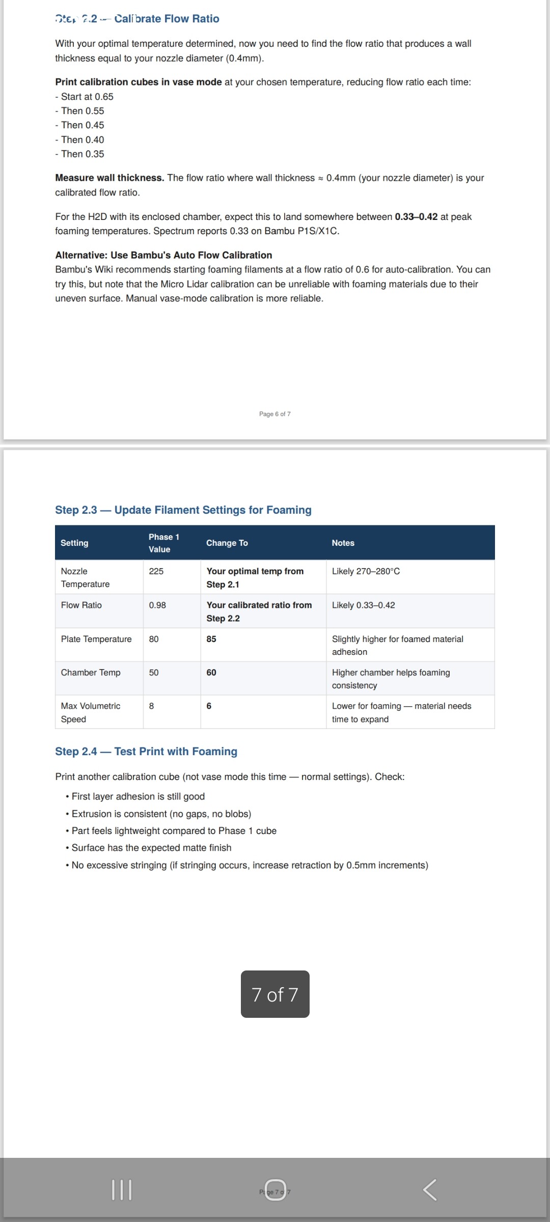

I generated the attached (Im not able to attach a document) with Claude. Might be useful to someone else.

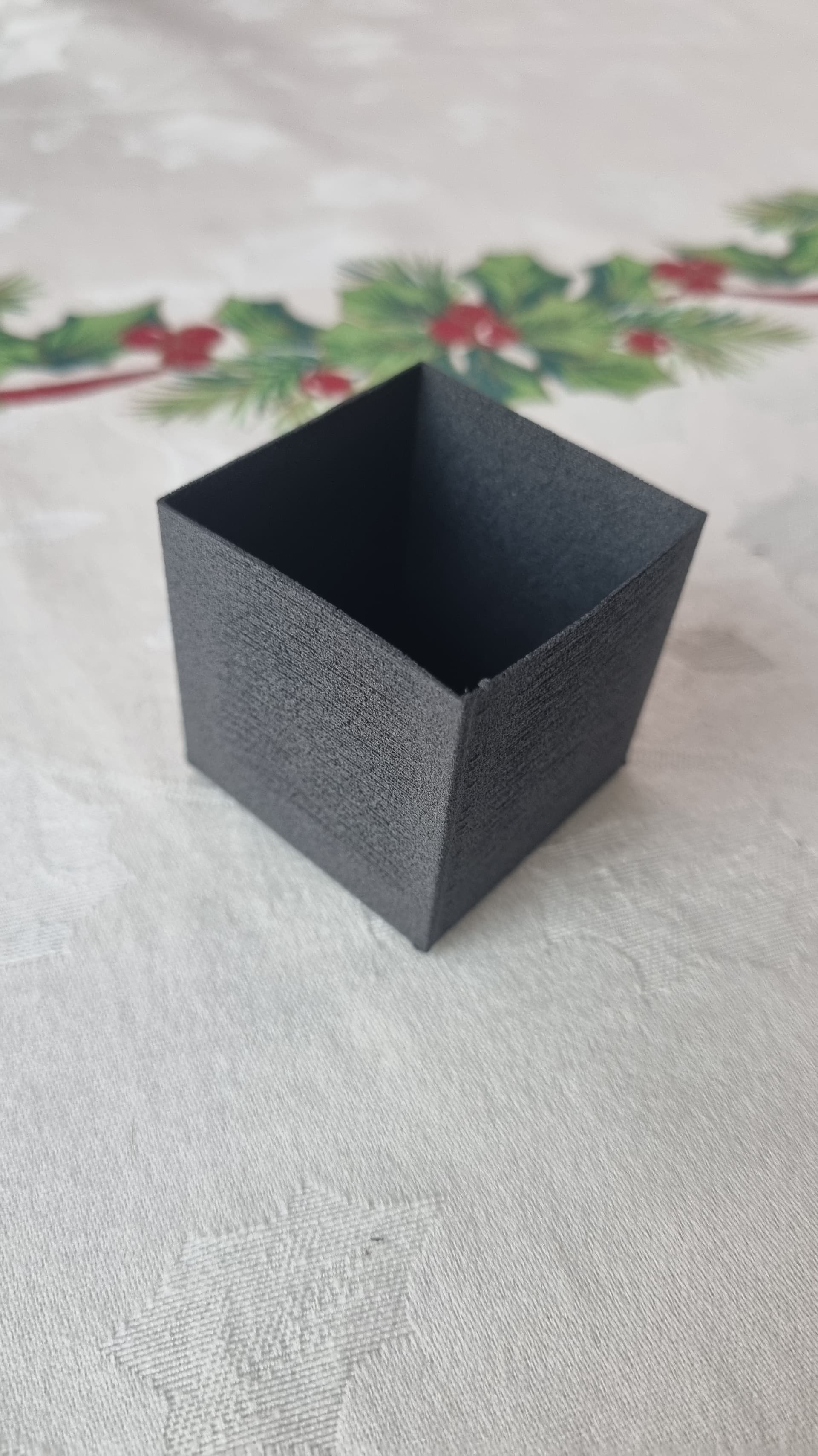

And again in case anyone needs this topic in the future. The bambu glue stick is better for this than the magigoo. Comes away cleanly with the bambu glue stick. This is at 270 degrees before optimising flow.
Looking good! So that’s near “max foam” for this stuff?
I’m also curious if you’ve tried it at minimum temps and if it really “behaves like standard ASA 275” like it claims on the tin (or Web site). I noticed you mentioned mixing it with regular ASA 275.

Yeah. They say 280 is max. I did a print at below foaming temp. It’s fine but definitely not the same as normal ASA. Different texture and in my very unscientific opinion, ‘feels’ weaker. :upside_down_face: They also seem to have a Medical ABS filament which they say is rated for food safety…:face_with_crossed_out_eyes:
