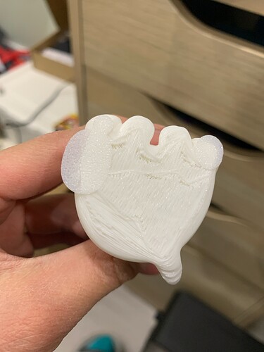

ive been printing like 50 hours, started like two weeks ago. ive been noticing this on a few of my prints, mostly on overhangs or support areas. ive been using pla basic , printing from bambu handy, so no slicer settings i think? it could be a moisture problem, as the pla spool is on my ams lite and not covered and i did hear some popping. anyways i just wanna know what it is
The model isn’t sitting flat on the bed. Only two corners are touching in the slicer.
yeah, i think i fixed it in the slicer, just started reprinting it
Move the print downwards by 2 or 3 layers in studio.
Lesson to always look at the slice before hitting print.
And if this is someone elses model, time for a 2 or 3 star rating.
