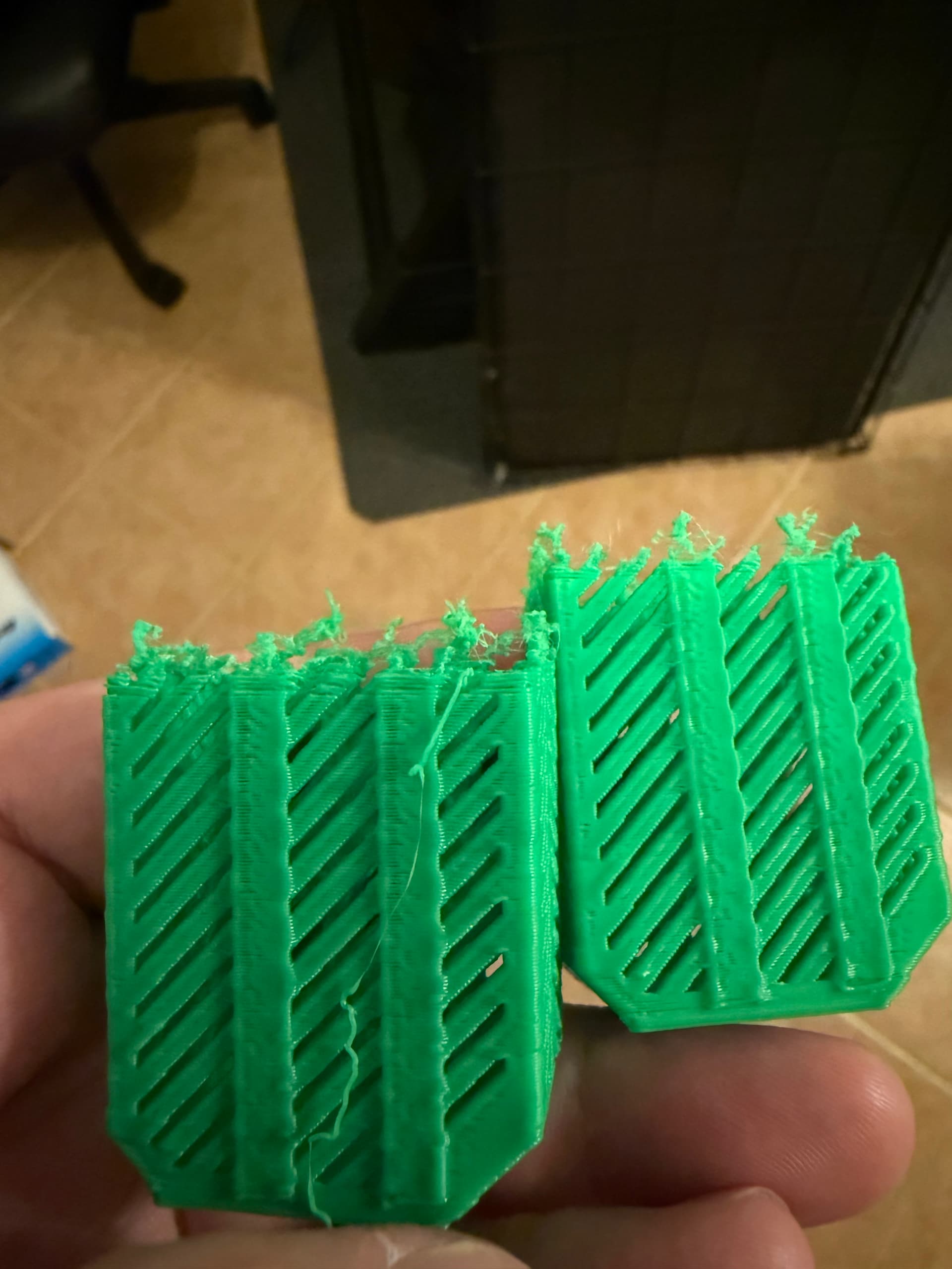

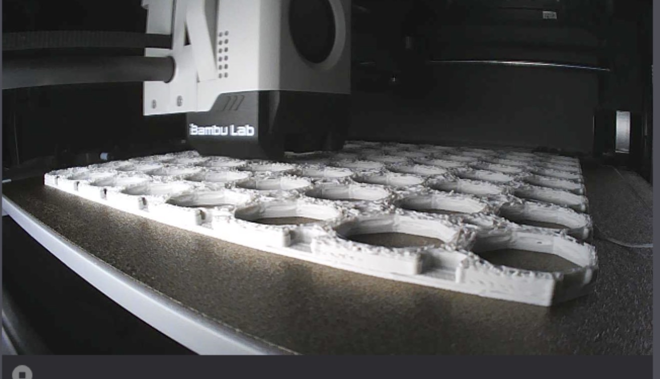

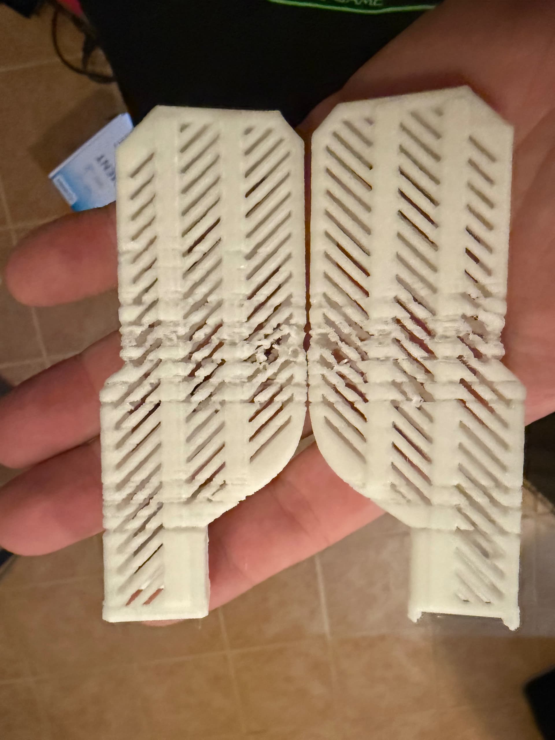

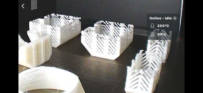

Hey all! Trying to print the dark horse ams drying system and I’ve tried with 2 different filaments (different brands too) and it fails around the same spot in the same way.
It kinda looks like when filament is too wet but since it failed around the same spot with two types it’s making me rethink that. What do you all think?
Picture isn’t that clear (try grabbing a picture with your phone camera and not the printer’s camera).
Maybe wet. Maybe an extruder/flow issue. Maybe temperature. Maybe a combination of things.
You need to provide more information.

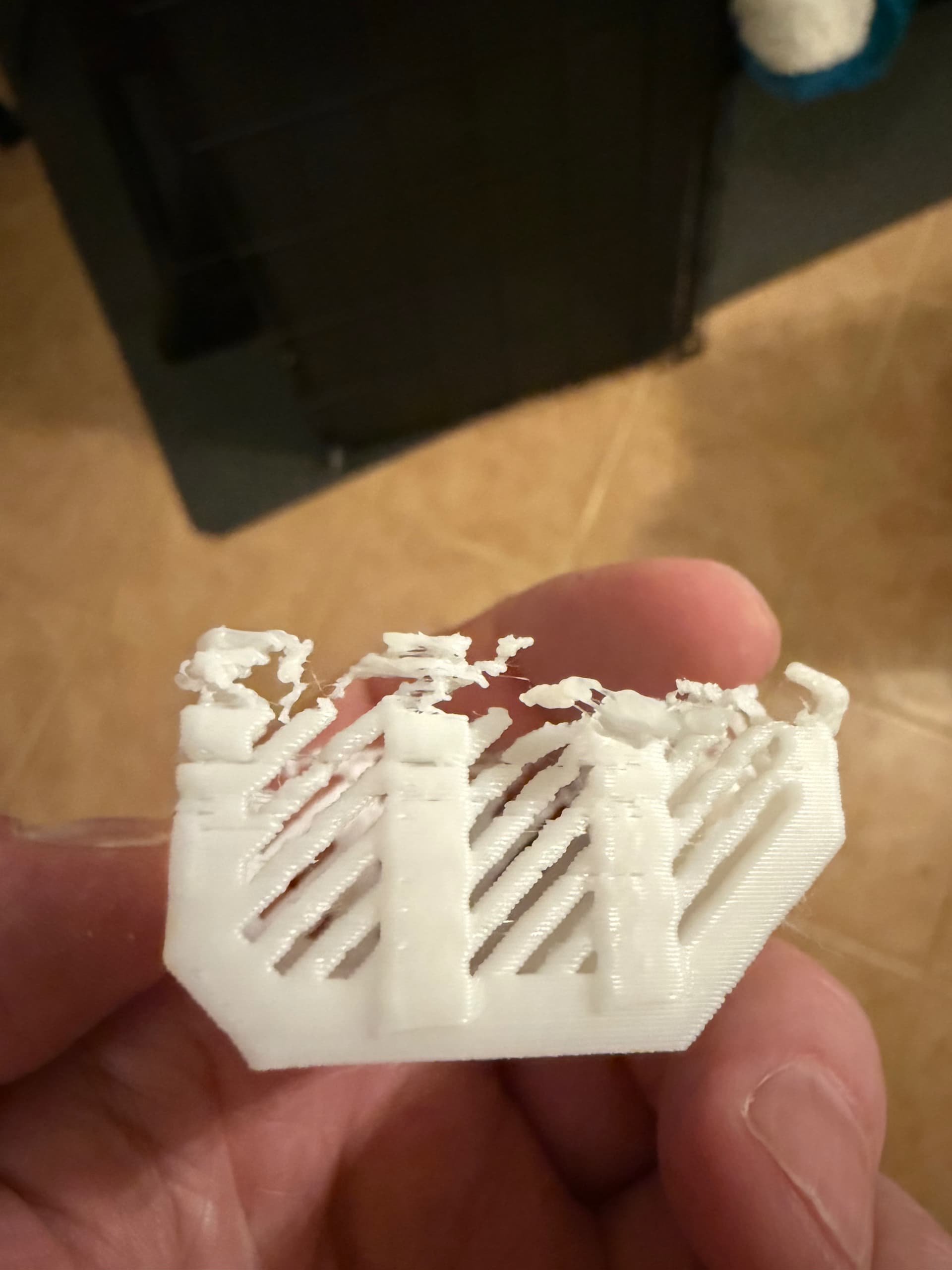

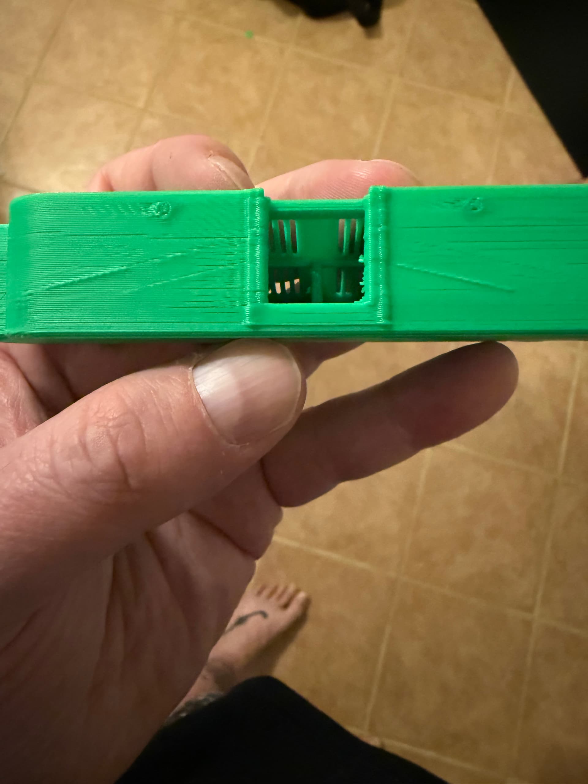

Here are some more pictures of the different attempts I made. I’m using a P1S with Inland PLA.

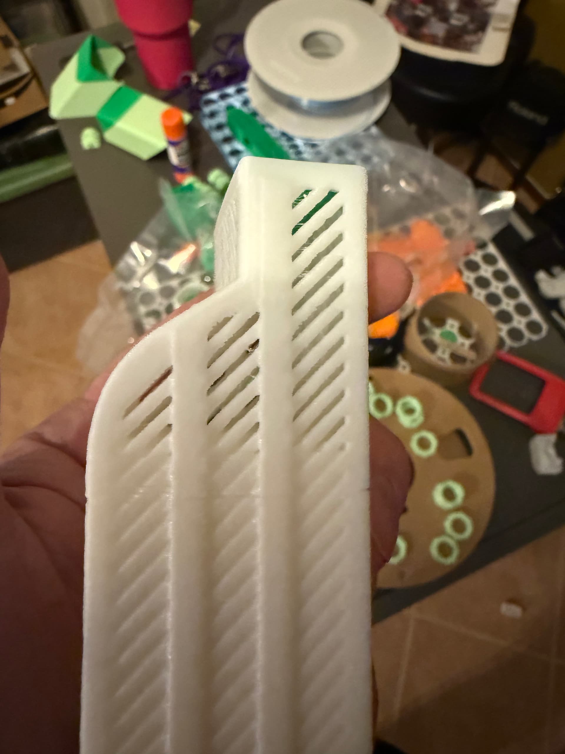

This one “succeeded” but I printed it by itself VS printing all the different pieces itself.
As far as slicer settings, I used the basic bambu studio “generic pla” settings. I did do the flow dynamic and flow rate calibrations after the green set messed up so bad (thinking it was a flow issue) but then tried again with the white and got the same issue.
With some of bambulabs filament I got similar results but with a different model (some multiboard pieces)

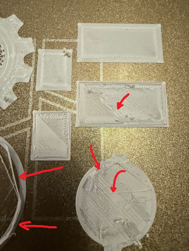

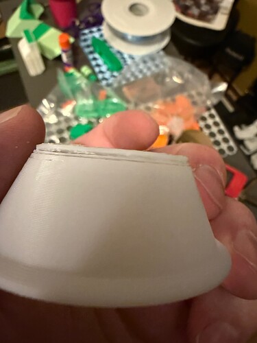

This is the 2nd or 3rd layer of another attempt just now.
Same filament as the last successful print. But this was part of me trying to do 4 parts at once instead of one at a time again
So I tried all of these, from what I can tell it’s not super wet and showing any of these signs!

Looks like it does! Just printed these two at the same and it got a lot higher than when I printed 5-6 pieces.
Based on the evidence and the fact that this is PLA, it seems unlikely that moisture is the primary issue.

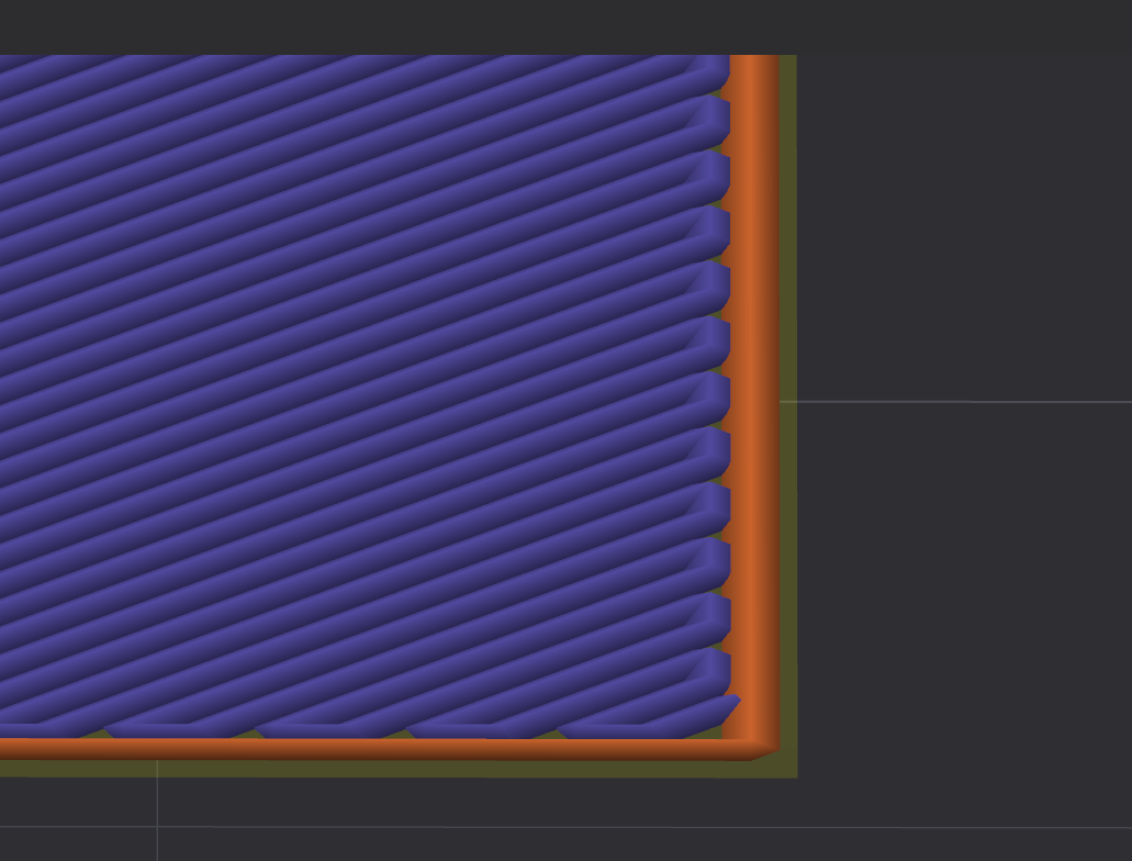

A good starting point is to stop diagnosing through the model and instead run a simple first-layer test.
A first layer test does not need to cover the entire build plate. The goal is simply to verify that the filament is extruding properly. If you have not done that before, here is a simple way to check it:

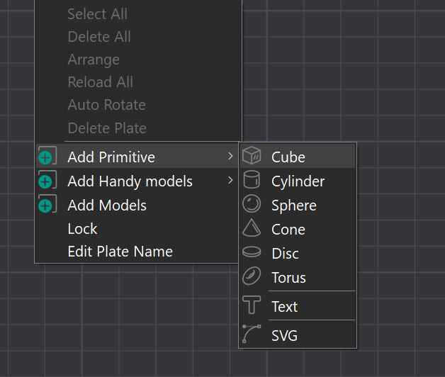

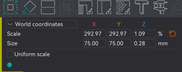

  1. Right-click on the build surface and select the cube primitive.
  2. Select the scale option, uncheck uniform scale, and set X and Y to somewhere between 75 mm and 100 mm. The important setting is Z, which should be set to a single layer. That is typically 0.48 mm for a 0.4 mm nozzle, but it will also depend on your global layer height setting and your nozzle width.
  3. Slice the model and zoom in to confirm that it produces exactly one layer. If you see no layers, the Z height is too small. If you see more than one layer, the Z height is too large. Adjust the model Z value until the slice shows exactly one layer.
This is a simple test that minimizes filament use and runs quickly, so you can experiment with other calibration settings efficiently.

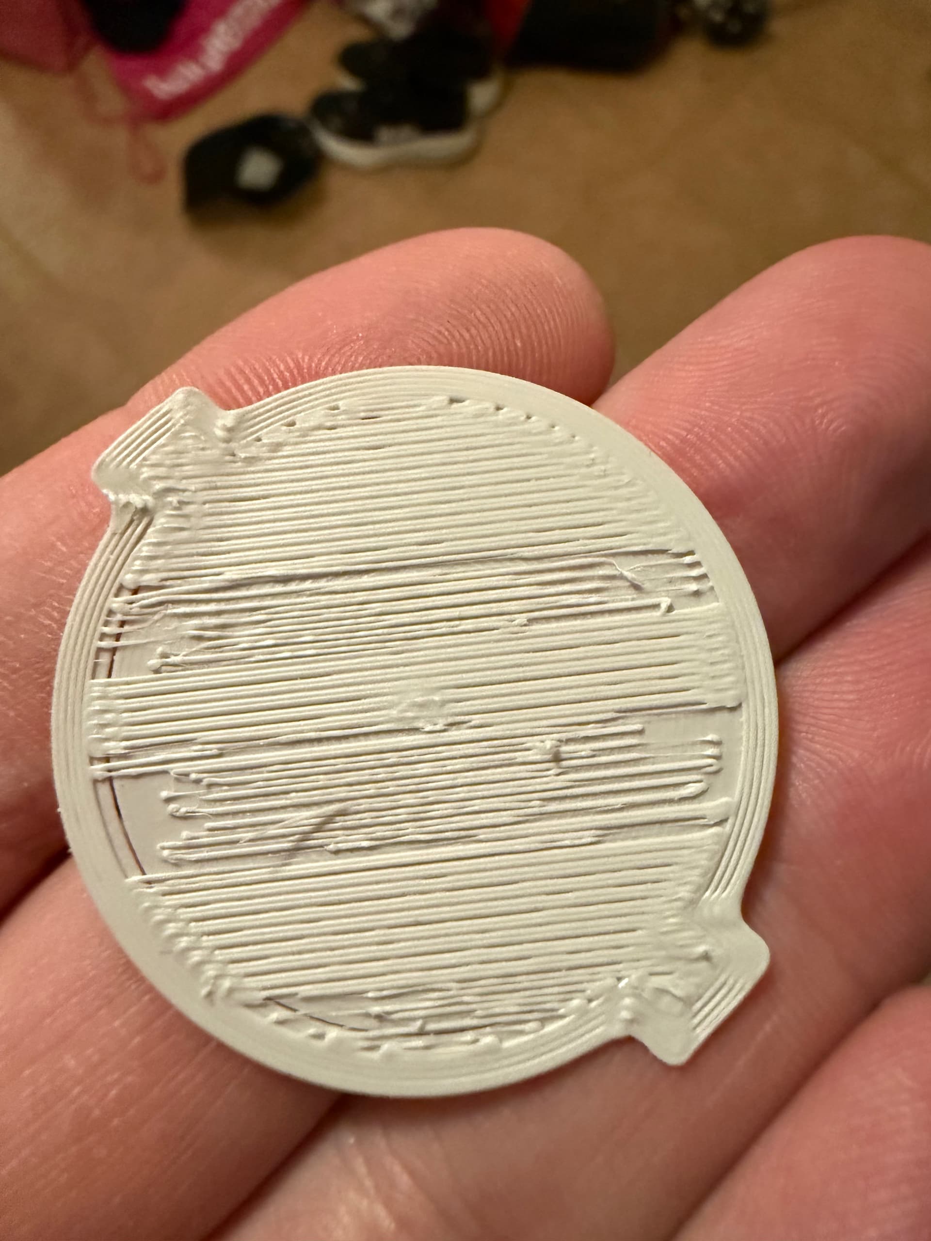

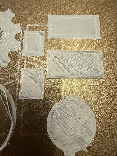

I stopped a print last night after the first few layers and could definitely see through it. I’ll post a picture in just a second.

You can see in this picture that the first layer definitely doesn’t squish all the way and there are some gaps, I think this print was stopped on layer 4-5?
Look like extruder problem to me.
Like, Some of the path is just oozing out instead of prime and extrude correctly.
Could be partial nozzle clog though
This says that the problem isn’t flow or filament wetness. The filament may be wet, but that doesn’t account for a repeatable issue where the printer appears to stop extruding properly after some amount of time.
Since the printer mechanics have no conception of time, the only explanation I can think of is that the problem is heat. The longer the printer runs, the hotter its various parts are getting, and the hotter things get the poorer the printer extrudes. Run a print with a single object on the build plate and it finishes quickly enough the problem doesn’t become severe. Run a print with a lot of objects and by the time it’s halfway through the print things have gotten hot enough for the issue to occur.
You haven’t said if your printer has an enclosure. If it does, try running the print with the door open and the lid off. If you’ve already tried this and it didn’t make a difference, I think you have an issue with the extruder stepper motor and/or drive circuit. But it might be mechanical. I’d take the extruder out and confirm the spring that pushes the drive wheels together hasn’t backed off, and that there is no plastic debris stuck to the drive mechanism.
Wet filament, by itself, doesn’t explain the symptoms you’ve described. Which is probably why it doesn’t matter which filament you use, it’s all failing the same way.
Also note, if PLA is really wet, it becomes brittle. If you can bend the filament and it doesn’t snap, it’s not super wet.
I agree. These photos are quite indicative of a flow rate issue that is more likely tied to the filament path binding or some kind of mechanical interference.
With this new evidence, I would check the following in order of easiest to more most work:
  1. Verify that the PTFE tubes are not kinking or binding.
  • As a simple test, you could unspool a 0.5-1 meter length of filament, and disconnect the PTFE tube and then hand-feed the filament directly into the extruder while performing a small 75x75*0.28mm cube test. This should only take 3-5 minutes.
  1. If an AMS is in use, eliminate that from the process temporarily and use the single external spool.
  2. Tear down the extruder and verify that there is no mechanical damage to the gears or debris caught inside the mechanism.
