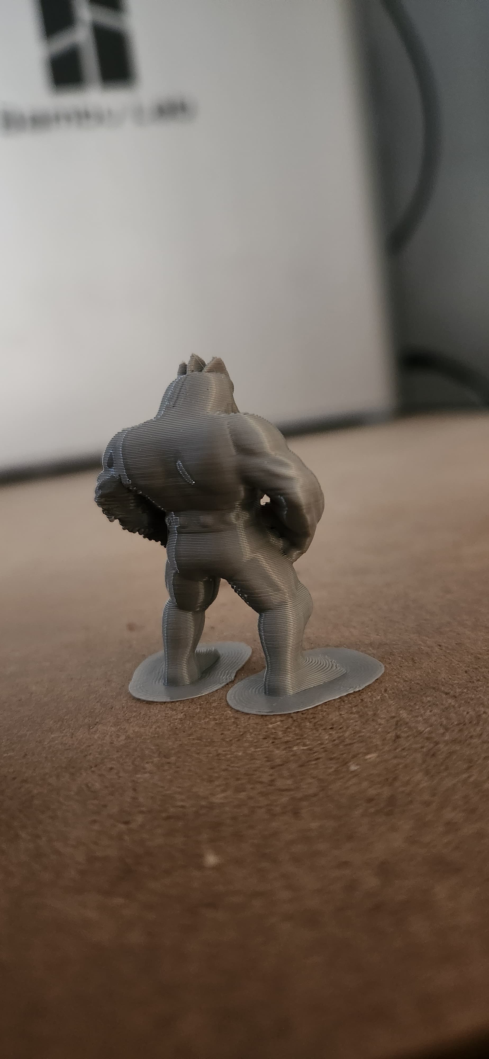

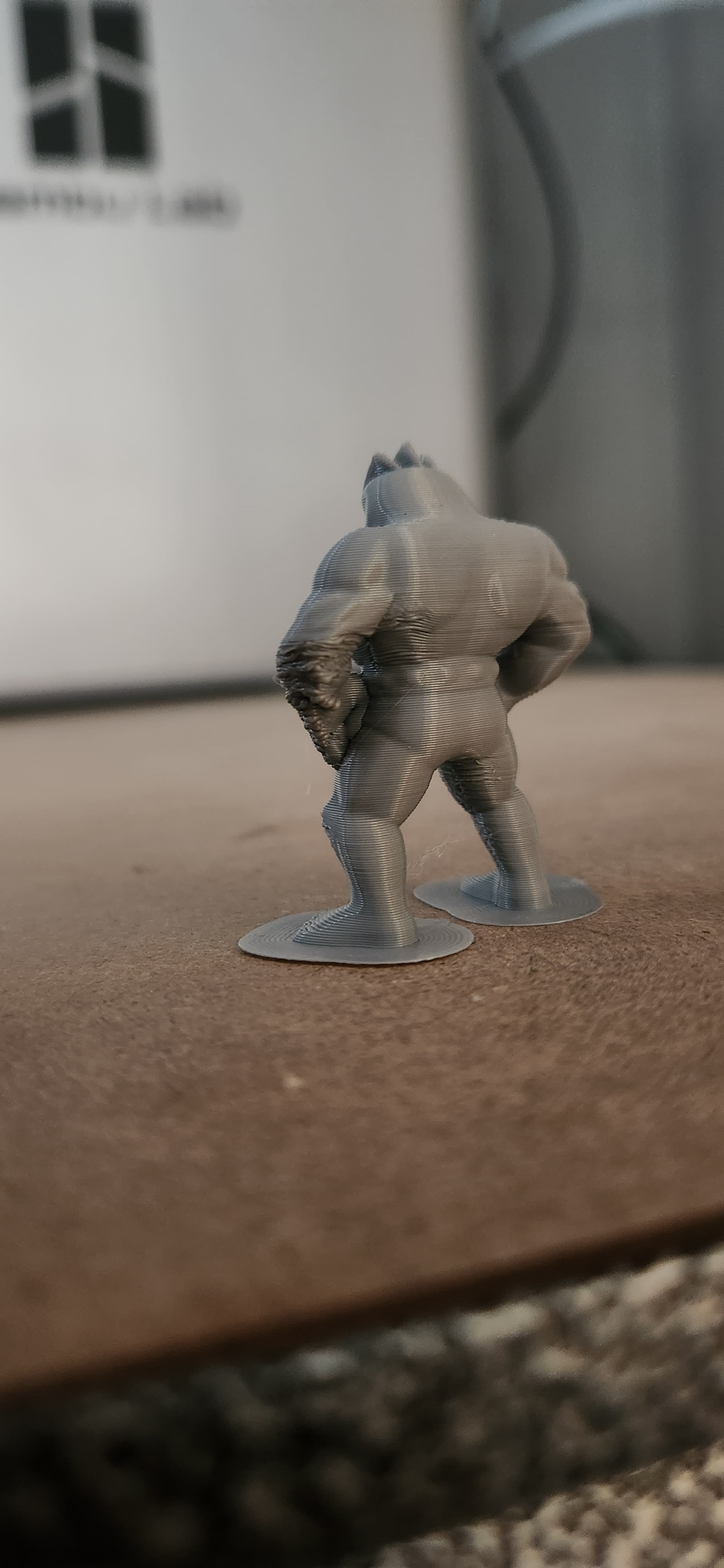

Has anyone encountered an issue like this on thier X1C before? Where it looks like I am having some over extrusion issues, but only on the right side of the print (notice how the right arm of the model looks to have extrusion isses while the left one does not). I have performed full maintenance (including nozzle change) but the result is the same. My machine has over 5000 hours on it. There is some slight freying on the x-y belt but this belt is in better condition than my other X1C which does not experience the same issue. Hopefully someone has an idea of what this issue could be.
Is it in the path of the AUX fan? Which side faces it?
Is it the side opposite of the AUX fan. This issue does not occur on my other X1C while using the same settings, filament, and conditions.
