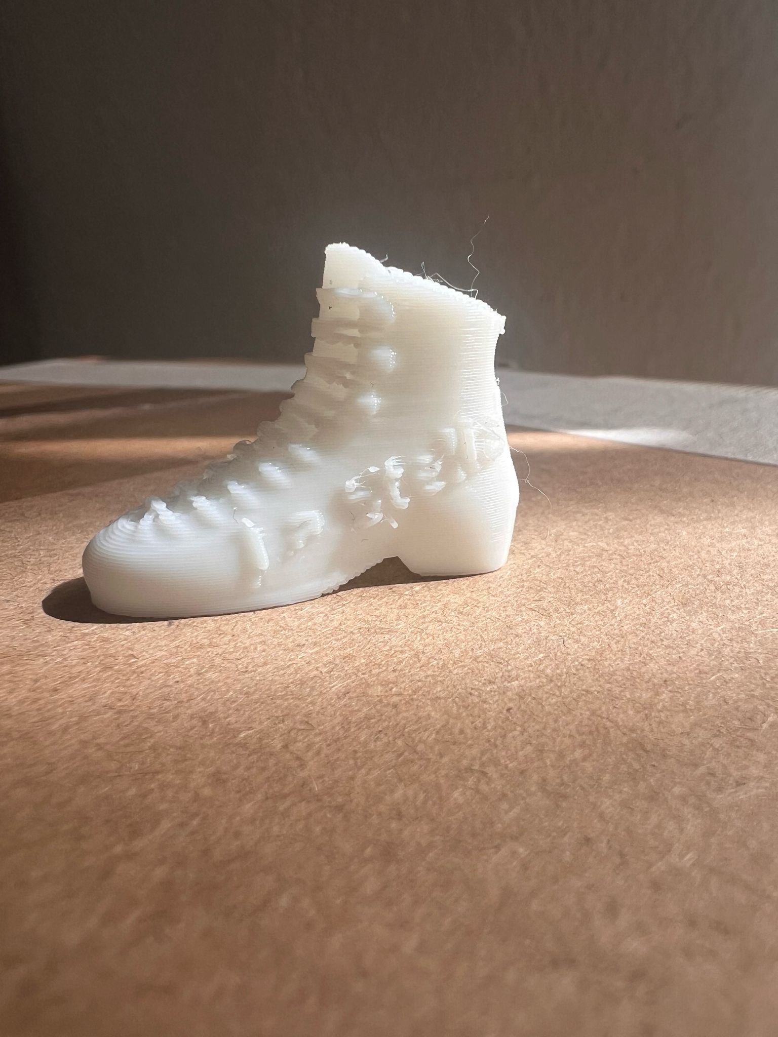

I have some problems with this component (see photo below), I can’t get a clear and defined writing. I’m using Esun pla+ PLA prints directly from the dryer heated to 50°C which up until now with medium/large sized pieces has never given me a problem.
what i m doing wrong?? i m doing by best to improve but thi time i m going crazy
Well what’s the size of the object? How does it show up in the preview? Are you using a 0.2 nozzle or 0.4? Arachne enabled?
Hi thanks for the reply!!
ok so the nozzle is 0,4mm shoe dimension is 32x24x12mm

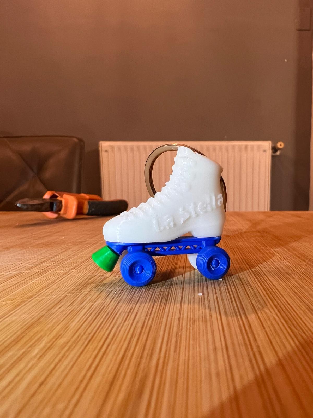

and yes in the slicer the text is good, i’v done multiple test with single object and the result is far better in the picture below you ll see the difference (same material and same Slice profile but, only 1 piece)
The object is very small to print with a 0.4 nozzle, and possibly when printing more than one, the nozzle does retraction near the text and ruins it. I think with arachne activated and the nozzle width set to 0.36 you should get better results, also check if the seams are on the text and move them away.
Thanks so muh for the reply, i ve already set the printer changed che parameters than you suggest lets see tomorrow how it work, i set the front door wide open looking the part in the front area they look nicer than the other in the back plate
i m removing the bed plate te prin are amazing thanks soo much for you re help it solve completely the problem
