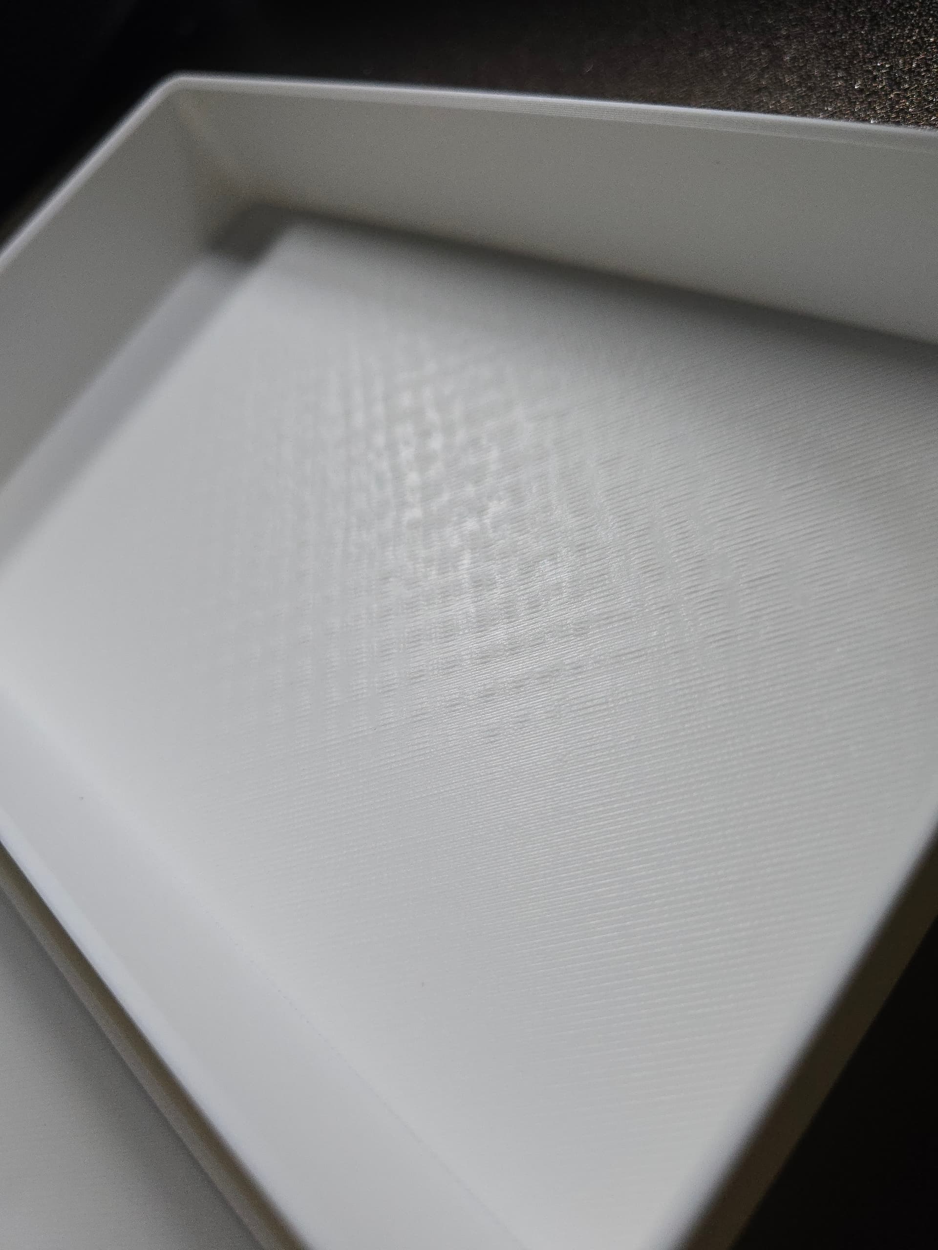

I just received my new BambuLab H2S, but I’m having serious first-layer problems and would like to know if anyone else has experienced something similar.
I’m not new to 3D printing — I already own a BambuLab P1S and an A1, plus printers from other brands, and I’ve never had any issues like this before. Both my A1 and P1S deliver perfect first layers every time.
After unboxing the H2S, I placed it on a perfectly stable surface, performed all calibrations, including the one with the Visual Encoder, and also followed every single step from BambuLab’s official wiki guide for first-layer optimization — but nothing has improved.
When printing a simple toolbox box using BambuLab PLA Matte White, the front area of the plate prints beautifully, smooth and clean — but the rear area becomes wavy, uneven, and full of defects, as if the bed were slightly warped or uneven in the middle.
I ran several test prints, even cutting just the bottom section of the model to isolate the problem, but the result is always the same — perfect on one side, terrible on the other.
Honestly, I’m quite surprised that a printer packed with so many sensors and smart features can’t manage to produce a consistent first layer.
I’ve already contacted BambuLab support, but I’d love to hear from other H2S owners if you’ve seen the same issue or found a reliable fix.
Thanks in advance! :pray:

I have the same issue with my H2S arrived last week and already did endless calibration runs, screw adjustments, full bed tramming procedure but nothing helped. I do get the wavy patterns as seen on your images on the first layer (with Bambu PLA and other vendors) but not always on the same spot.

pics 2 and 3 It is just not enough top layers imo
about the others I would bet on a filthy plate first and after I would start to check and rise the Z offset of the given plate beacuse those waves remember me a low nozzle

just to clarify — in images 2 and 3 there are two boxes printed at the same time, on the same plate, with identical thickness and settings.
So can you explain why one came out absolutely perfect and the other a mess?
Same print, same filament, same moment — only difference is the area of the bed.

the lid with the text seems thinner and i don’t see any sagging and i see the huge logo that can offer support due to its layer’s penetration.
other part has just infill and not enough top layers, you can see the layers sagging into the infill’s geometry. for this just add enough top layers.

just to clarify — both the box and the lid have exactly the same wall thickness (1.5 mm) and were printed together in the same job.
The profile is the standard 0.16 mm layer height, with a 0.2 mm first layer, and the model is completely solid (no infill at all).
So there’s no difference in geometry, thickness, or slicing setup — the only variable is where they were positioned on the bed.
understood. very weird. zooming on it seems the lines have an intermittent extrusion. at this point is that so called lemon…

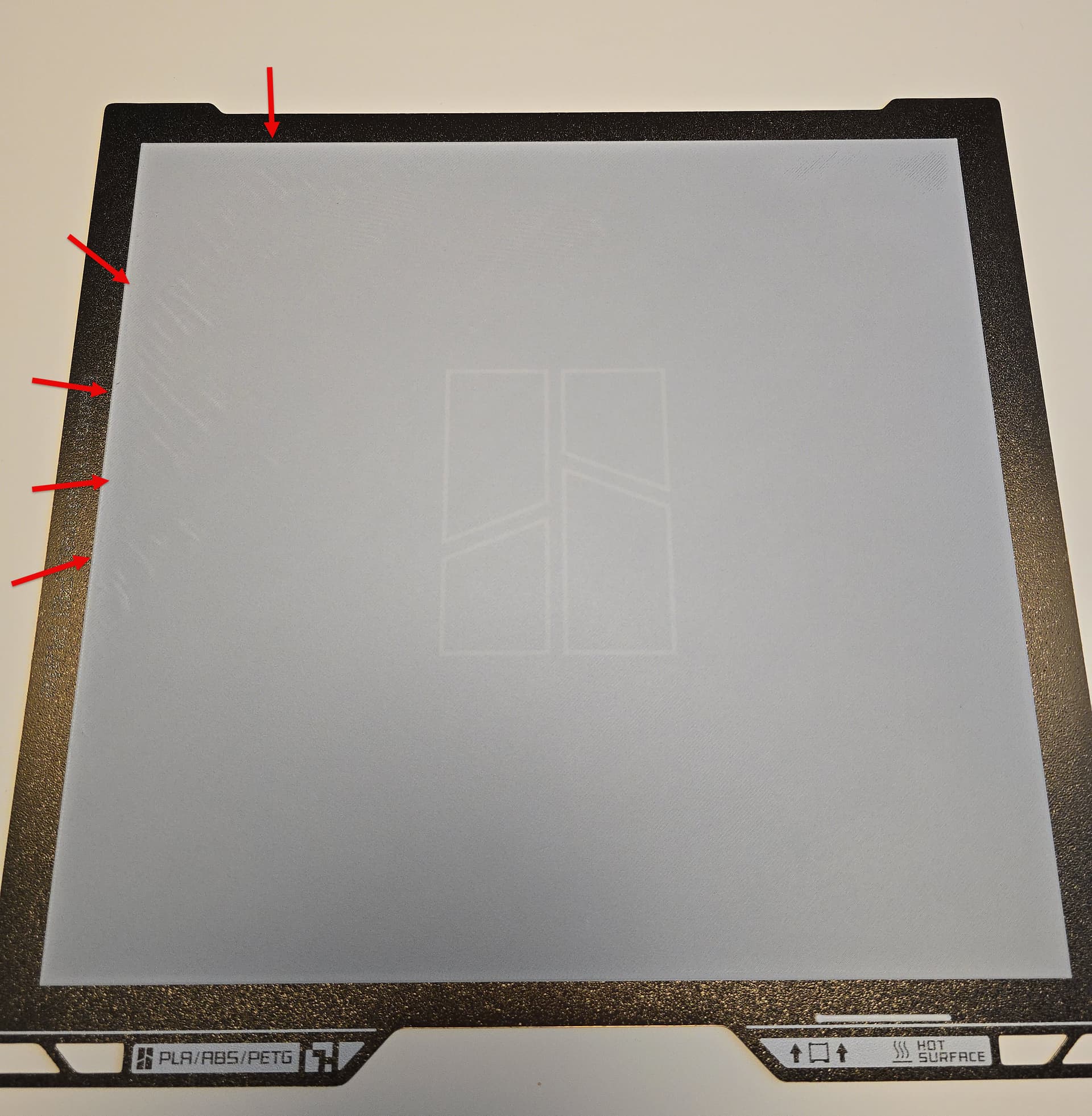

Update:
I finally managed to fix the issue — it turned out to be a mechanical problem.
The bed was slightly tilted from the factory, so all the calibrations and tests in the world couldn’t fix it.
I followed the manual bed leveling procedure (the “H2S Bed Tramming” guide) and did an old-school mechanical calibration.
Now the bed is perfectly level — I’d say about 98% spot on, which for me is more than good enough.
I’m not a calibration nerd; I just want to design and print my stuff, and now it works exactly as I need.
For anyone facing the same issue, the guide is available here:
:point_right: H2S Bed Tramming | Bambu Lab Wiki
The print shown was made before I gave the rear-left screw another half turn.
That corner was still showing a very light unevenness, so I decided to tweak it a bit more.
I haven’t reprinted a full first layer yet, but I’m pretty sure it will be even better now.
Considering that before the manual calibration the entire back half of the plate was completely ruined, the improvement is huge.
At this point, I’d say my bed is about as perfect as it gets!
(Photo shows the area that needed the last small adjustment)
