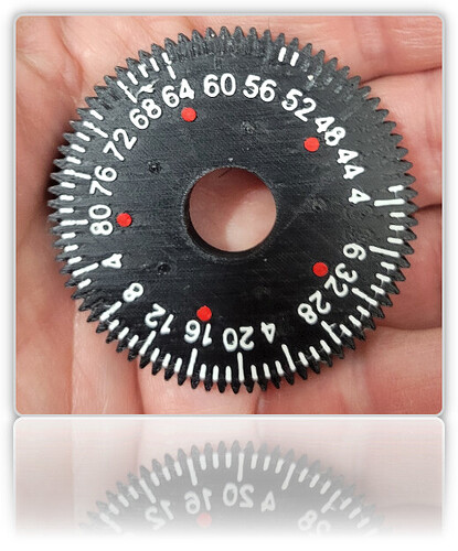

Issue with color change, might be ironing?
Studio Ver 2.3.1.51, P1S w/ AMS, .2 mm nozzle, Generic PLA
More of an observation than a complaint.
I noticed an issue I was having when I was using color painting and adhesion. The numbers and lines are .75mm high. I was setting the height range to .70mm and trying to capture as much of the rise in white, red, green per item. As you can see, they were coming off. I have surface ironing on, and that ‘might’ be related.
My solution was to turn height range to .5 mm so that the black was the first part of the raised surfaces, then the merge.
It worked for the first batch I did, but then it didn’t, hence the change in where it transitioned to white. Yes, white was right out of a day in the dryer.
