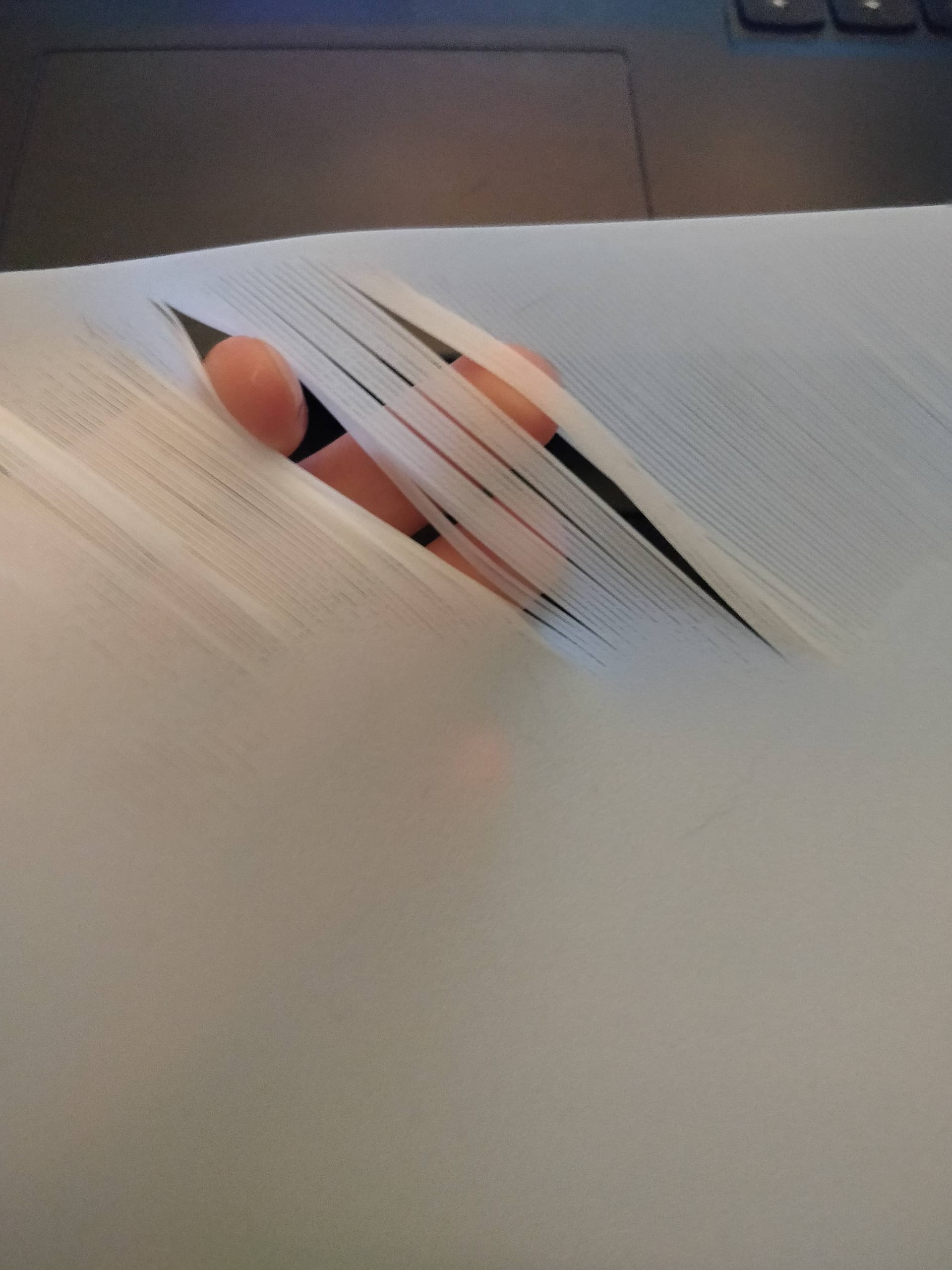

Hello, I recently got a bambu A1 printer and have been printing non stop. Had a few times where the adhesion was bad and cleaned it up and reprinted and it was fine. But recently I thought to do a first layer test of my two build plates.
One was relatively fines but had a few of the same issues and I’m not sure if this is an adhesion problem or a different one. I tested it both right after each other with the basic pla white filament. One build plate is a normal textured plate the other was a smooth plate but using the textured side of it.
Now the issues is this, the lines doesn’t seem to connect on one side of my build plate. On the other one I had that in very small places on the sides and was fine with it but this was almost 1/4 of the build plate.
Anyone got a clue of what the issue here is or is this adhesion as well?
Have you tried increasing the “Initial Layer” plate and/or nozzle temps? Maybe 5 or 10 degrees. The temps are in the filament settings. You may try slowing down the “Initial Layer” speed also. I do all three if the 1st layer is poor.
I’ll test the initial layer plate tomorrow thanks. For the Filament I’m using the bambu one with their setting.
