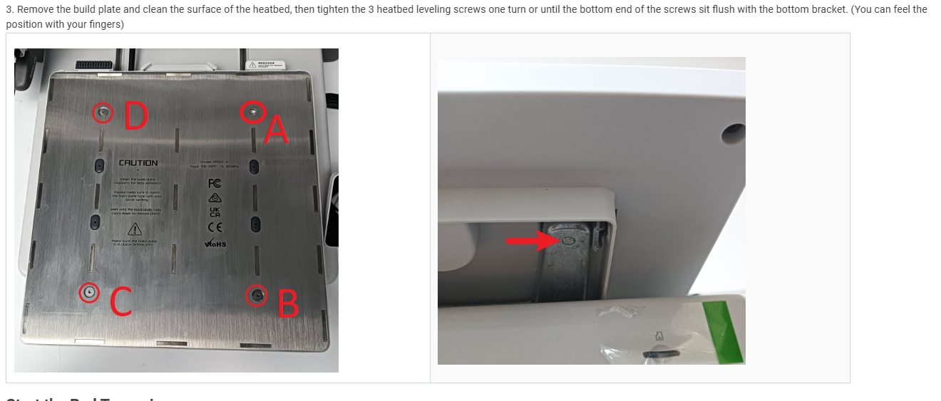

According the the wiki, you’re supposed to tighten the three screws until they are flush with the bottom bracket. I’d say “flush” is relative and added to the fact that there are also slight machining/assembling differences, the starting points when running the gcode will always vary a bit. They should all be higher/lower than point A however, otherwise leveling would be truly difficult.
Let’s say point A = 0, and you end up with 0,1, 0,25 and 0.15 for b,c and d respectively. The gcode starts at point C, and you adjust down approximately 1mm(piece of paper?) and you end up at 0,15. Wouldn’t you then calibrate based on a slight offset from the fixed corner?
Why doesn’t the gcode ever stop at point A, to give you a reference? I don’t know if there’s anything I’m missing, but I’m getting better results by manually leveling it with a water level, and running the 7 minute level calibration afterwards.
I’d highly appreciate any input! I’m using the bambu a1.

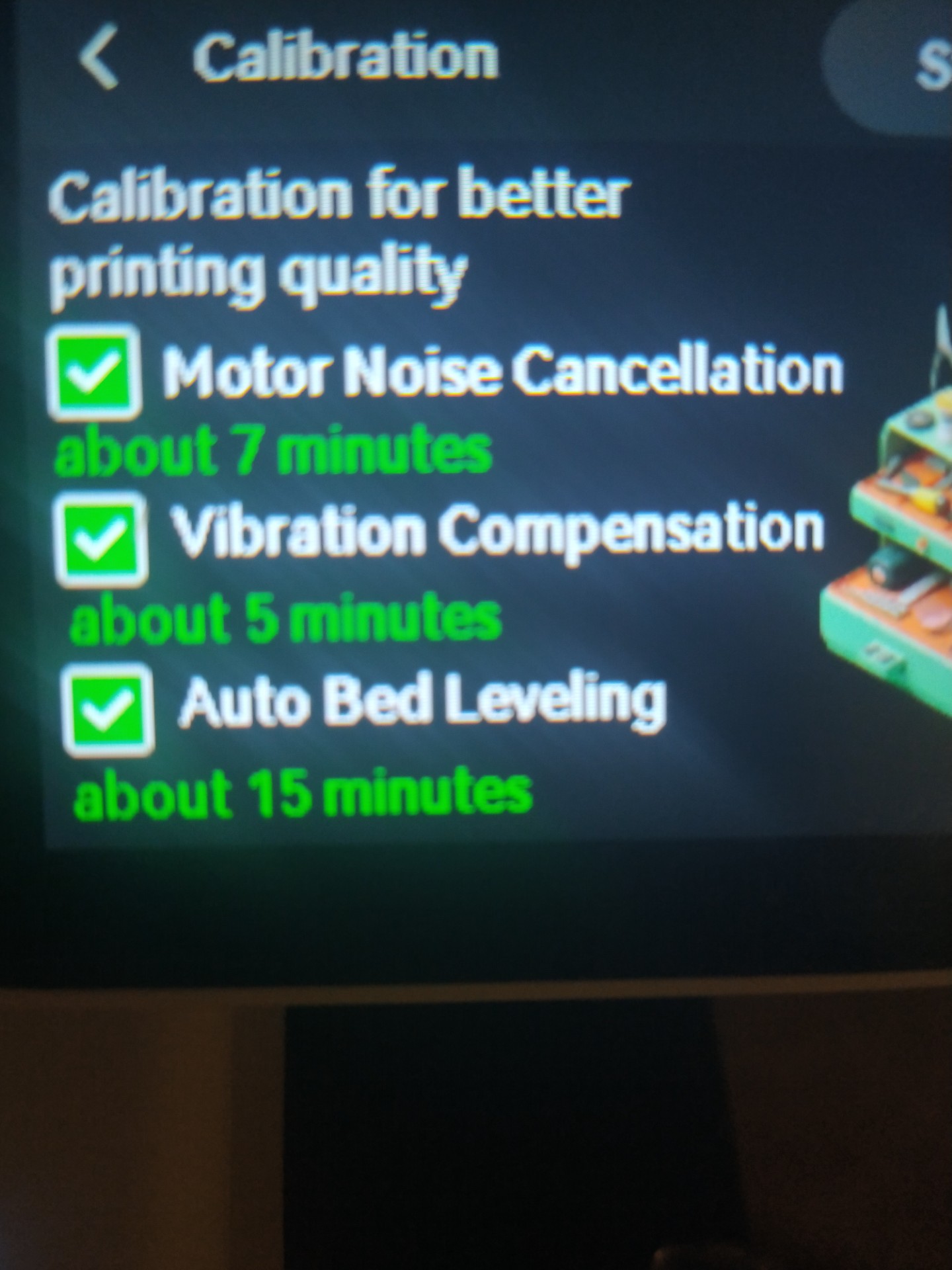

Did you try bed levelling from your A1 ?
maintenance / calibration / bed levelling 15 min procedure
Yeah, and it works pretty good now. But since I should be able to do it following the tramming video on the wiki, I guess I must have been doing something wrong.

After I disassemble a heatbed, and before I saw the wiki g-code, (with power off) I just manually lowered the nozzle to the static corner and then manually moved things around to do the other corners. I did this like 3 times because moving one corner can affect the others. It worked fine.
I have modified the g-code in the same way to start on the fixed corner.

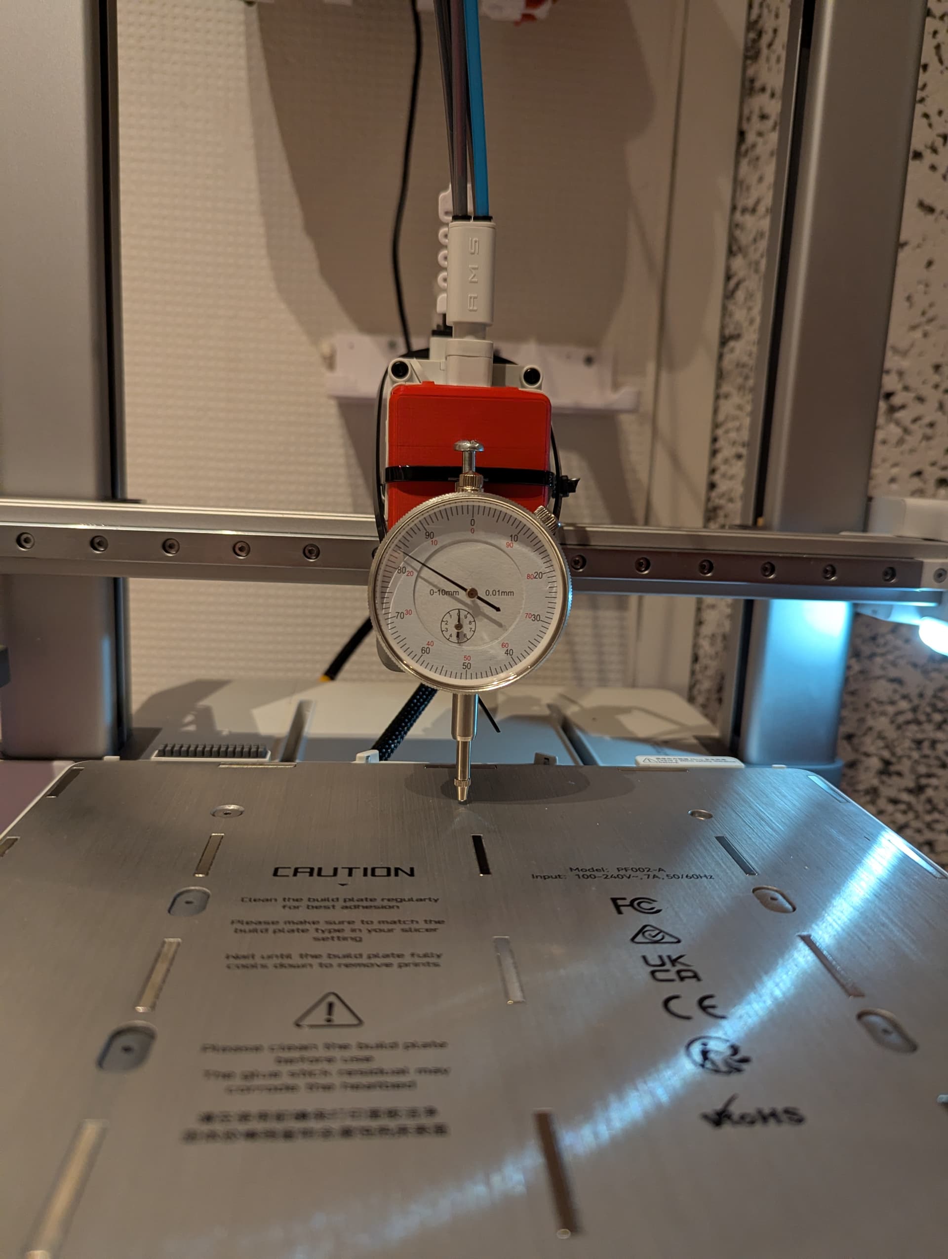

You will need a dial gauge and a magnetic base or some other secure attachment to the x rail or head.
  1. Home machine and move Z to a height you can set your gauge on the raw bed (home with plate on, remove after) Don’t hit the home button once gauge is on or you can break things. Home is nice way to lock the axis from drifting. You can also lock the axis with braces or some other gizmo.
  2. Loosen the securing bolts on the screen side like the wiki shows.
  3. Bottom out all 3 screws. Then loosen by 7 turns each.
  4. Set your dial gauge to 0 on the by the pocket with out the screw.
  5. Move the bed and see how far each pocket is off.
  6. If it is more the .040"/1mm… Do the following; if not skip to 9.
  7. Loosen your Z belt.
  8. Jump the cogs for right and left to get it under .020"/.5mm.
  9. Tighten belt back up. (make sure belt is sitting in cogs.
  10. Re-zero your dial on the screw-less pocket.
  11. Move to each pocket, adjust the screw until its “0” on the gauge.
  12. Do this 3 to 4 times (should be within .004"/.1mm (can usually get it much tighter).
  13. Lock screws.
  14. Remove gauge and put plate back on.
  15. Re-home machine.
  16. Do the auto bed level under the calibration menu.
This is the only true method from tramming and will reduce or eliminate the mesh warping that “auto leveling” would create with a bed out of tram. Also “almost touching” is never an acceptable level for tramming.
If you can’t use the dial gauge method. Yet you know how to lash valves; just use your .015"/.4mm feeler gauge and do it just like valves or piston ring gaps. That method you will have to home the tool head on the raw bed not the plate.Tolerance will be a little more then a gauge (if you can do the gauge correctly), but still far superior to the wiki way.
A little update on the tramming. I did a last try with the gcode the other day, and managed to at least print a pretty clean 0.2mm full surface. Yesterday I got an indicator gauge and I managed to get the static corner and all adjustable corners to within ~0.01 (measured right next to the adjustment screws)
However, there are larger discrepancies, especially at the outmost edges. Did a quick survey before bed yesterday, and from the lowest to the highest point there was approximately 0.5mm difference, with a maximum deviation of ~0.3mm from “0”(fixed corner).
