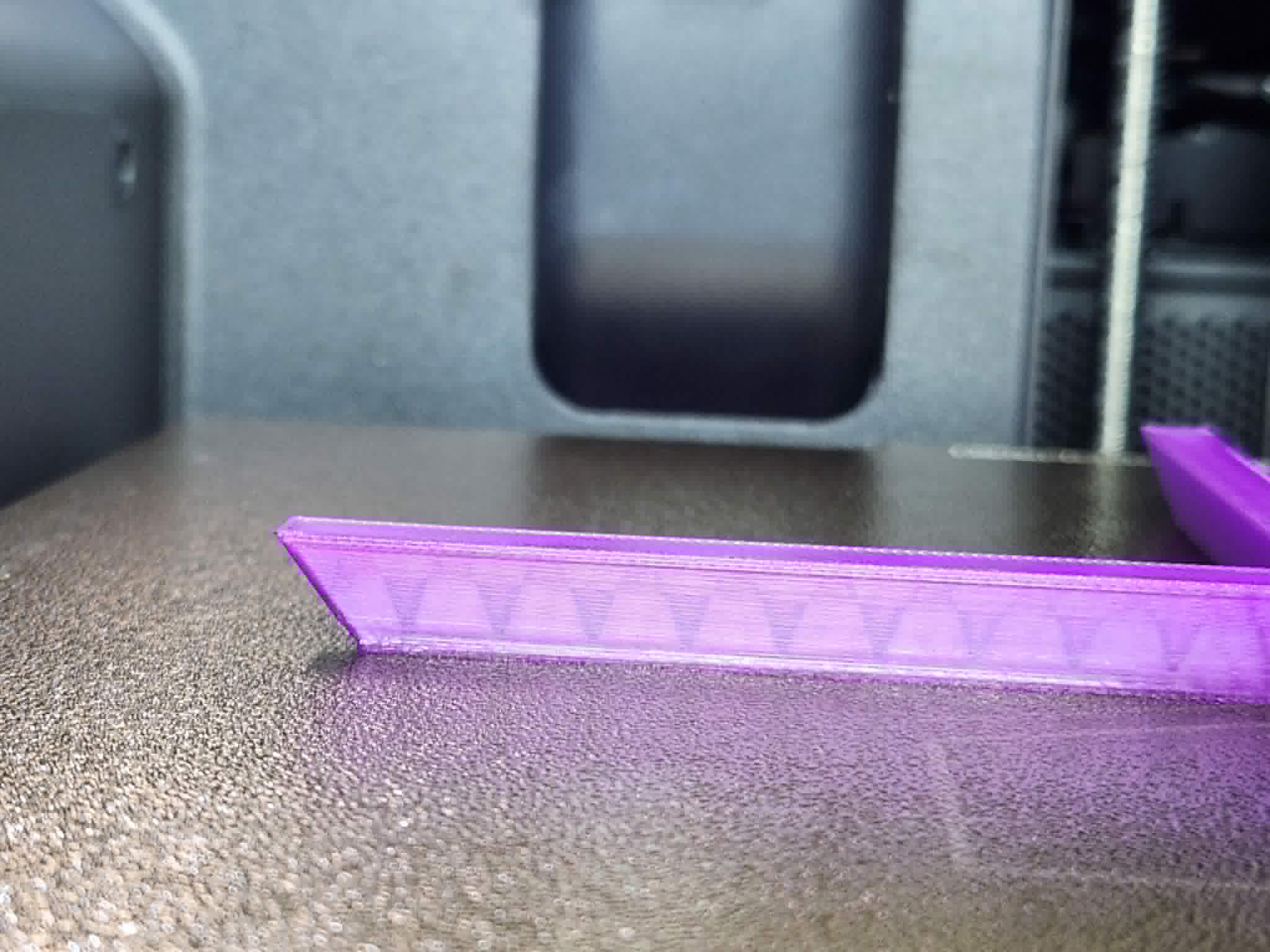

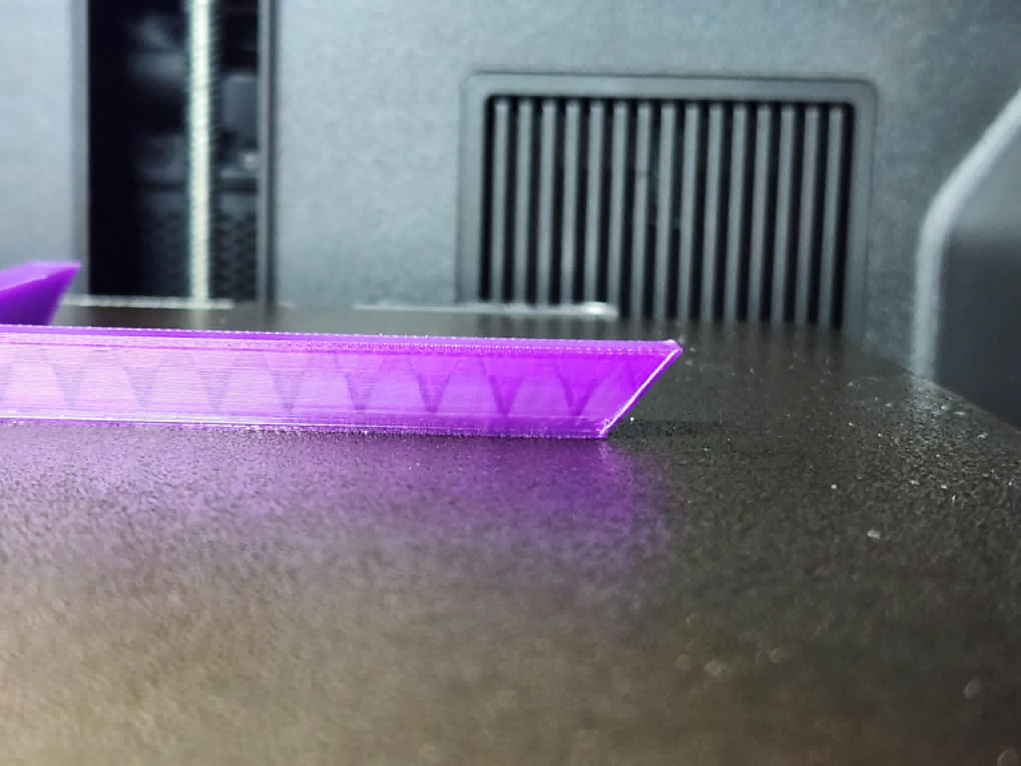

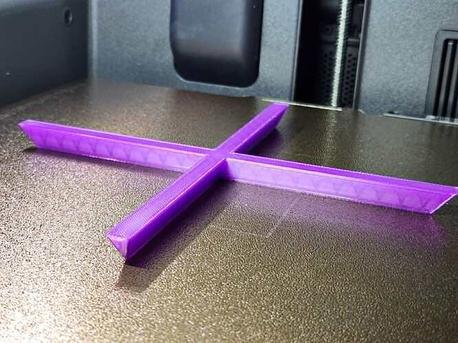

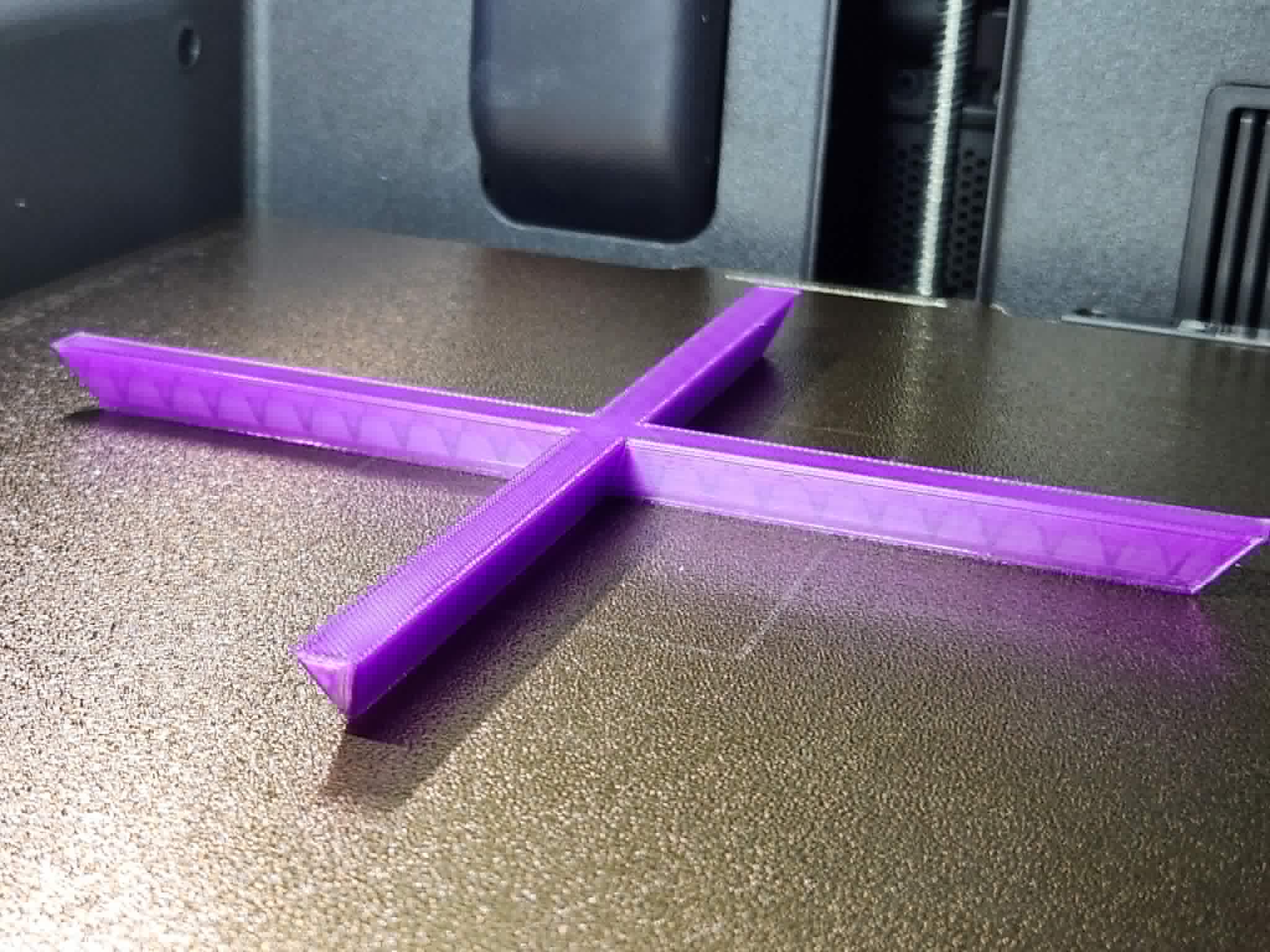

Have had some bed adhesion issues, mainly with petg but a little with pla, but to be fair its a textured bed with no 3dlac on it. I’ve got the engineering sheet coming as I prefer smooth and want to print a little PA-CF. Did raise the bed temp by 10 for the petg and installed some fan deflectors for the side fan vents. I then printed a test which I’ve always used on my prusas and had only the tiniest of lift on one of the 4 sides. That’s pretty good. Give me the engineering sheet and a spritz of 3dlack and it’s going to stick like tree sap.
