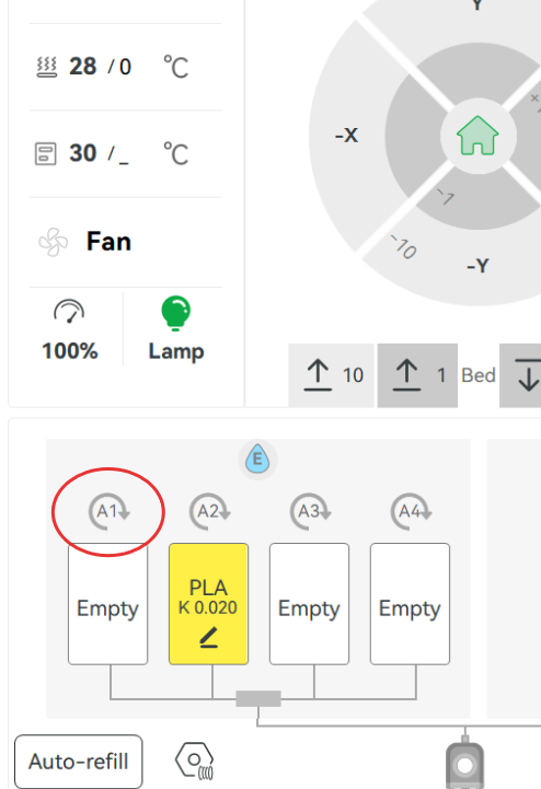

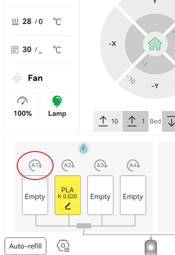

Handy App:
Edit: The Bambu Slicer does have the option to re-read the spool.

You can still re-read the spool (through the bambu slicer or the handy app) to see if you have an actual issue, if you wanted to. Although I’m more inclined to think that when you replaced the 4 spools, there wasn’t enough time given after inserting the first spool filament into the AMS feeder tab, as I mentioned previously, if you insert all 4 spool filaments into their feeder tabs one after the other, it will only read 1 of the 4 spools (the first one you inserted).
I think I will try restarting the printer and If I am not mistaken, it should read all the spools. I not sure how I can make it reread the spool. How is this accomplished with Bambu Studio?

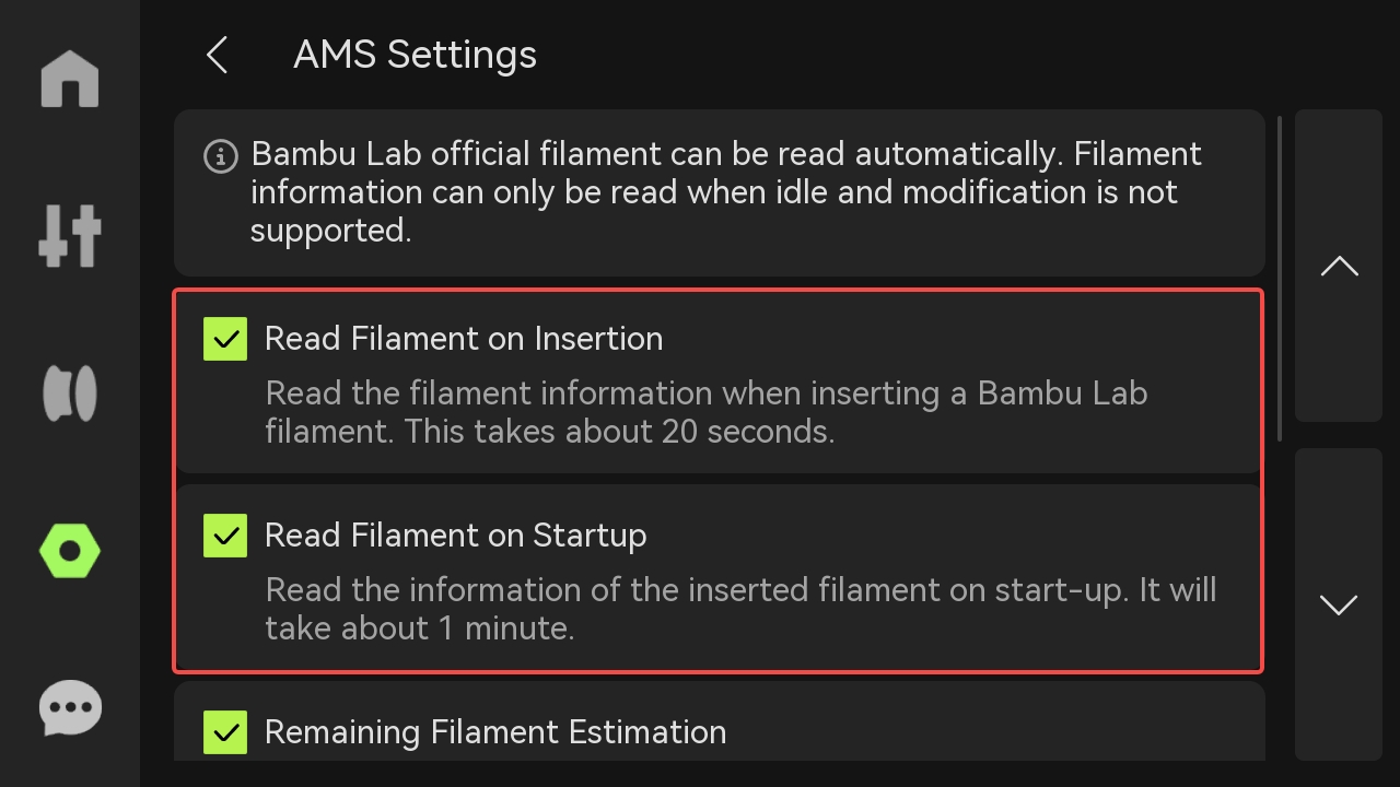

It could just be that you have this setting enabled:
I’m interested in finding out what the issue actually is.
It could be the phrase, (when idle and modification is not supported). I know I was between prints when I changed the filament, but not sure If I was modifying a print in Bambu Studio.
