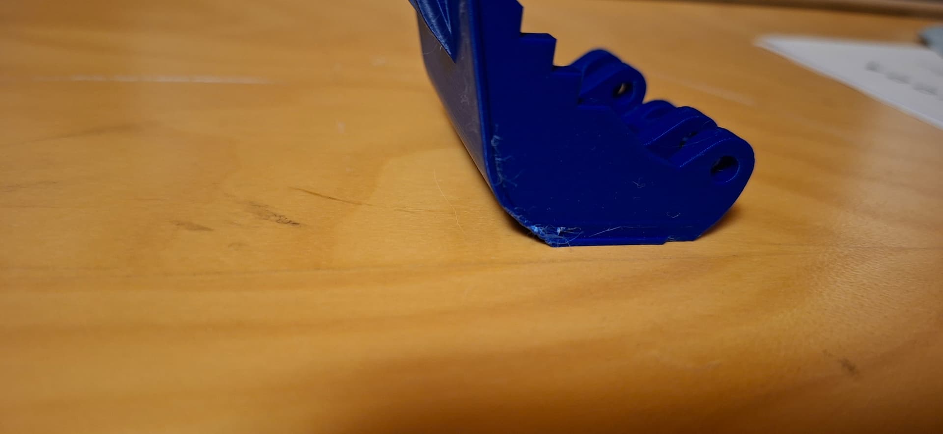

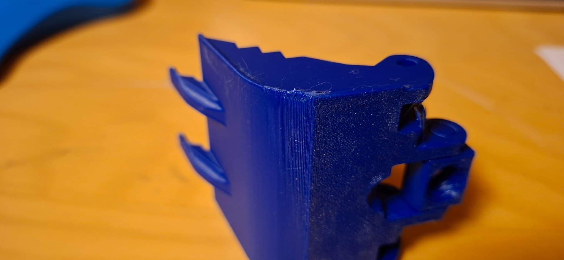

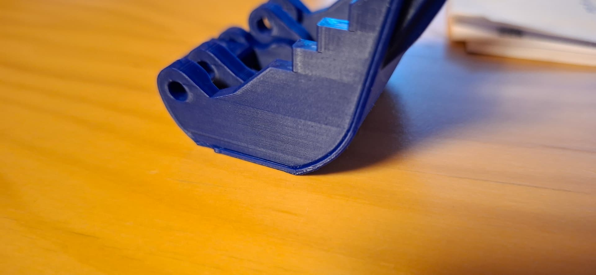

Hello everyone,
I urgently need your help with a persistent printing issue!

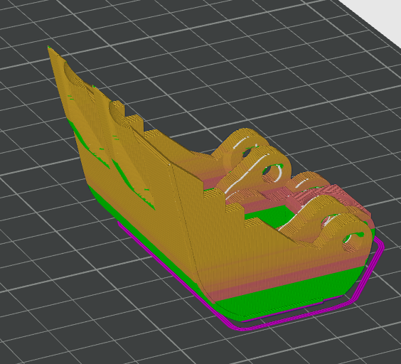

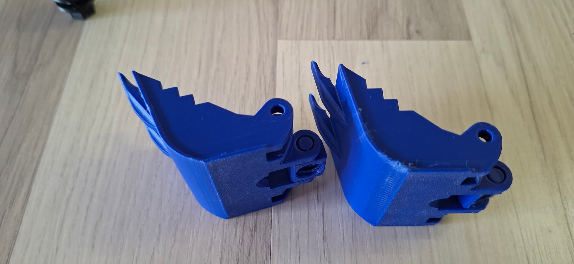

I am struggling to get one specific corner of my 3D print clean. As you can see in the pictures, one corner is perfect, while the other looks messy and flawed. This is the corner that the print head approaches second—exactly the spot where the nozzle is currently positioned in the fourth image from the slicer preview.
I am printing with dried PETG HF and have already tried the following steps without any improvement:
  • Speed: Reduced to 120 mm/s
  • Acceleration and Printing Speed: Lowered
  • Layer Height: Adjusted
  • Printing Temperature: Reduced from 245 °C to 235 °C
Unfortunately, none of these changes have led to an improvement.
I sincerely hope you have some tips or ideas in store on how I can solve this problem. Thank you in advance for your support!

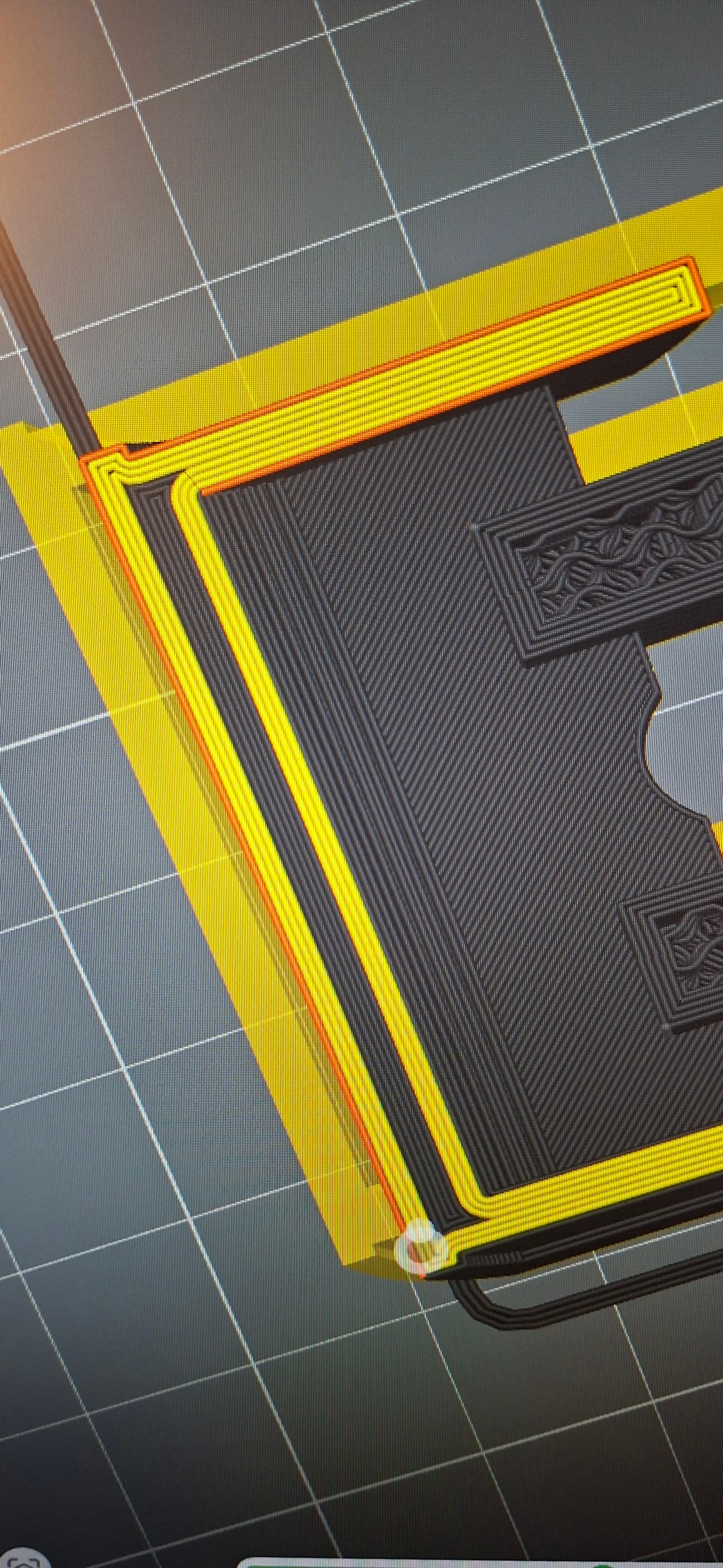

Another item you may want to look into using the preview is “Detect thin wall” in strength and line width (using the Arachne wall generator can help somewhat). I can not be certain if these relate to the defect you are seeing, but you may be able to spot differences already in the preview.

Another guess. Are your seams located in the area of the issue? You could try setting the seam location someplace else (I.e. back).
So, I tried your suggestions. I printed everything at 120mm/s, recalibrated the filament, adjusted the Z-seam, and set it to random. Nothing worked.
But I’ve found the solution now.
I ran the part cooling fan at 100% on the lower layers where I was having problems.
It’s not perfect yet, but it’s much better.
Thanks again for your help, and if anyone has any other ideas, I’ll run some more tests.
