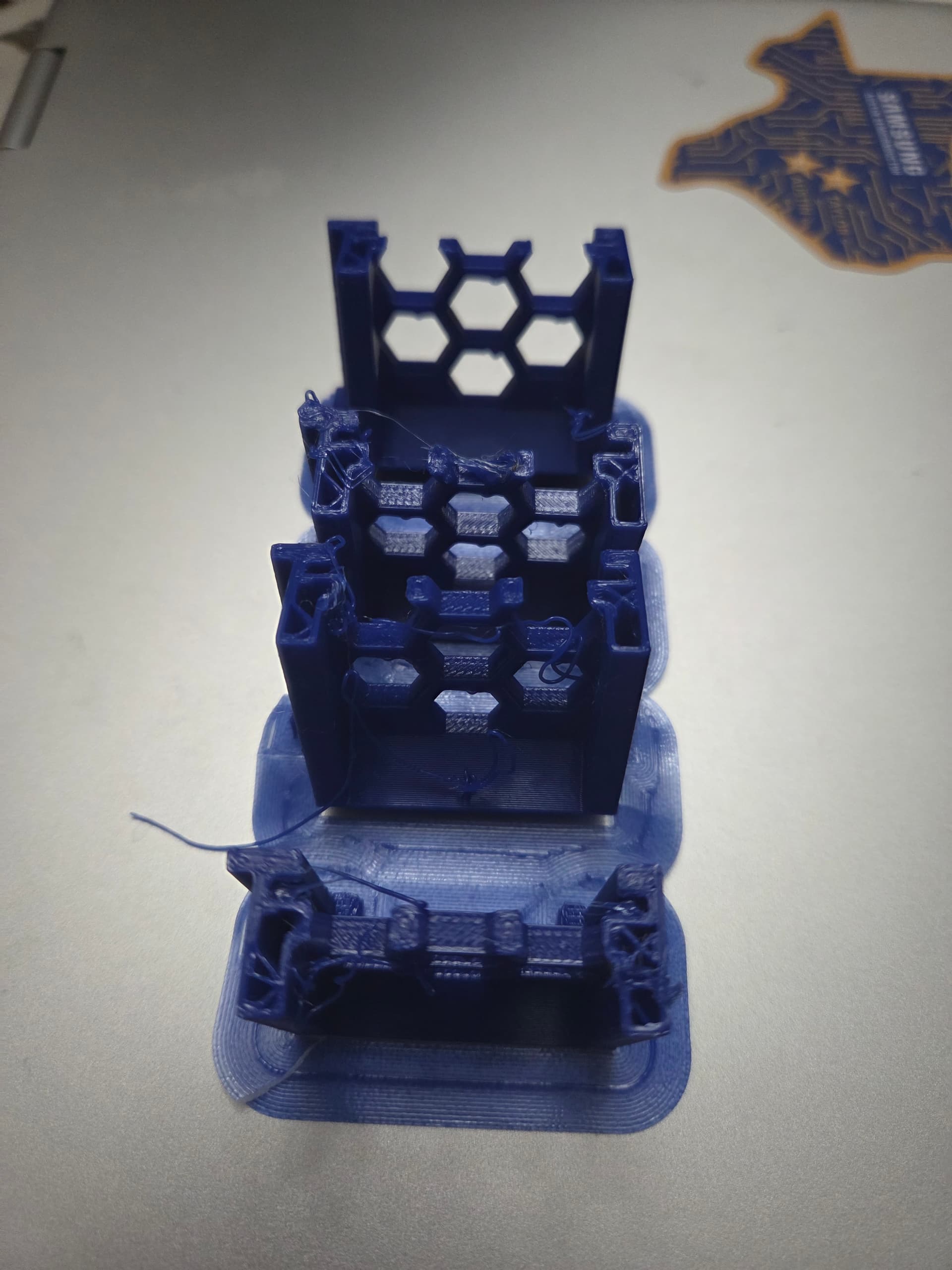

Hey all, I’m TOTALLY new to 3d printing, and the P2S is my first ever 3d printer. I first started off printing generic PLA, and everything was great, perfect.
I decided to try out some generic PETG next. I dried my rolls in the AMS 2 for over 12 hours. At the moment, I am only using makers world projects, as I have not created anything on my own. I have realized that I am having issues printing with PETG.
On my first project, I had to bump the temps down from 275 to 255 degrees to prevent blobs from building up on the nozzle. That seemed to work great. I even went as far as printing a temperature tower. Please see picture.

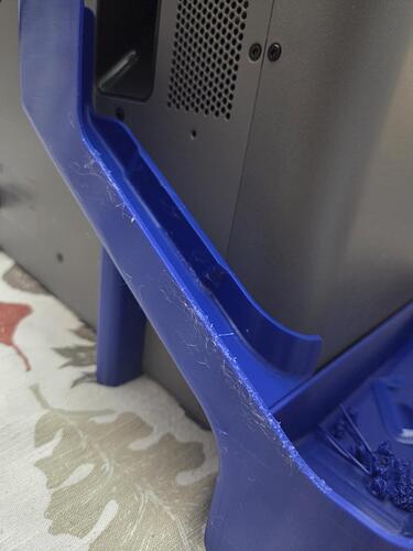

At the moment, I have been keeping my nozzle temps at 245-255. This seems to eliminate the blobs. I have noticed though that I am getting some pretty bad stringing on my prints. See picture below.
The print above did finish, and is not a total waste, but the extreme edges have that bad stringing. I read alot of forums that said this could be due to the part cooling fand running, which I noticed is usually running at about 90% during PETG printing. See picture below.
Based on recommendations, I kicked that back to 60% and had a total failure of my print. See picture below.
This print was actually knocked over by the print head, and tons on spaghetti was on my print bed. I had to abort the print and start over. This happened to be a multi part print, with 4 tall towers. I started over, and only selected to print 1 tower at a time, at let the part cooling fan run at its set rate of 90%. The single, individual print came out GREAT. No issues.

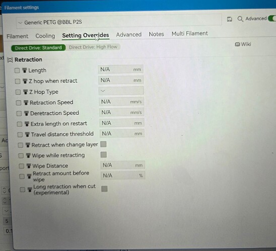

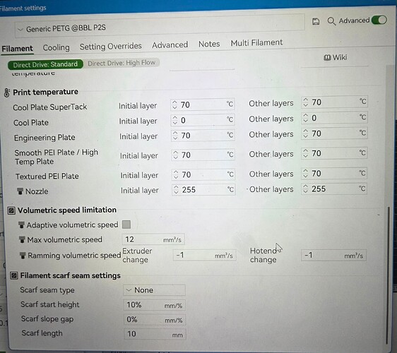

EDIT! I am also adding some pictures of my settings for this particular filament. These are presets, and I have not changed anything with these settings. Does anything look “off”?
I would begin by drying the PETG roll. Fine stringing near seams/travels are very often from dryness problems. PETG is susceptible to moisture.
You didn’t mention the brand of petg. PETG is unlike PLA, in that the various companies formulations are sometimes very different from one another. It might help to mention what you’re using. Some love heat some do not.
The fine strings also can be nearly completely removed and cleaned up with a quick pass of a jet-style blue-flame lighter, or heat gun/soldering station air.
Re: print time, the “generic petg” profile has a minimum layer time of 12s, which means that even if you have one small item on the plate, it’ll reduce speed to hit 12s every layer. My guess is that is what you’re bumping into. The concept of speed optimization is far too long for a forum post. 3 speed params (v,a,j) multiple constraints (min time, max flow), multiple operations that take static time (wipe, spiral, timelapse, etc).

The settings below inform the slicer what to try to do when the sliced time is less than 12s. This is very model-dependant, but I generally choose to enable “dont slow down outer walls” which helps the piece get a better consistent finish, but it means it has to slow down the inner walls/infill even more dramatically which might cause other problems.

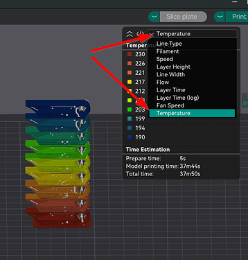

Before I make any suggestions I have one question. Where did you get this model? I’m seeing it now multiple times in other forums and in most cases, people are downloading it and using it incorrectly. Not to also mention that as temperature towers go, this is very wasteful of filament and unless one is experienced, it tries to do too many things at once and doing none well. Did Bambu Studio change their Temp Calibration - I abandoned BS well over a year ago and have been on Orca Slicer ever since and that model was not part of the last version of BS and definitely is not part of Orca’s temp calibration routine.
From what I see, this tower was printed at one temperature which leads me to believe the static STL was downloaded unmodified. The baked in models or 3MF files will have the necessary GCode to vary temperature.
Here’s what a properly coded temp tower should look like when the temp gradient filter is applied. Double check to make sure you see this rainbow scheme if not, then that confirms that tower was improperly printed.
Correct tower temperature gradient
Incorrect temp gradient. Note only one temperature.

  1. PA Calibration and flowrate calibration. I am not too troubled by this image but it should be investigated. Stringing like this is most often associated with either improper temp, PA calibration or improper retraction.
  • For temp - you already know what you have to do, mentioned already above.
  • Pressure Advance - There is PA Calibration utility baked into Orca or you likely will find it as a downloadable 3MF file. Bambu Studio may have it by now but as I have not been using BS since v1.6, I wouldn’t be able to guide you, perhaps someone else can comment.
  • Retraction - This can be tested using any string torture test. There is a retraction test in Orca Slicer - If you haven’t pick up on the vibe yet, Get Orca Slicer. home · OrcaSlicer/OrcaSlicer Wiki · GitHub

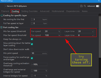

  • Check your fan setting in the filament profile and try turning it off and see what results occur if any.

  1. The temp tower I downloaded from Makers World. I did verify that the temps were actually changing, as in the slicer I had the “rainbow” effect, and I witnessed the nozzle temps changing as the print progressed. I checked that the G Code had the correct temperature changes

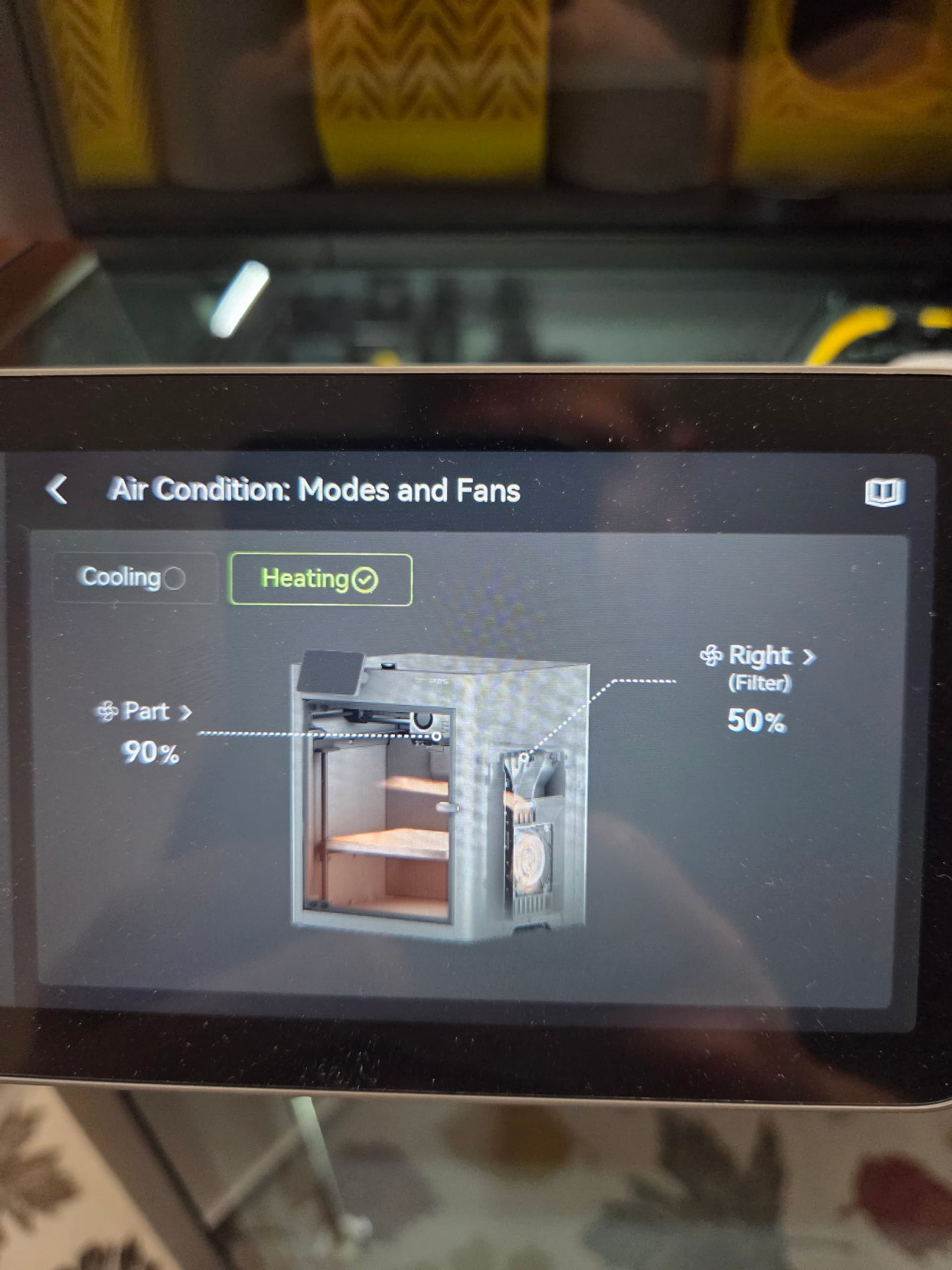

  5. I am in agreement with the cooling to fast statement that you made. As I stated, my part fan stays on 90% for the duration of the print. Isn’t that to high of a fan speed? Wont this cool down my print way to fast? I’m thinking that its not happening on the first layers because the bed temp of 70 C is keeping those layers warm, and not allowing them to cool as quickly.

I think in bullet #5, Fan speeds. You may have found your smoking gun. Fans should not be on in PETG under most circumstances. This would also be consistent with the failure mode you showed in your photos. It’s an easy thing to test too.
One quick thing you can try. Try to print with the Bambu PETG basic profile and test the results. From there you can fine tune the fan speeds.
Or simply compare the two profiles in the slicer. Here’s where to navigate to the comparison table in case you haven’t used that option before.
