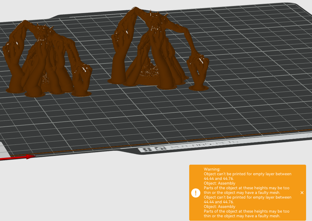

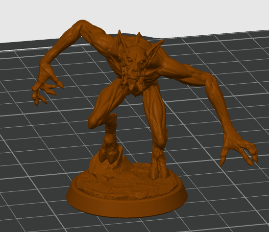

Am trying to slice the following mini:
and it is coming out like this:
Not sure what the error message is down the bottom and when I try and print the file the arms dont print because as you can see there are no supports generated to support them does that make sense!
Any help would be appreciated!
It may become sliceable (not neccessarily printable) with the “Arachne” wall generator and a 0.2mm nozzle.
small Details on!
and arachne
Nozzle?
Detect thin wall enabled?
Tried upscaling to see when it becomes sliceable?
Thanks for the replies. The file was already using the Arachne wall generator and I cannot select the detect thin wall option as per below
I am printing at a 0.08mm layer height and are using a 0.4mm nozzle. I do now have a 0.2mm nozzle ready to go I will give that a go.

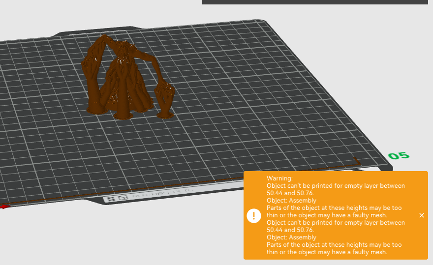

The file is already at 120% but yes I will scale up to see how it goes! This is the same file at 100% and 110% scale, but it still has the same error.
Thanks again!

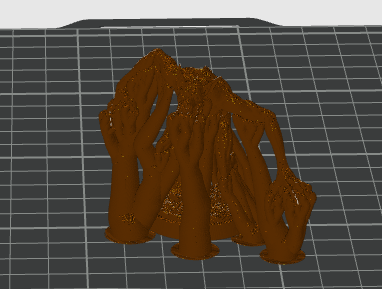

OK! I have received my 0.2mm nozzle and installed. I sliced in a 0.2mm nozzle and did not seem not have the error message. This is the result:
Ill see in just under 5 hours!
