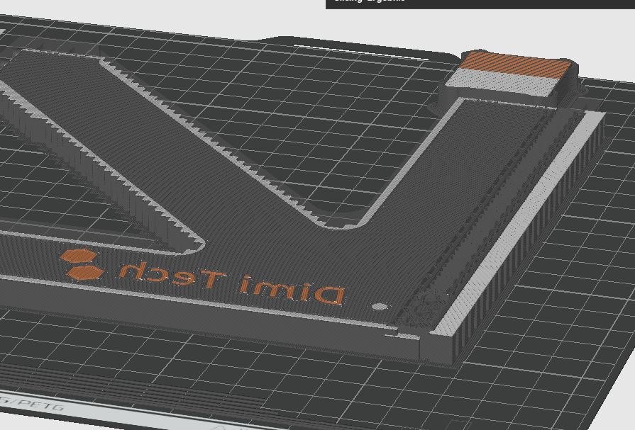

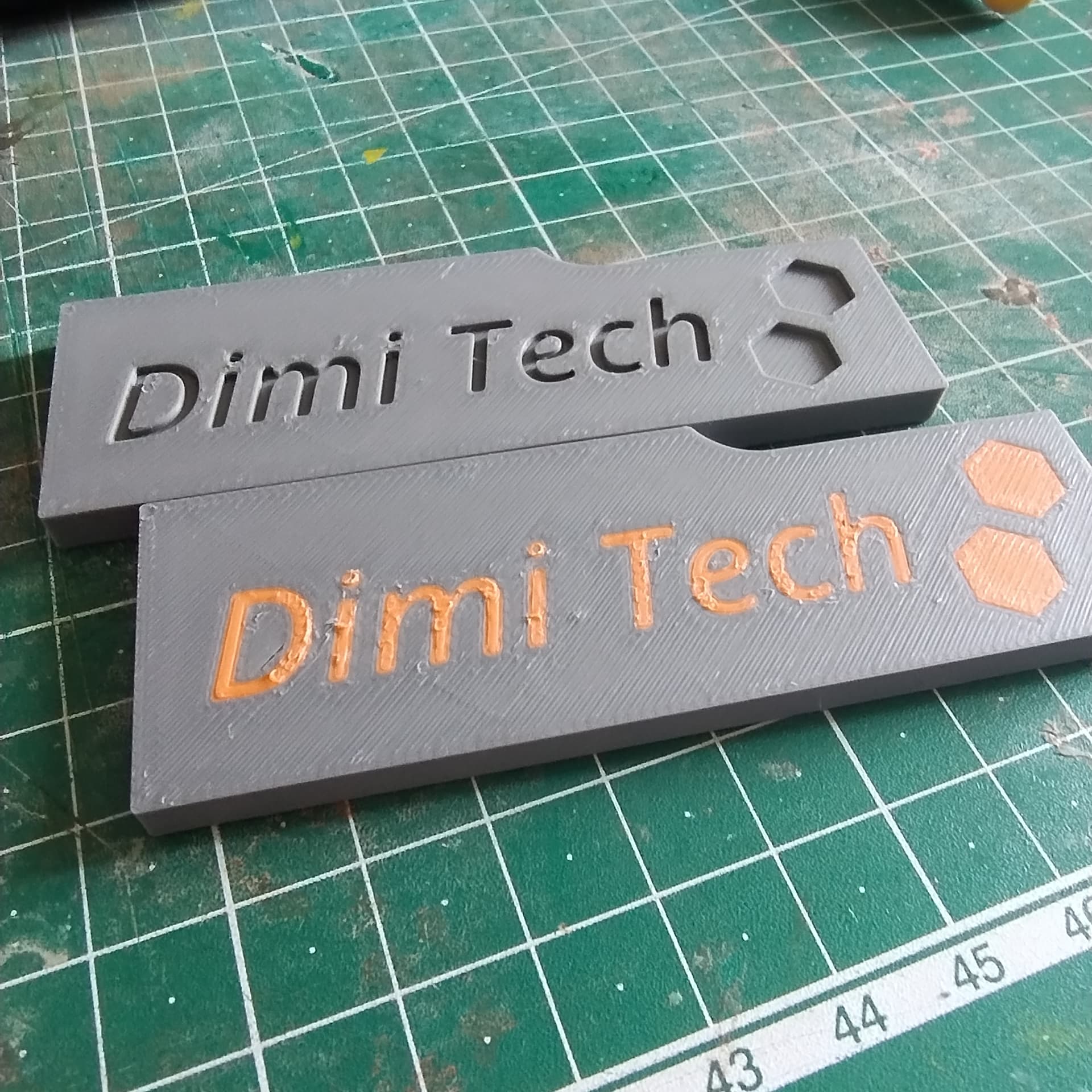

I designed a rack in freecad and I try to print it now. It consists of several subparts and although I have done the following steps and iterations the result is not optimal. By far not optimal. Here is a testprint with extruded letters and without:

→ all prints have spots with slight over extrusions
→ the biggest issue is like shown in the picture above.
→ after failing multiple prints I did a complete new calibration. With the standard 0,2mm profile in bambusstudio without any changes the print still looks like the picture above.
The nozzle seems not to be clogged. I have zero idea how to solve this. Can you give me hints / solutions?

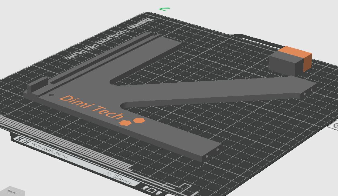

Also here unfortunately it will not work. Please see the attached picture. The string from the first picture was just a small portion, cut out of the bigger model. The bigger model itself has standoff geometry which is higher than the string surface. I hope you understand what I mean. In this case I would use enormous amount of support.
Is there no other way?
The string over-extrusion was just an extreme example. My surface overall has here and there spots with over-extrusions. I am seeking for support how to solve this. I am printing for ~1month now and my first models were perfect.

Ah, that does explain the desire to print the text as is rather than upside down…
I am not certain what you have tried, yet.
If you really need to print right side up, did you enable “wipe on retract” in the filament settings and for the text object “Arachne” wall generator with a wall count of 999?
You may also have a chance with ironing, but unfortunately, I can not advise so well on that.
Addendum: Printing text well upside down on top of support would require a 0mm z-distance between the support interface and the part. So you would need to use a different material for the support interface. PETG or PVA/BVOH for PLA…

Around the seams near the letters, there are small bulges/blobs — a classic sign of too low Pressure Advance from now on called PA.
The corners and line endings appear rounded and not perfectly sharp — this also indicates insufficient PA.
The rest of the surfaces do not show signs of under-extrusion (no transparency or gaps), which suggests the flow rate is correctly calibrated.
The top layer is even but has small “bumps” — another clear indication of PA issues rather than flow.
Overall, this most likely points to too low PA/K-value. is a clear

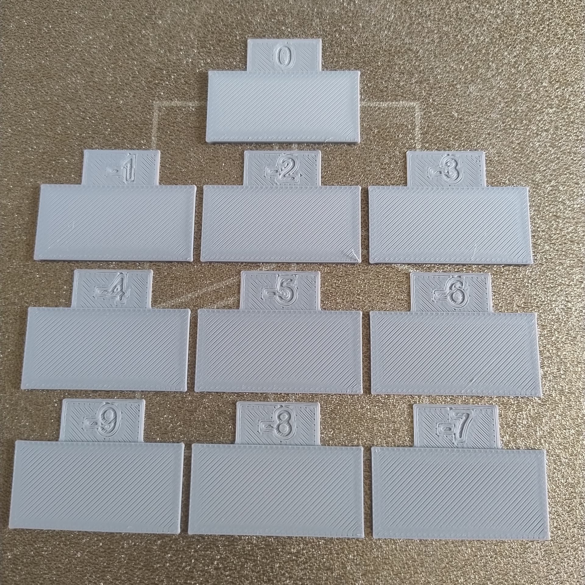

Anyway I did the process and the test-bodies look like this:
It seems that the predefined value is wrong? Should these lines on the top surface be visible?
I have chosen -7 because to surface was the smoothest
Thanks
That is Pass 2, what did you choose in Pass 1?

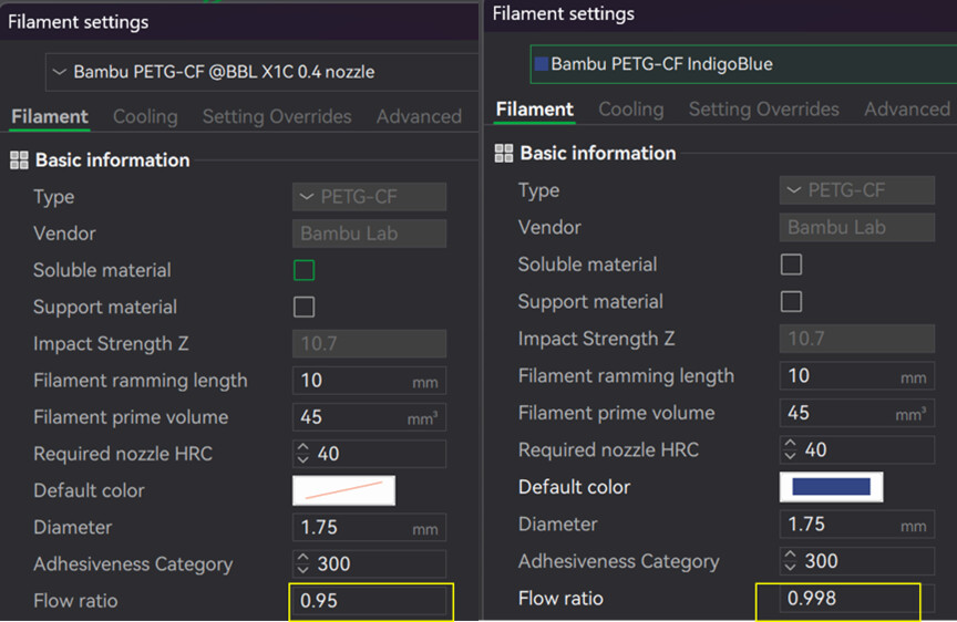

  • the 0.98 seems to be the default value, e.g. BL PLA Basic has by default a flow rate value of 0.98;

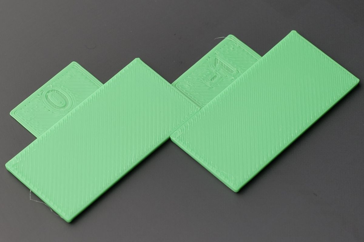

  • but if you use the BambuStudio Calibration, the result value will override the default one, and get stored there; e.g. on the left is the default BL PETG-CF and on the right is my own after calibration:
  • In the manual flow rate calibration, you can choose the complete calibration based on the flow rate value. When I run it, I start with the complete calibration and then fine-tune it with a new run using the flow rate from the previous test.
The lines should be visible, but in your case, the distance between the lines seems, in many cases, larger than expected, which is the opposite of what was noticed in your earlier prints. As your goal is an aesthetic surface, I wouldn’t see these results as acceptable, so I would try running a second-stage calibration to fine-tune the results.
The middle region of those probes should be smooth, without visible lines, while at the same time not overlapping lines.
I agree that it isn’t easy to identify the best, but you should expect difficulty from many samples with a smooth middle section and not the opposite.
Edit: check BL wiki images, to see what to expect:
In general, if your best result is at the end of the tested range, you want to extend the range in that direction far enough that you begin to see worse results in that direction. You may have found a better result with something less than 0,013.
In your picture, I think the zero sample is best (but not right) and the rest become increasing worse. The “valleys” between the lines get deeper as flow is reduced. The lines are not squishing tightly against each other, a sign of slight underextrusion.
