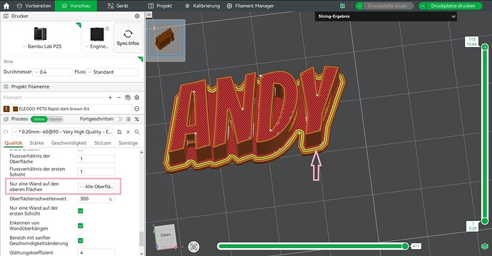

Hi everyone :slightly_smiling_face: After a few years using Klipper-based machines and slicers like Cura and Orca, I’m currently trying out the Bambu ecosystem. I ran into my first issue today: I want to have just a single wall on every surface in Bambu Studio. I believe I’ve selected the right setting for this, but instead of printing a single wall on every surface, it’s printing the default three walls in some areas. Orca Slicer handles it exactly the way I want—see the comparison images and the pink markings. Can anyone tell me how to achieve this in Bambu Studio?
maybe the surface threshold (next setting) does help?
That was the solution to the problem. I had never had to deal with that setting before, which is why I didn’t think of it. Thanks a lot, my friend.
