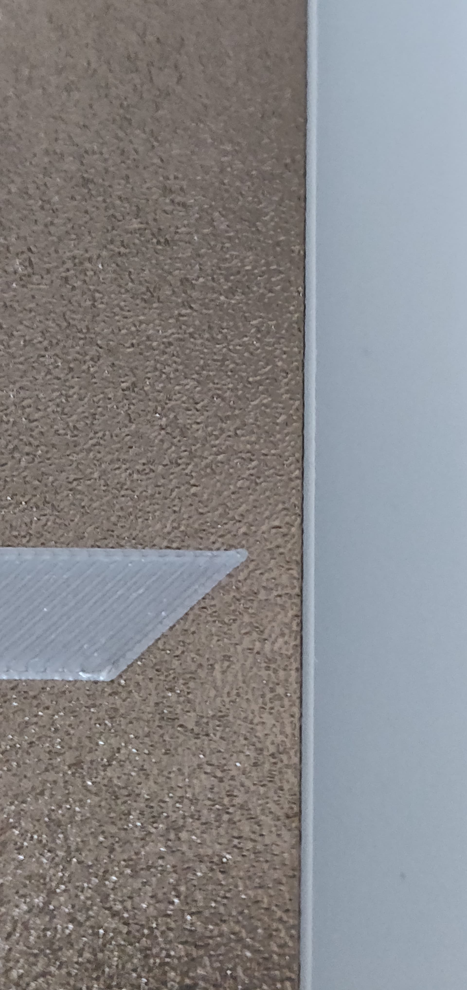

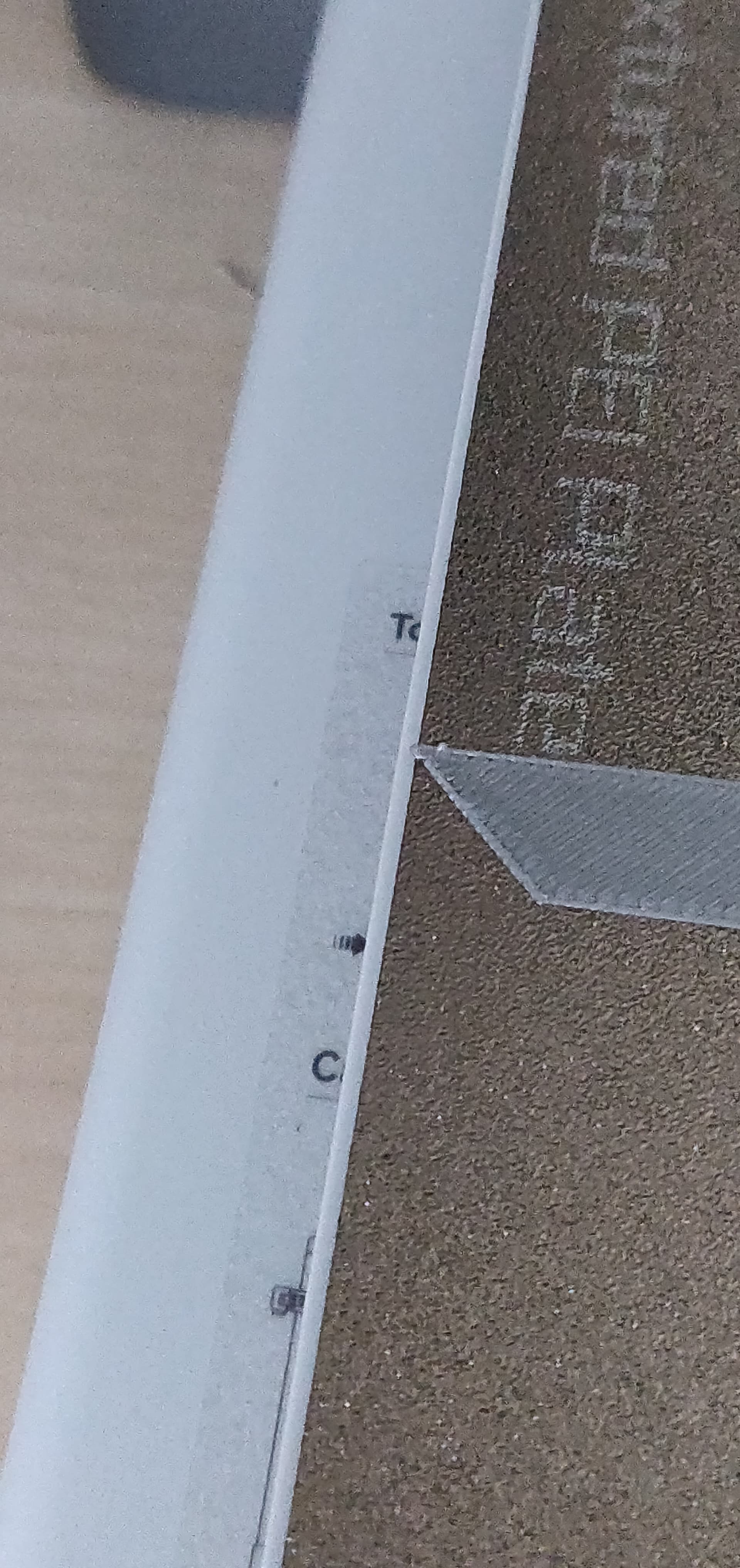

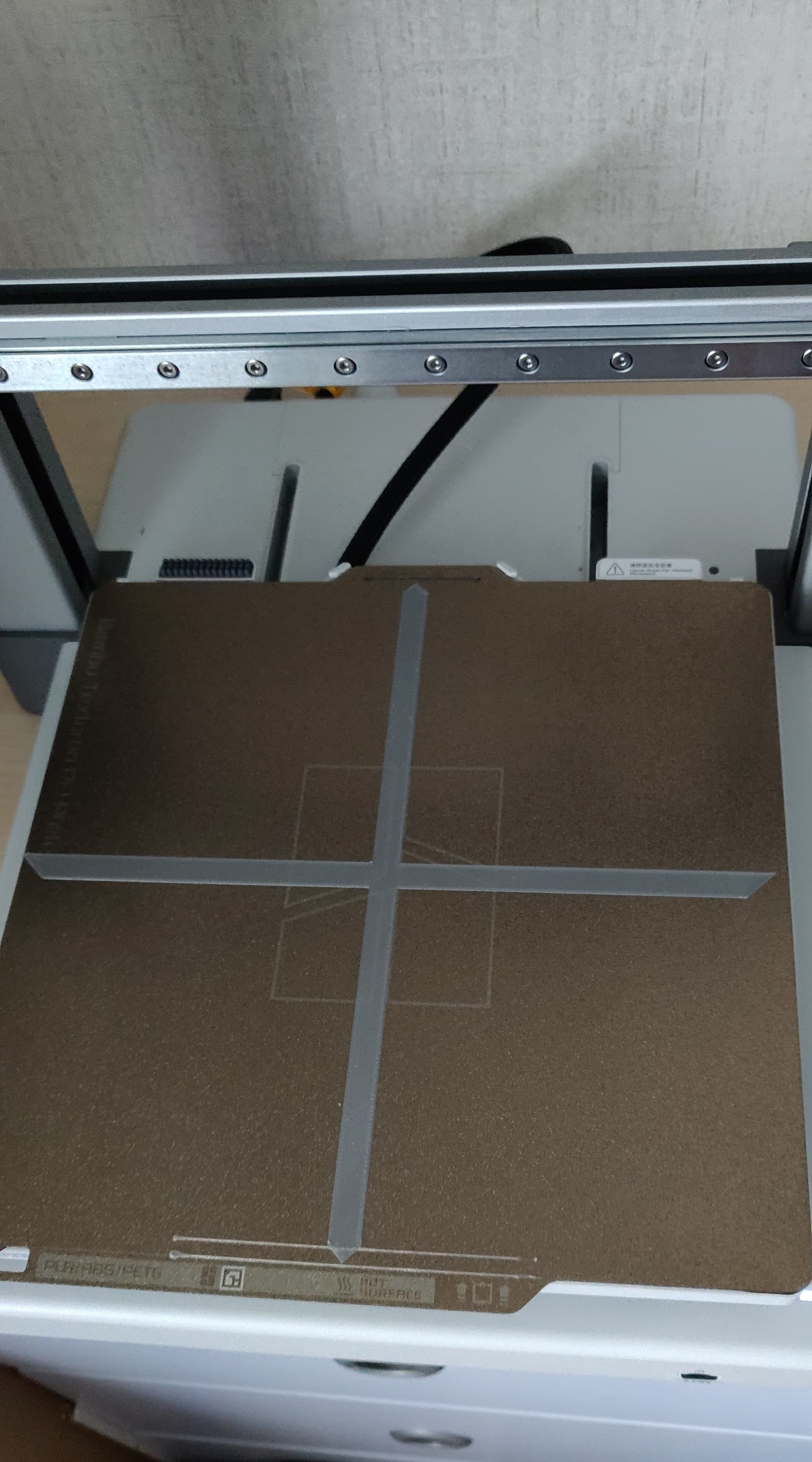

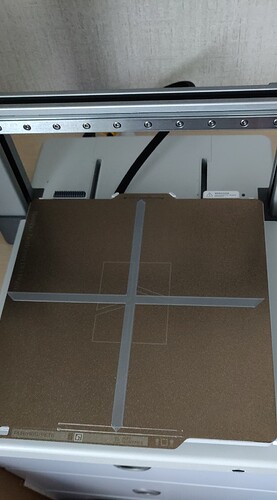

Printer prints everything about 2mm to left, not on center buildplate. Y side is OK. On attached photo I made test item 256x256x0.2 and printed it.
Anyone have idea how to fix this?

Actually yes. If you look better, then you see, that test item printed about 1mm on air, not on build plate. And if I have 256x256 size build area, then I want use it.

With it homing to the left you should be able to put an adjustable clamp on the rail so it senses the hard stop and shifts the work area to the right.
I think the Extruder offset in Orca Slicer should be able to get things centered if you really need it.
As always, I’d recommend reading about this setting first & make small changes to be safe.
