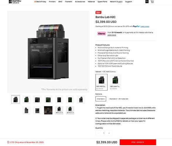

Where do you see the delivery date?
Go to the H2C and click buy, now you can see the ETD on the bottom left.
Here in EU it’s Dec 12.
Looks like the H2C in the US is on backorder/preorder?
Just yesterday I was able to add to my cart and purchase…
You can still add to your cart and purchase, but won’t ship until November 25.
Yeah, just a change from when I just ordered one, which should be here in a few days to a week I expect. I wonder how many printers sold moved the H2C to that state, pre-order? Also, the H2S has been on backorder, did they not make that many or its just that hot? I would love to see the raw numbers.
