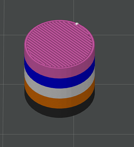

I have create a test model using your colours (although I guessed the shades), match them if they do not do so automatically.
You are just looking for one colour per band and five colours in total.
I have turned off the prime tower as it is not required for this and would just be another waste of material.

Make sure it prints in this order.
FiveColourTest.3mf (34.2 KB)
It should look like this.

For some reason when I open that file it’s showing as a single color column? It loaded as all black and just swapped to all white even after I updated the filaments.
It will do, just slice it.
I used Layer height modifiers to do it.
Oops, I didn’t do it in exactly the same order as you said to print it, but it does seem to have printed the 5 colors. Weird.

The order was only to make sure all five printed.
As your real print is long, I would try another test print to be sure.
Then try the original job and triple check everything matches.
No idea what caused the original failed print, but after printing your test tower twice without issues I’ve now printed a couple of successful runs of my original model! Thank you!
