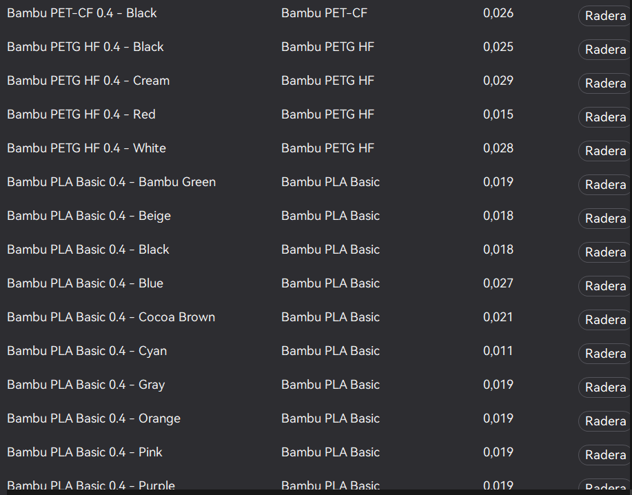

I really prefer to always calibrate my K-values based on the filament and if I know it has been sitting for a while, do a re-calibration. BUT, as we all know the K-values are stored in the machine and can only save up to 16-values, which is pretty limiting if you have about 30 colors.
So far I’ve gotten around this issue by marking down the filament K-values in the notes of the filament profile and then choosing some pre-saved one that is the closest.
I’d like to find a better solution to this.
My current theory is that maybe there is a way to add g-code to the filament settings advanced tab? Something like “pressure_advance = 0.034”
But my fear is that the software k-value over-rides this and won’t apply.
How have you solved this issue?
Because if this doesn’t work my plan was to create manual K-values for ‘generic PETG’ and ‘generic PLA’ with steps of 0.005 and then just choose a value from there that’s closest to the one marked on my filaments. (Ie I have 0.033 marked down for Bambu PLA Grey, so I choose ‘generic PLA’ profile with 0.035 value).

In there you can only have 16 result, meaning if you have more than 16 different filaments, you would have to go and change the value manually every time you use a filament that doesn’t fit into the 16 ones you can select.
I have 37 different filaments, so that would get old really fast. This is why I’m looking for a better solution :wink:
I’m pretty sure I have more than 16 PA values, all my filaments have one for each color and my ASA Aero and PLA Aero have more than one depending of what I’m printing.
I’m sorry, but it is 16 per nozzle not per filament type. It has been acknowledged that they are saved in the printer itself and the limitation lies in the hardware.

Unfortunately, at least on my current A1M it won’t allow me to save over 16-values (view the screenshot above). Otherwise I would agree, I’d prefer to keep them in the designated area, but 37-values don’t fit inside the 16-value limit, because number 16 is smaller than 37 :smiley:

There are multiple threads on the web, where it is noted that there is a 16-value limit.
On one thread someone had gotten a reply from the support stating:
“Currently, the P series printers can save a maximum of 16 K-values for the same nozzle diameter. If you want to save more K-values, would you please try using a different nozzle diameter”
