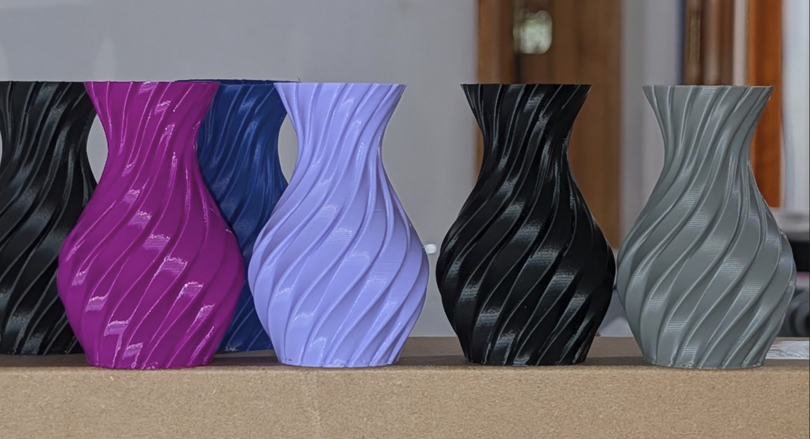

Here is the new matte PETG. Zoom in to catch the highlights, the more spread out they are is more matte. If you were happy with SUNLU-HF you’ll be OK with this too. Seems stronger than average for matte. Noticeably wet out of the bag at 0.4% .
L to R (increasing matte-ness)
Bambu PETG Basic (original) as a shiny non-matte reference
Bambu PETG Matte (new)
Sunlu PETG-HF
Sunlu PETG 2.0
So very comparable to Sunlu-HF, somewhat on the shiny end of matte.
Roughly sunlu-hf level of matte (sorta matte):
Bambu Matte ← tested
CHCKX
Sunlu HF
Satin matte:
Tinmorry
IEMAI
Sunlu 2.0
Very flat matte (ultra-matte):
Kexcelled
eSun
I just ran another one off with the bambu settings instead of generic, it’s even less matte. It’s still ok, if you are just looking for a less shiny but still strong petg you’ll be happy, but if you are looking for truly matte maybe not so much.

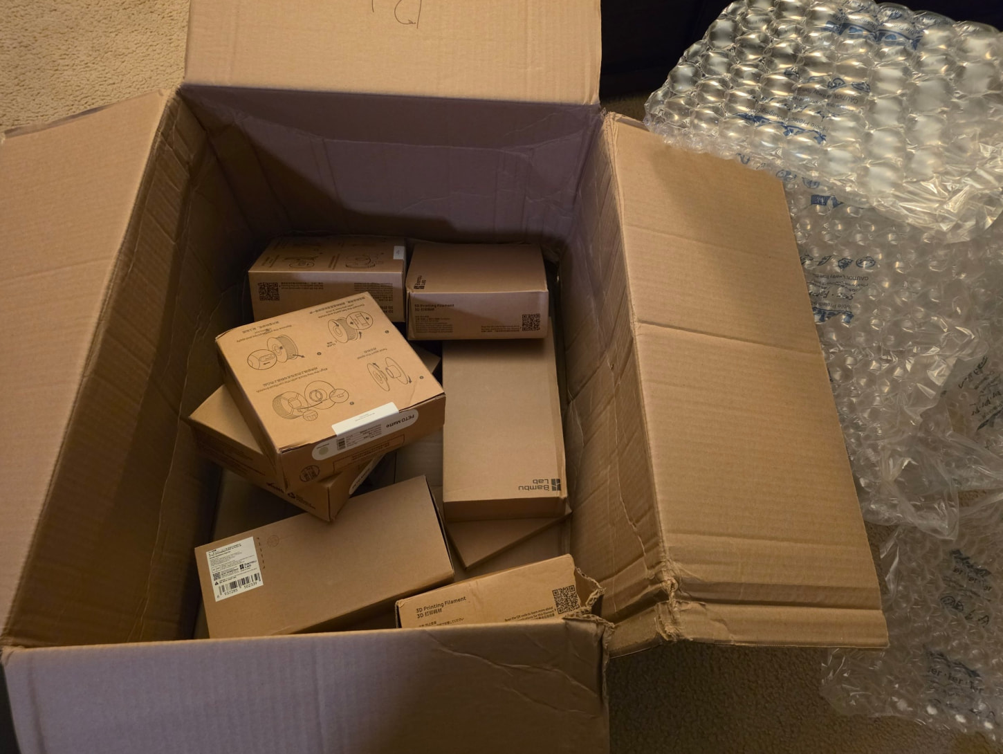

Was about to test Matte PETG … but BL and their infinite wisdom of ■■■■■■ packaging.
Who in the right mind puts 1kg objects in a huge box that fly around inside that box… anyway, the package is ruptured, some of the filaments are lost. Thanks UPS, you are great as always.

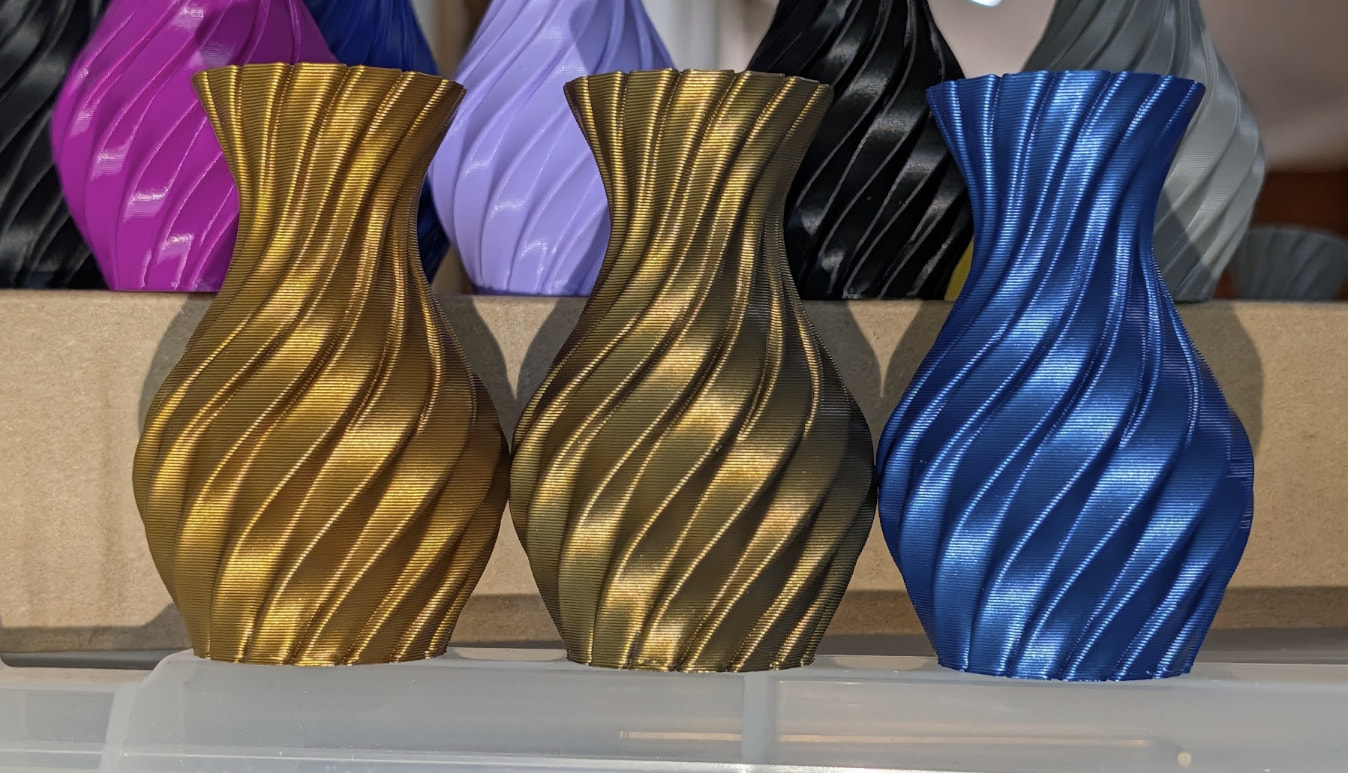

Here is the new sunlu metal fill:
There are L to R:
Marrakech Bronze
Brass Gold
Azurite
(no, this list order is correct!)
If you hand someone the “Bronze” and “Gold” and ask them “which is bronze and which is gold?” they will tell you the reverse of the brand names. The only thing I can think of is they confused bronze and brass, calling it brass would make sense, but not bronze. But then they go on to call the bronze-colored one “Brass Gold”. Confusing. I wonder if they made a mistake in the factory.
So if you want gold, I suggest you want the “Marrakech Bronze”. It looks like a 24K gold bar.
These look good I might have to order a set. Thanks for sharing the pics.
Yes they are a nice, high-fill metallic.
Their ads show a coppery-reddish filament, I’m not sure if that is a 4th unreleased color or what, but neither of my samples are at all reddish.
