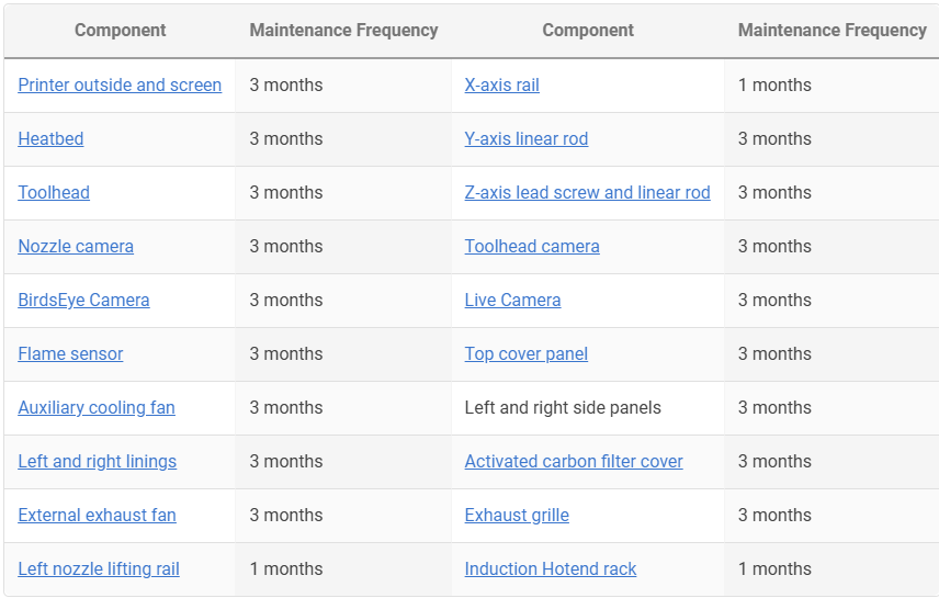

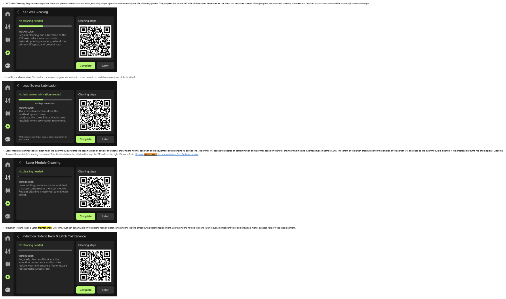

Settings, “Toolbox”, Maintenance on the printer screen. Indicator bars show when you need to complete maintenance.
Regular Cleaning and Maintenance Recommendations for the H2C | Bambu Lab Wiki
H2C Screen Operation Guide | Bambu Lab Wiki

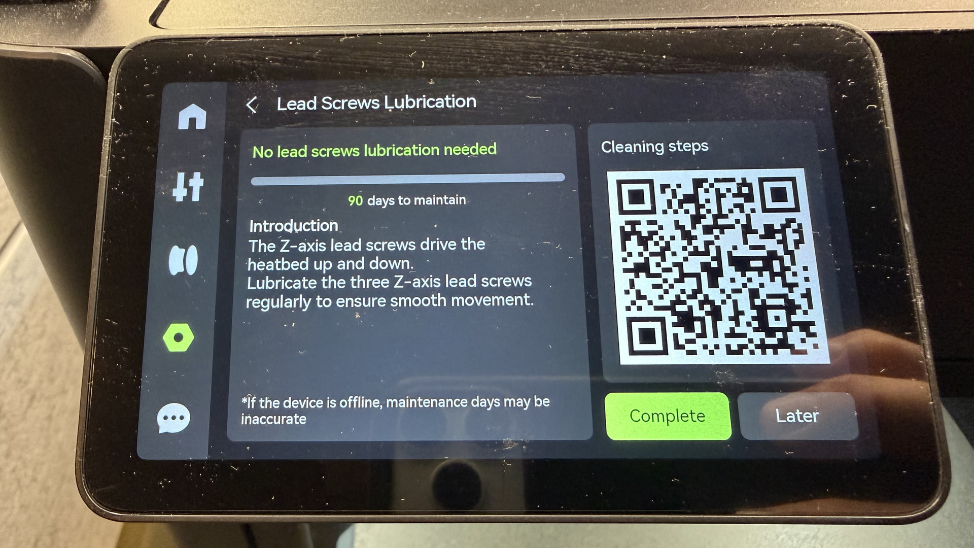

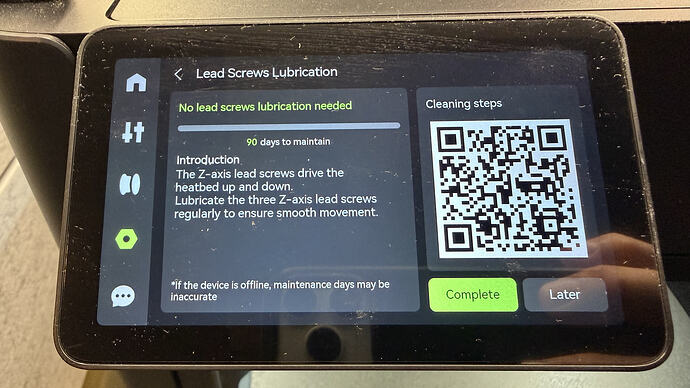

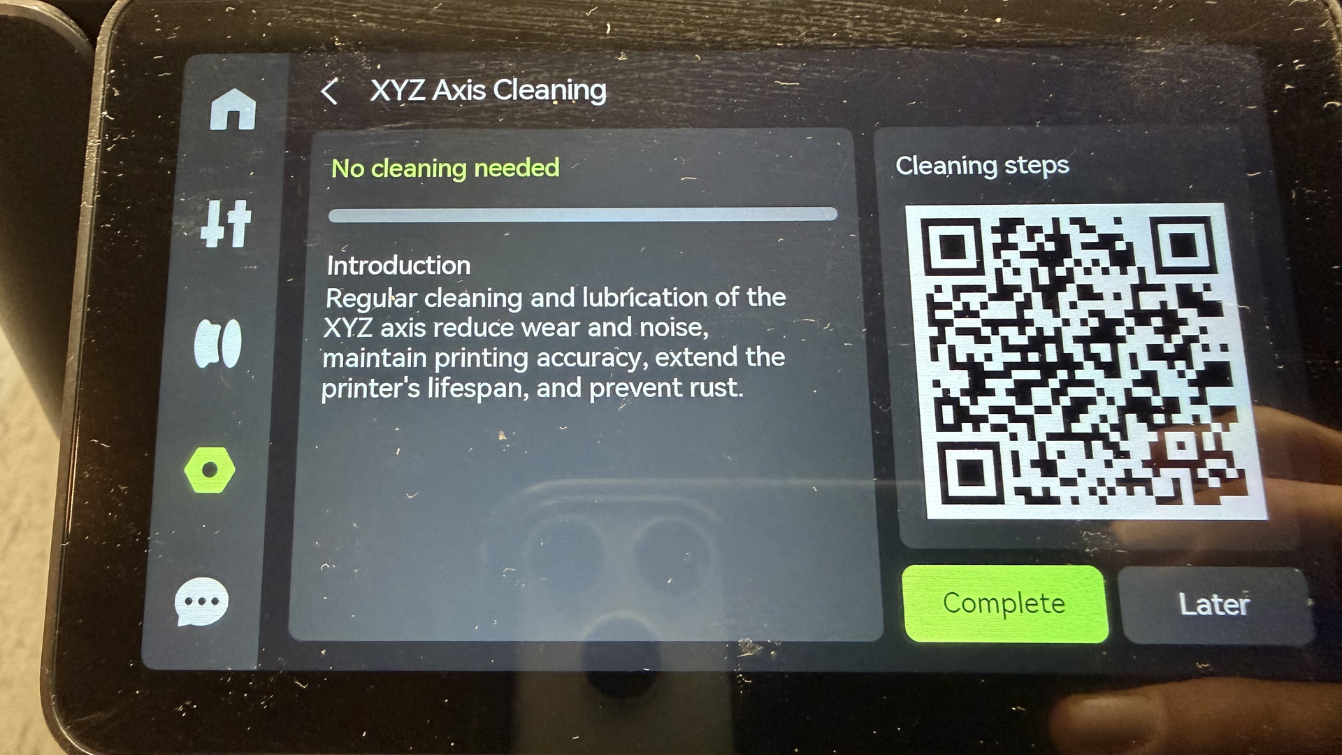

On my H2D Pro, in LAN-only mode and with blocked access to the Internet, I only see progress bars on the XYZ cleaning and the lead screw lubrication ones and they stay at 0 forever. [Obviously not a H2C, and no laser module is installed, so that one just says it’s not installed]
Last time I did any maintenance was 3 weeks ago.
Hence, I do not trust this system is working at all.
What firmware version are you running? I remember early on with my H2D it behaved like this, and I believe one of the later firmwares fixed it. I’d have to go dig through firmware notes to confirm.
Also, if you are completely isolating your printer from using NTP, it will not work. You would need to unblock UDP port 123. I understand if you don’t want to unblock anything on your printer’s network. You could host a local NTP server, but that sounds silly to me just to enable progress bars. If that’s the case, follow the maintenance chart I posted above.
Which firmware version are you using?
I remember that I suddenly received maintenance messages after a firmware update. So I have the feeling that it was an issue and was fixed in an update for my standard H2D.
Unfortunately I don’t remember which update that was.
