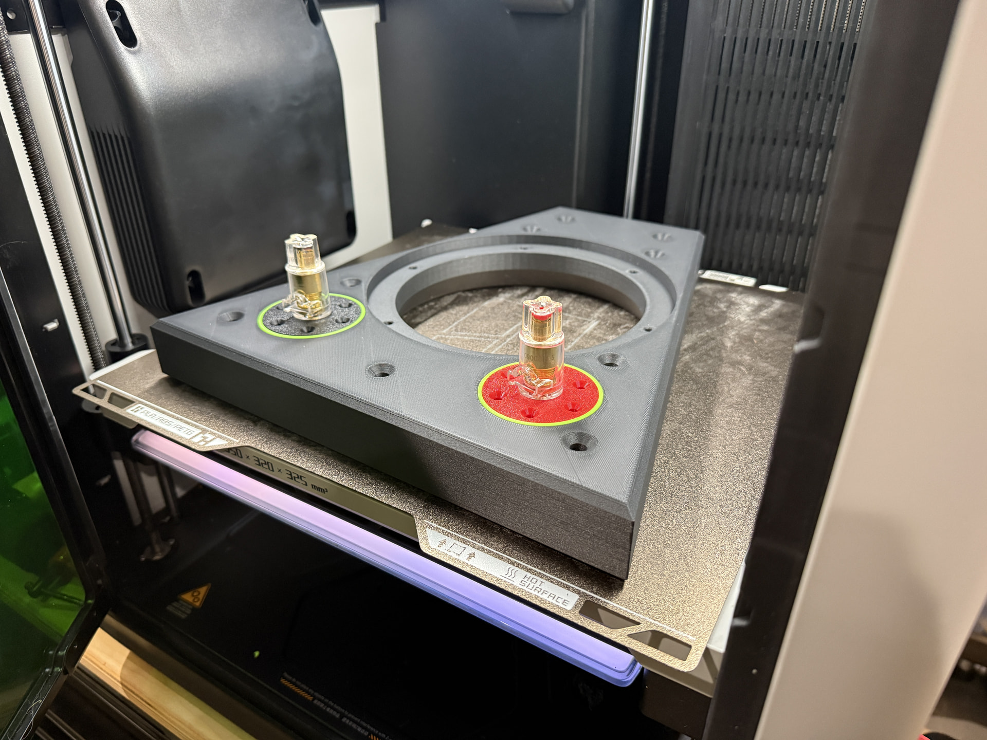

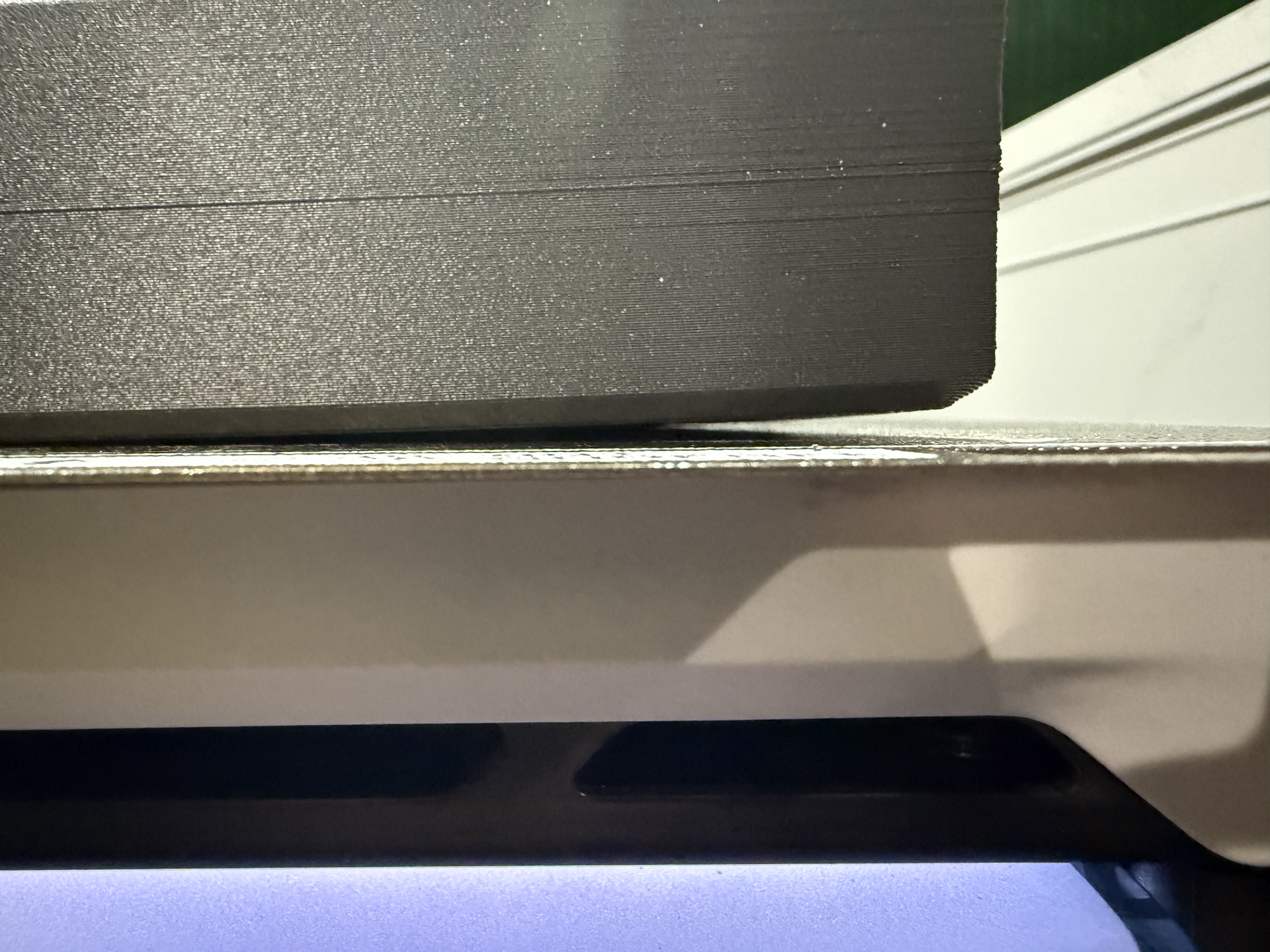

Greetings! I have a pair of H2Ds that have been working very well for me over the past ~18 months or so for smaller projects, but I’ve ‘graduated’ to a larger project of my own design and have hit a snag. Namely, on long and large prints (>1 day print time @ nearly the full bed width) I’m seeing notable retraction of parts from the bed at the corners of the print. This is important because these parts need to seal against each other using a thin TPU gasket.
Apologies if this has been posted before - I did attempt to use the search feature.
Materials I’ve tried include PLA, PETG, and PETG-CF. PLA is not preferred for this project but shows the least retraction (but it does retract). PETG and PETG-CF unsurprisingly show about the same retraction. The CF variant is the filament of choice for this particular project but I also need PETG and PLA to work.
Thing I’ve tried include beveling the underside edges slightly and manually increasing be temperature by a few degrees. I’m wondering if I should go further on the temperature, but I have little experience in that since the printers have always been pretty flawless on other prints. Could use some input there. I typically just use glue sticks by the way, but I don’t see any adhesive solving this problem as it’ll often just bring the bed with it if it’s really stuck down.
Photo ‘reenactment’ of the issue shown below. (the other parts were printed separately from the gray PETG-CF, except the binding posts of course, which were purchased).
All printed plastic shrinks - it’s a % of the original length, so the longer your uninterrupted length, the greater the shrink length, and very thick walls make that force greater until the ends are able to break loose from the plate. As printers get bigger this becomes more of a problem.

Looking at the massive warp of this part, it could possibly lift the build plat off the bed.

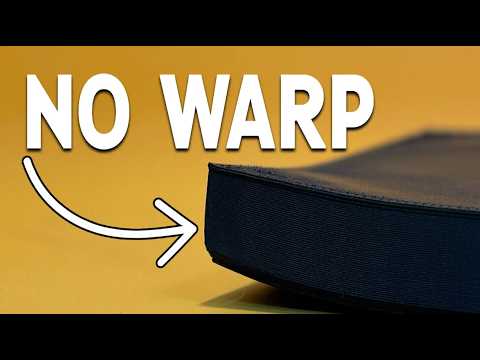

I already wanted to share this video, because it contains a lot of useful information.

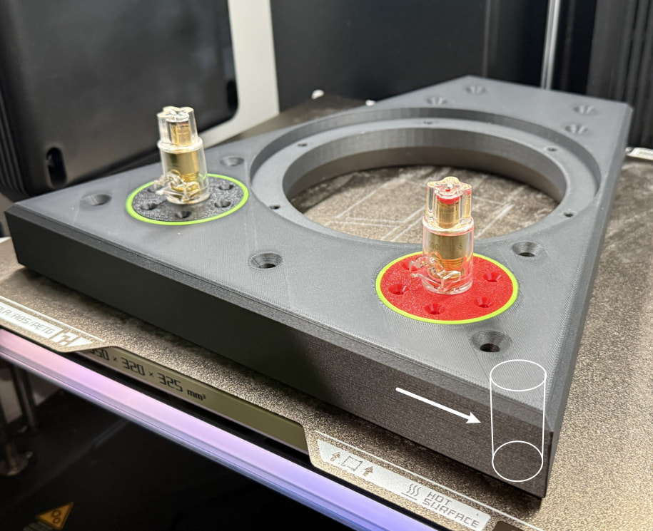

I’ve found adding an inner empty cylinder at near the sharp corner really helps, For such large piece, you would want to have multiple inner cylinders along the edges. You don’t need go from edge to edge, I typically go 1/3 of the length on each end.

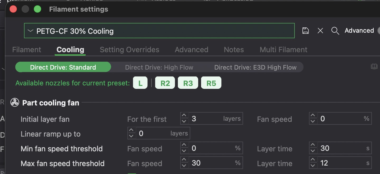

I might repeat some of the things already mentioned by others, but here is what works for me for large warp free PLA/PETG prints:
  1. Use a Supertack or Frostbite plate - the adhesion is much stronger
  2. Use gyroid infill - it wont pull as much on the side walls when it shrinks during cooling
  3. Reduce or turn off the cooling fan speed - will prevent overcooling and warping on large PETG items
  4. Turn off the AUX fan if its on
  5. Reduce or turn off the chamber fan speed if the printer is in a cool room
For me with large PETG items the biggest help to prevent warping was custom profiles with cooling turned way down. Here is a screenshot of my profile for large PETG-CF items
For PLA prints the AUX fan is usually the main culprit, all my PLA profiles turn it off.

Assuming geometry wont be changed –
The way the stresses line up from walls is inherent and unavoidable, you want walls, walls are your strength. A key part of controlling this bottom edge curl is the cool plate. If you hold the material under the glass transition temp, it cannot curl. It will break free suddenly, or pull the plate off the magnetic backing, etc, but it can’t just deform. PLA typically glasses at 55C, so a plate that lets you go under that is pretty key.
@designrama’s mockup is a good start for making the geometry changes. I’ve also found that just slapping a gridfinity template on the bottom [42mm square outline cutouts] is a quick and dirty way of deleting this frustration, but it isnt always a viable option
