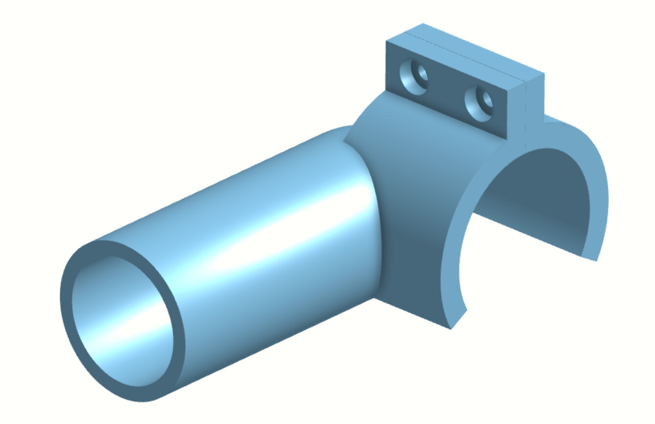

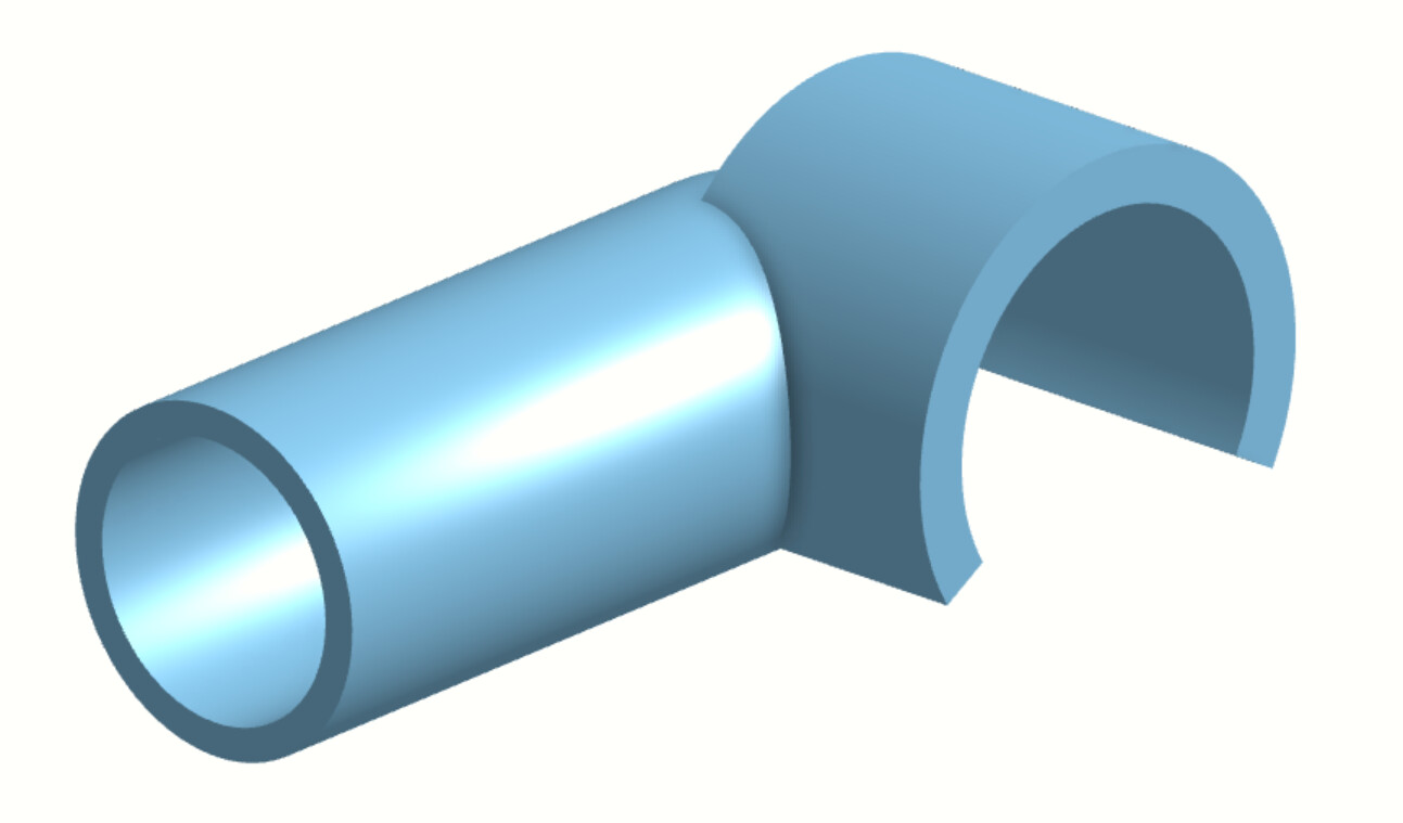

Having not seen your model, I can’t visualize your primary objective. However, if I may hazard a guess, since you’re placing it on a monitor, you’re likely trying to create some type of anti-glare shroud and hoped the matte filament would do the job. I recently made a shade for a garage door sensor, and it didn’t work as a snap-on item using matte filament due to the issues you described. My workaround involved two approaches, both of which worked.
Approach 1
I took my model and rather than making it a snap-on product, I instead divided it into two halves with a screw-on bracket. This approach worked better than stressing the clip-on Matte PLA version.
The regular PLA worked without this modification.
Approach 2
I used regular PLA and spray painted the interior of the shade with flat black paint which adheres very well to PLA. This allowed me to do a snap-on model but also have the benefit of anti-glare inside the tube where it was most needed.

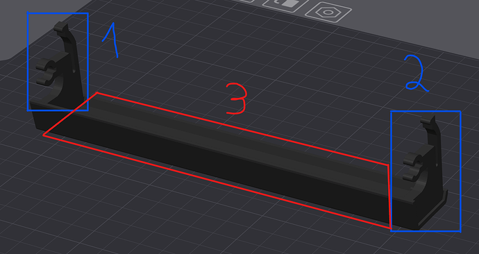

Ill try to add a picture of the crt controls cover in the top post, it breaks at the snap in point.
unfortunately I can’t add pics or links, its thing:2477001 in thingverse
One advice is to search for a similar model (683369) in Thingiverse, which seems better designed.
I didn’t check, but it may be worth looking in other repositories to see if there is a better model.

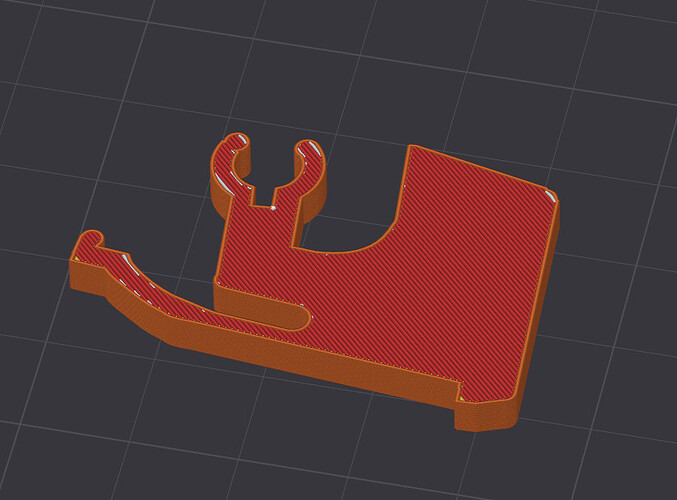

The model requires support for the snap hinges, which are also the most fragile region. I would follow Olias’ advice and split the model into three objects: the two laterals, which include the snap hinges and the cover.
Not only do you avoid using ss, but printing the sides horizons will also improve your print strength. In any case, either ensure a higher infill/walls and, if possible, a more adequate material:

hi jay, thank you for your analysis and time! I have already printed this model with separate hinges and looks great, unfortunately the clamping part is too wide (bigger diameter than it should) and the whole cover wobbles when attached. I need to see if there is a way (i.e. using tinkdercad) to reduce the diameter.
