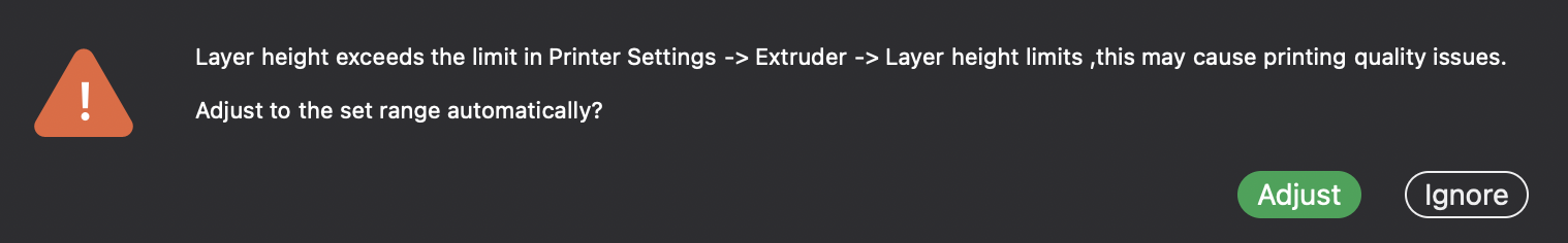

Layer height exceeds the limit when it actually doesn't?
i get this error when setting the layer height at 0.12mm,on the extruder settings the settings are these
doesnt even make sense?how to fix this?
Did you try the “Adjust” button?
That warning appears mostly when I open a project saved with a different nozzle size and then sync it with the device’s actual configuration. The funny thing is, the warning pops up regardless.
It definitely appears if you sync a device with a 0.6mm nozzle to a project saved for 0.4mm with 0.08mm layer height.
But it also happens the other way around—and it’s not coincidental that it’s 0.12mm. When you open a project saved for a 0.6mm nozzle with 0.12mm layer height and sync it with a device that has a 0.4mm nozzle, the warning still appears even though it shouldn’t.
If you click “Adjust,” it basically changes nothing.
