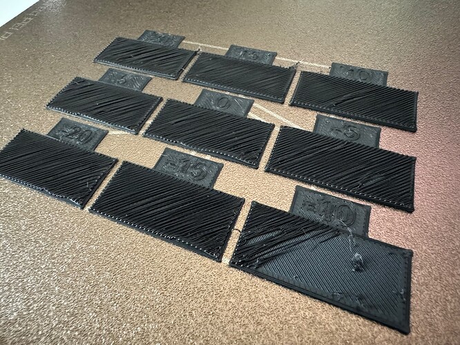

Hello everyone,
I have been using a P1s with AMS for a year now. I’ve recently decided to upgrade the a Hardened Steel Nozzle 0.4 and a Hardened Extruder Gear. I’ve switch a couple of months back, but because I was having the issue I am going to shortly described below I switched back to the Stainless Steel 0.4 Nozzle and everything was back to normal. After studying a bit more I have decided to give it another try.
I have performed the standard maintenance, including cleaning the Hardened Steel Extruder Gear, and mounted the Hardened Steel 0.4 Nozzle again. I have also cleaned and applied to thermal grease as a thread in this forum suggested.
Printer settings and Bambu Studio have been changed and synced for the Hardened Steel 0.4 Nozzle. I run a printer calibration and a Flow Dynamics calibration that was ok. But when running a flow rate calibration this is what I get. I am using a BL Matte PLA, dried and AMS humidity is at 10%.
Of course prints fail and even second calibration fail as after a few layers the material doesn’t stick to the underneath layer anymore.
At the beginning I thought the problem was with the Extruder Gear tension since I have noticed debris inside and I thought the gear was too tight on the filament. But changing back to the Stainless Steel 0.4 seems to solve the issue.
What should I do? I have a friend that changed the set up and he has no problem whatsoever. I also did not find any solution in the forum or no one with the same issue.

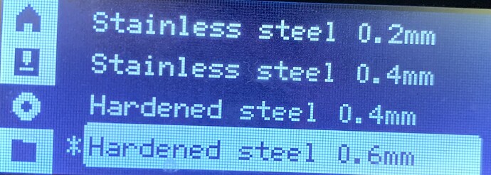

You have to switch the hardened hotend on printer setup, not in studio.
Thanks for your reply, I have already changed it in the printer’s settings and synced in Bambu Studio.
Check the filament path. Perhaps the PTFE tubes are too rough. This looks like under-extrusion when it gets faster in the 2nd layer.
Everything seems fine, I switched back to the Stainless Steel Nozzle and prints normally. I’m starting to wonder if I got a faulty Nozzle.
