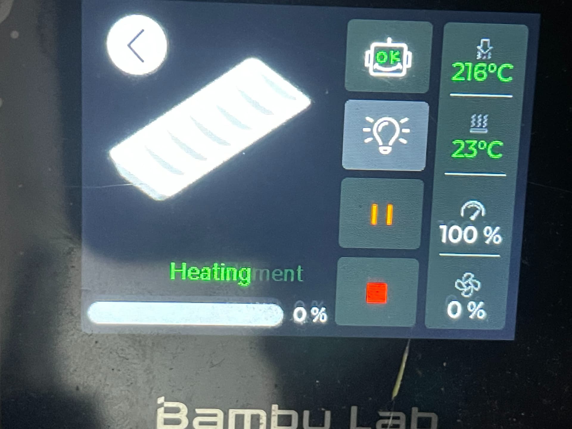

I could have swore that I have seen the layer number on the A1 mini display that is on the printer but now lately I don’t see it. I can see it in the Bambu Studio page though. Does the A1 and A1 mini have that available? I read somewhere that I may have to add an M117 command to the G-Code but haven’t tried that yet. I also looked in the preferences in BS and don’t see a switch to enable.

You need to switch the display screens.
Click on the model icon on the white screen to switch to the black screen.
You mean on the printers screen correct? The reason I ask is that I send the print through wifi to the printer and let it carry on by itself with the occasional waking up of the display. I will try it on my next print.
Thanks
Press this.
Get this.
You will find all the status messages including the layers info and such.
You can also change temp, and fan speed and toggle the light from this seemingly hidden screen.
You can also change the speeds from here, did you know there is a speed setting called Ludicrous?
