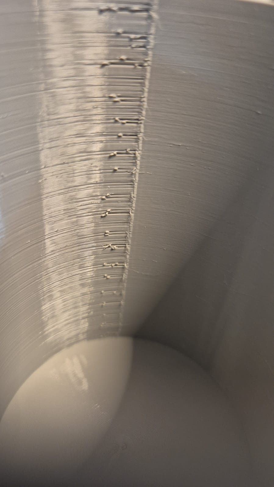

Layer ripping on wipe with PETG
I’m using Creality Hyper PETG with the profile of Bambu PETG-HF and limited the volumetric speed to 12mm3/s.
However I have a problem with the wiping procedure tearing apart the layer lines.
I think the problem has to do with cooling or layer time, is that the right approach?

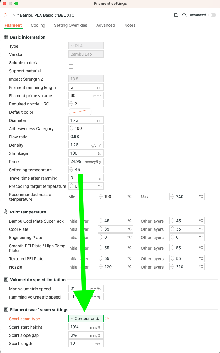

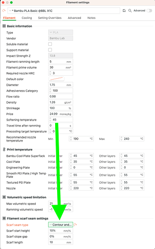

Try using the Scarf options in the filament settings.
Also, use the seam toggle (click the line entry) to see them in the preview.
Read my recent answer with more details on this feature, and it will help you understand the cause.

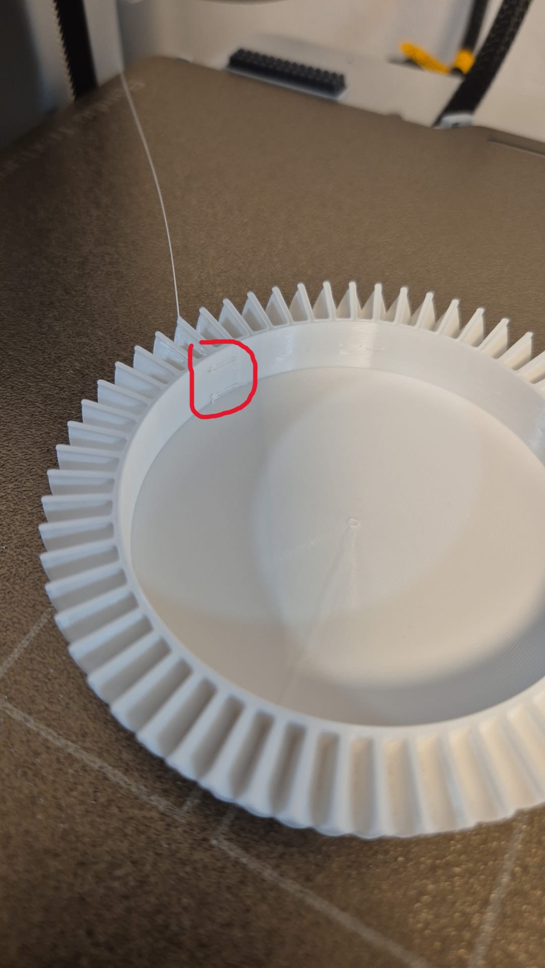

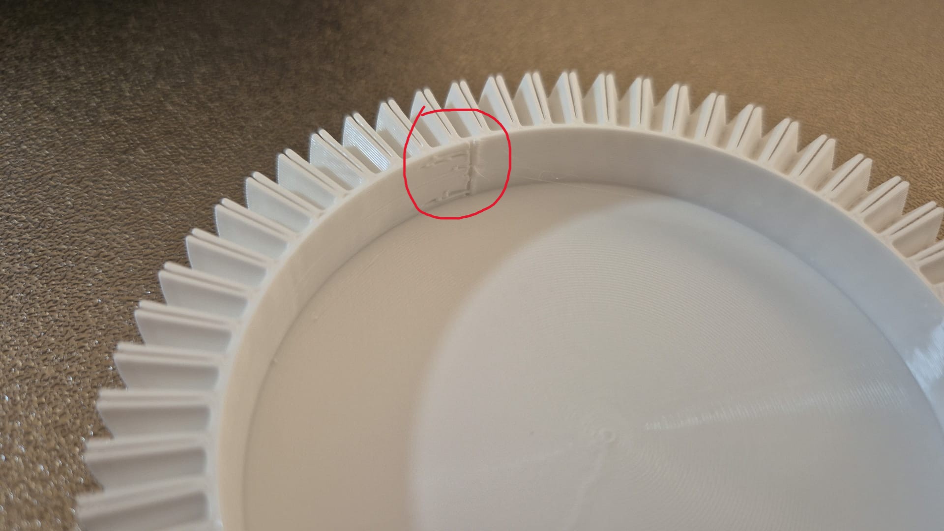

If you look carefully in the picture you will see that the seams are fine. What is not okay is that after the seam the layer lines have peeled or ripped off by the nozzle. When I looked in the slicer I could see that the printing was from right to left. So the conclusion I’ve come to is that during the wiping action the lines are getting ripped off by the nozzle.
I am wondering, if you switch to Scarfs does the problem go away?

Not sure about that big “string” at the end though. That is rather puzzling as there should have been a retract before finishing the print…

If the printing is from right to left, and the pic is not upside down, then I would suggest that you look into your travel and retraction settings. It looks like there isn’t enough material/hardened material in/on the nozzle on the LEFT of the seam, aka when it starts printing the line. Ooze loss?
When you took this off the plate, was it full of wispy crud? That could be your “missing material.” aka ooze control
Follow PETG anti-ooze recommendations aggressively and see if it helps. (travel speed/accel/jerk UP, retraction test this filament, print speed slower, arrange models so there isn’t a long travel between them, etc)
