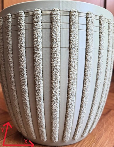

I have a Bambu A1, and I tried a large model printing for the first time.
During this print an issue occurred during the final part, I am ssuming that it is a Y axis shifting.
The maintainance on X and Y axis was done a couple of weeks ago, with cleaning of the rails and oiling them.
During the printing i noticed that my A1 started to do a lot (i mean 10-20 times) of home reset during the print of the upper part of my vase model, so i think it started losing y steps.
This is a front view of the printed model:
As you can see, at certain layer (around 550-600 on 700 layer total) printer has started to create the issue.

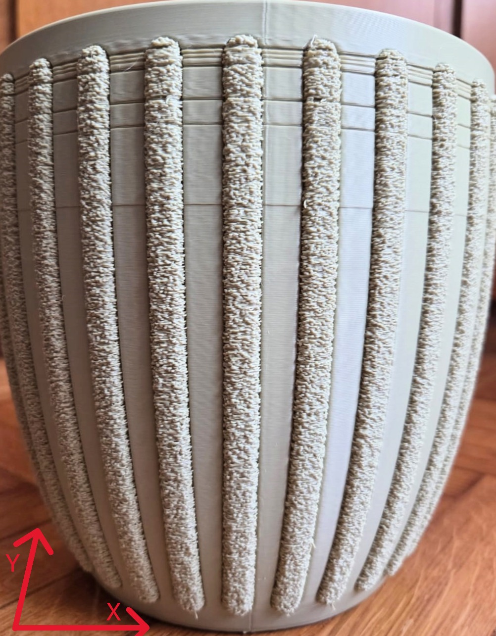

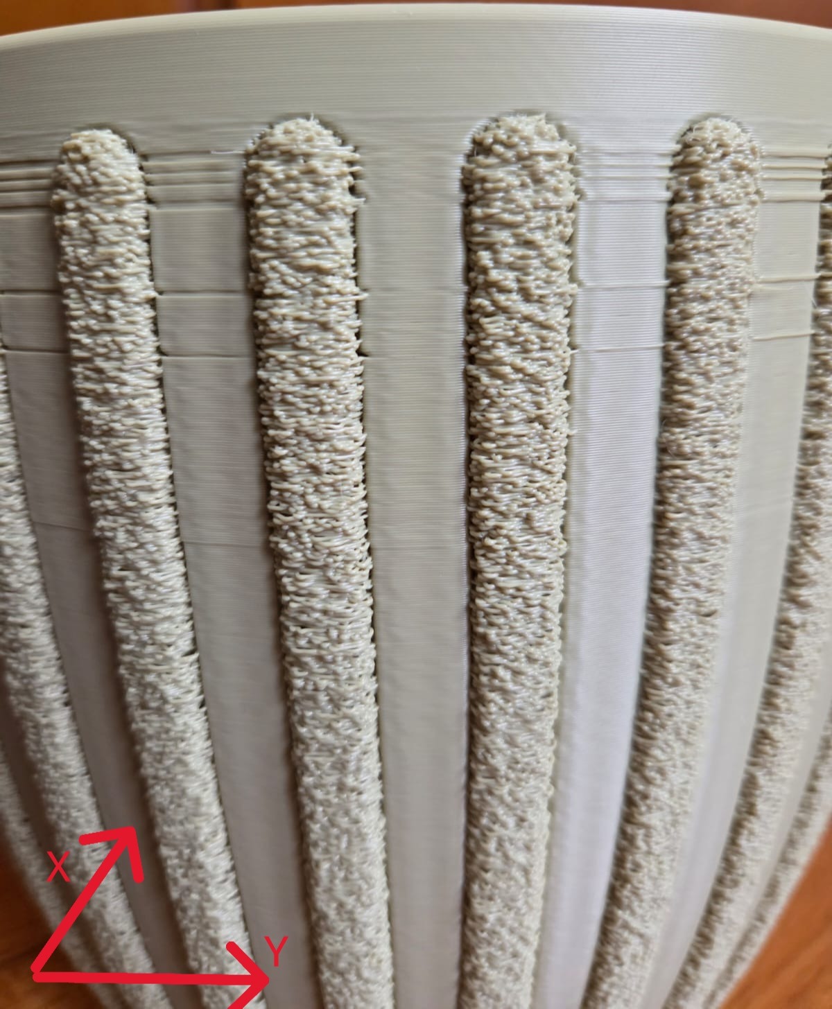

This is a lateral view of printed model, as you can see the middle section is ok. That’s why I am assuming that there is shifting in Y axis direction:
I don’t know if I made something wrong, and to possible solve the issue.
Any hint or suggestion is welcome.

I’ve recently had this same phenomenon myself. I was printing a downloaded model directly from MakersWorld, and no one else seemed to be having that issue with it. So I assume it’s something in my machine, and not the code.
