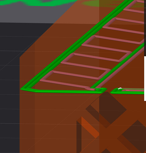

Here is the geometry that is causing the problem:
This overhang requires 100% fan cooling. So if you have Pre start fan time at 2s, that means the entire outter wall would be printed at 100% fan for this geometry:
Its been a hot topic since the h series came out. Some other branded printers dont do it, but people will say its inevitable.
now i’m starting to think maybe it’s the slicer’s fault, the default profile’s 2second pre start fan time is obviously causing problems for challenging geometries. I’ve submitted an issue on github to urge them to turn this off by default or give us better options than current implementation.

The core issue here is that the fan mover in gcode can only work with line segments. And line segments can be very long (like this outer wall).
So basically it’s not a “easily perfectly soluable” problem with the gcode centric FDM. Very unfortunate. But still for this part i think turning off pre start fan time would be better than leaving it on.
yes it’s ribbed because of the, over cooling. it’s blasting fan at 100% all the time for those textured areas. sorry this isn’t really your fault, but a problem that’s just very tacky, and it’s caused by another compromise that we’re facing…
So basically, fans cannot be boosted from 20% to 100% instantly. Ideally it should but in reality it takes 1-2s to actually do that. So to improve overhang performance, at some time Bambu Studio and Orca Slicer introduced a new algorithm to turn on the fan EARLY, so that it ensures the overhang quality.
This usually won’t cause any problem for PLA, but it would become a problem for filaments like PETG. Especially PETG, because its overhang fan speed is usually still kept at 100%. While higher temp filaments usually capped the fan speed much lower, for overhangs.
So now the problem is your walls are printed with 100% fan when it only needs 20%.
Is bambu doing something wrong? no. it’s needed for the overhangs of the petg.
Is bambu doing something right? no. it’s overcooling the wall.
So why this is happening? because we’re printing gcodes. And gcodes can only operate the fan on a line to line basis. That means all the line segments within that “2 seconds” time window would be affected by the fan boost.
For example, if Line D is overhang, Line C takes 0.1s, LineB takes 0.5s, and Line A takes 3s, unfortunately Line A would be affected too, by the default 2s pre start time.
