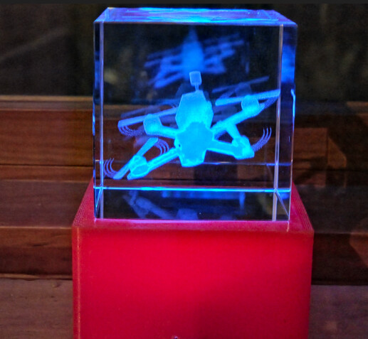

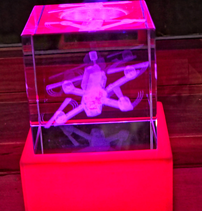

Red PETG base with 5 walls, blue LED on left, red(ish) LED on right.

The key for maximum brightness is to make sure the TPU color is transmissive for the LED color. Easiest way to achieve that is to use clear TPU or a color TPU that is similar to the LED color.
Like in my pictures above, where the PETG is much brighter when the LED has more red than when it has more blue. There’s a little microcontroller in my print that changes the LED colors continually. The colors at the blue end of the spectrum don’t show through the red PETG as well as colors at the red end of the spectrum.
