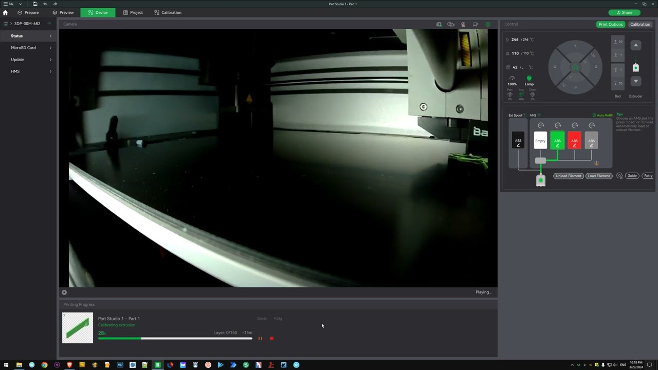

Here’s a couple of videos of failures for your entertainment. I filmed the main colors/brands I use for daily production. I recommend fast forwarding.

My goal with G10 was to save time by not having to glue up build plates anymore. I print anywhere between 200 and 1800 parts/month. Having to clip and clean up mouse ears takes longer than washing off a little bit of glue.
