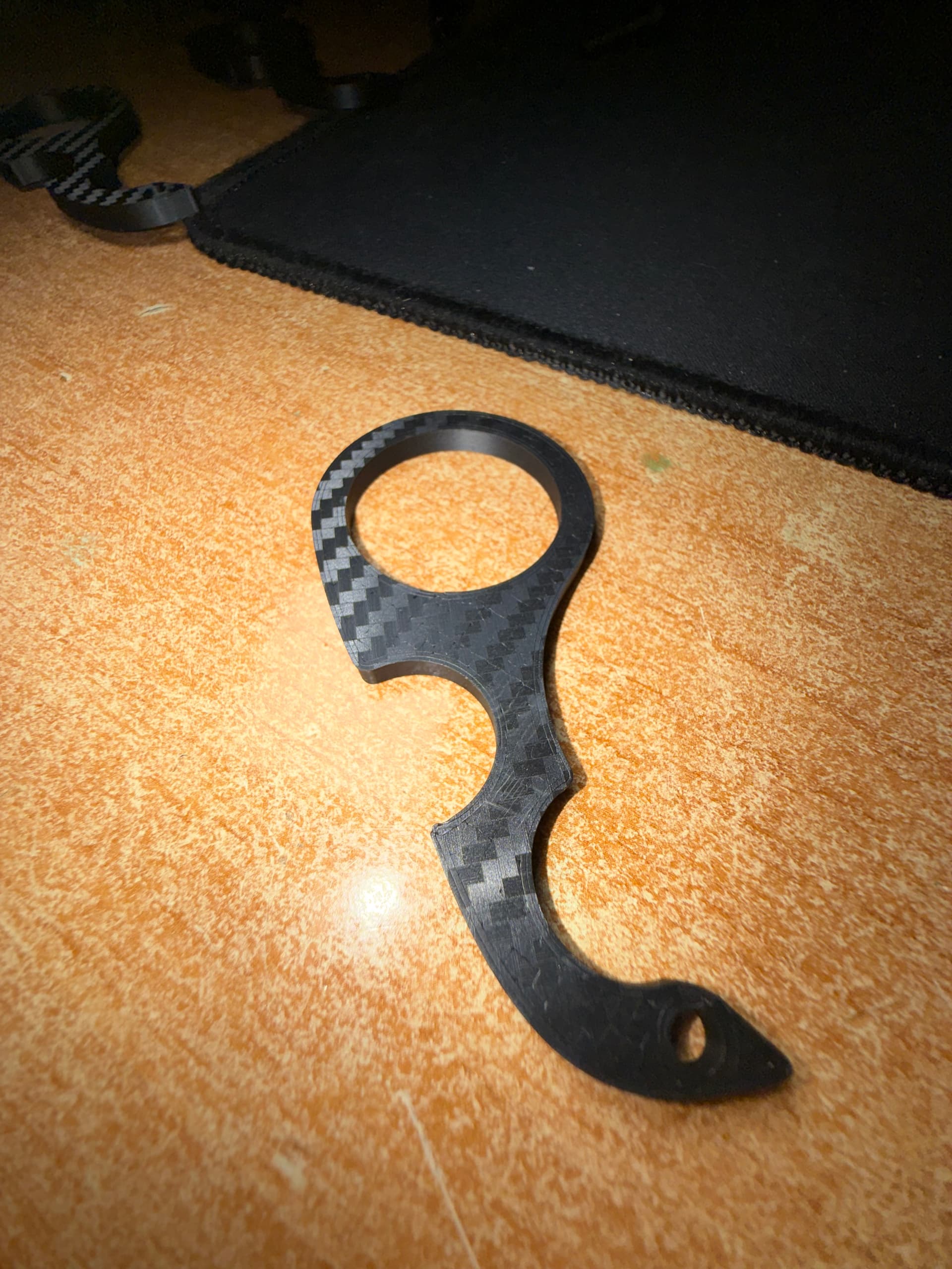

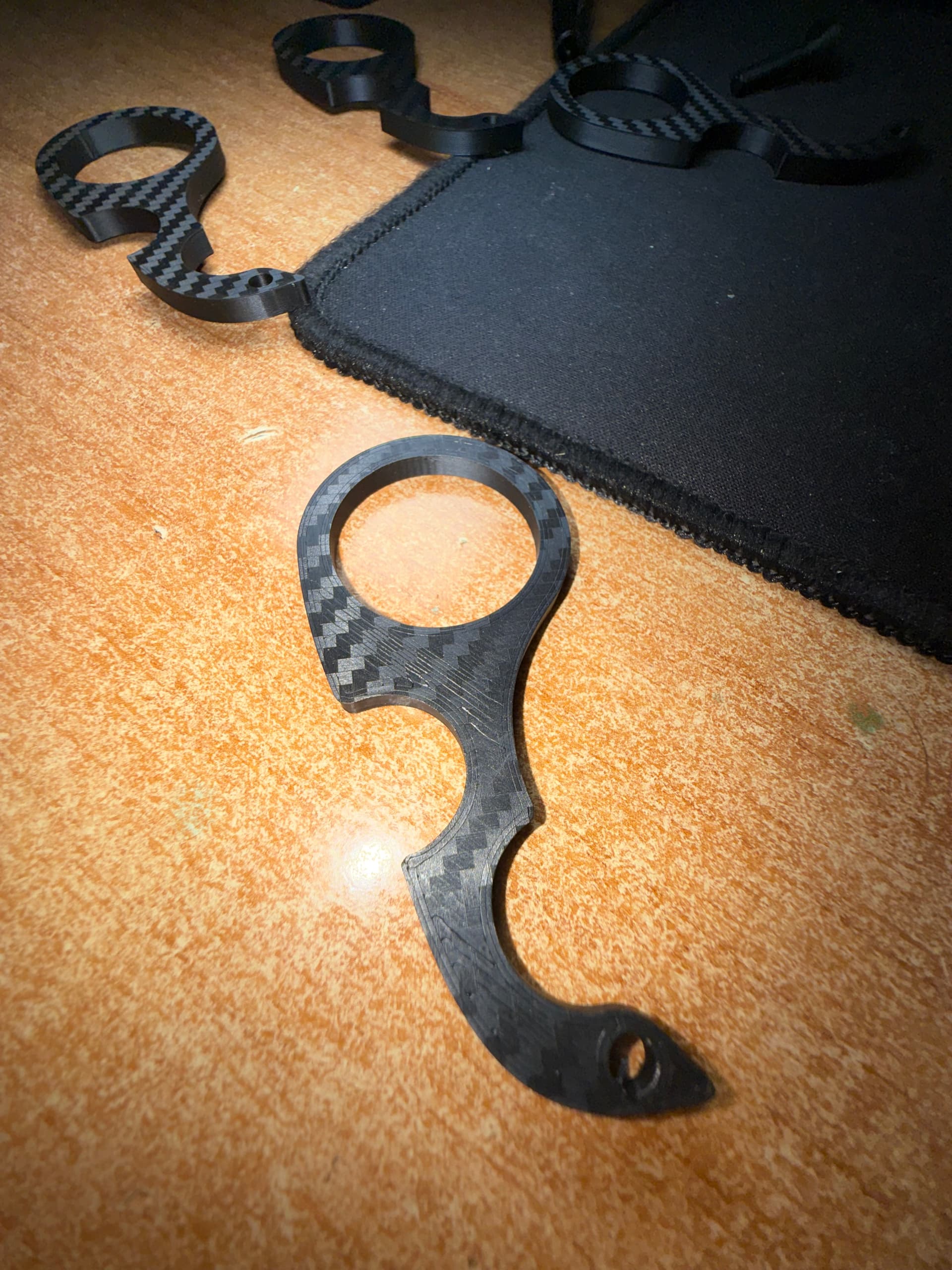

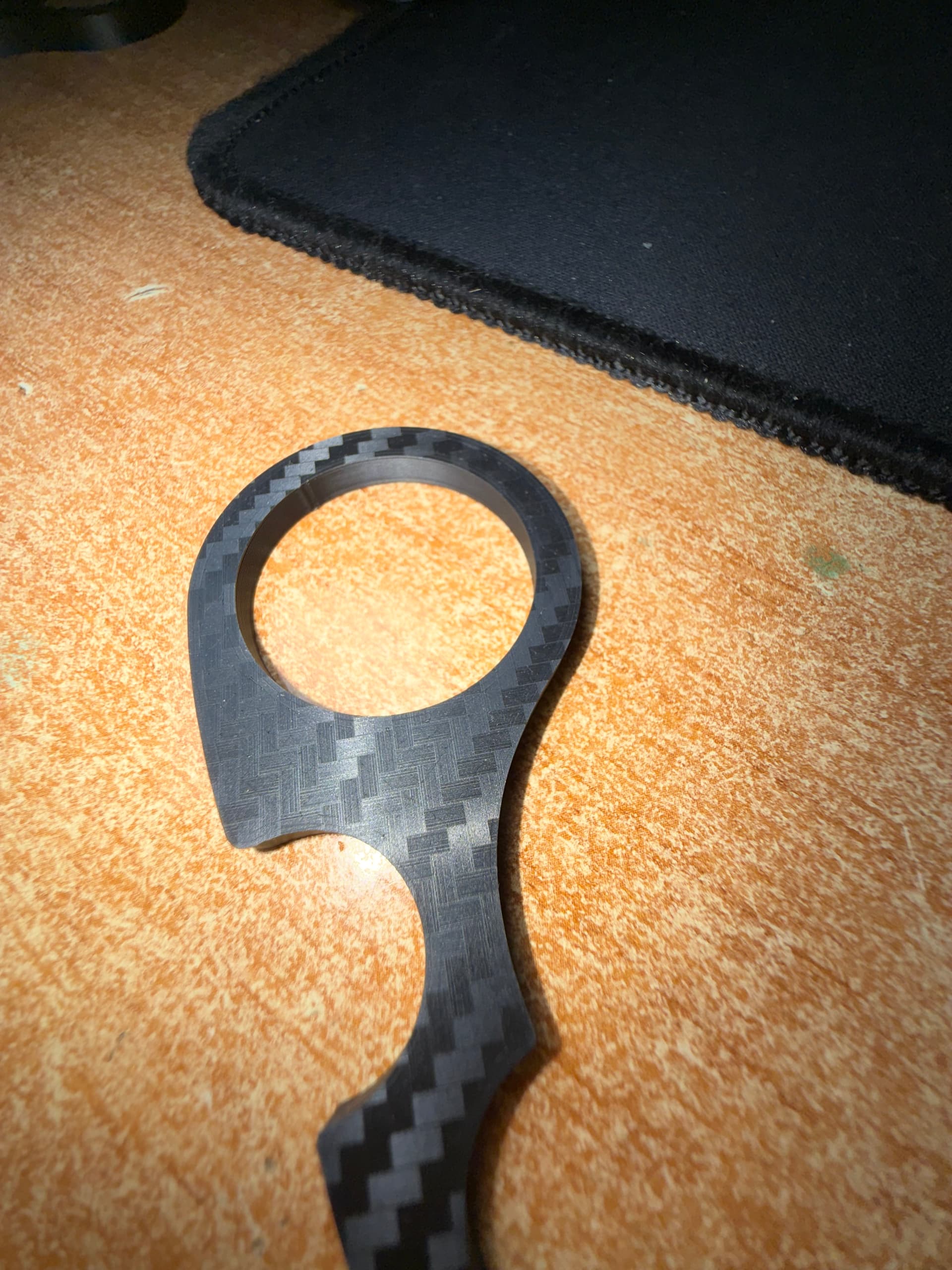

Hello everyone, I am facing this problem:
When using the Carbon Effect Plate, I get these ugly lines and spaces on the bottom surface. I would like to have a clean bottom surface without these annoying lines and spaces, so I can fully enjoy the carbon effect.
Specifications:
BambuLab A1 printer
Carbon Effect Plate
0.20 Standard Quality.
The filament is calibrated with these specifications:
PLA Basic Black BambuLab
Temp: 215
Pressure Advance: 0.02
Flow Ratio: 0.97
This is what I have tried so far:
Leveling the bed with the carbon effect plate
Reducing the width of the first layer line from 0.5 to 0.4
Reducing the height of the first layer from 0.2 to 0.08
Using Hilbert Pattern for the bottom surface
Adjusting the initial flow ratio, various tests were performed from 1 to 1.04
Slowing down the printing speed to 30mm/s
This is the first print where I actually noticed the problem.
This is the second print where I tried the Hilbert curve.
This is the third print where I tried the Hilbert curve and the line width, height, and flow settings.
As you can see in the third print, I got very close to the desired result, but there are still some small lines and spaces visible.
Notes: I noticed that increasing the initial flow rate above 1.03 began to cause quality issues, further worsening the first layer.
Unfortunately, even after trying everything, the lines and spaces remain visible.
Thank you in advance for helping me solve this problem

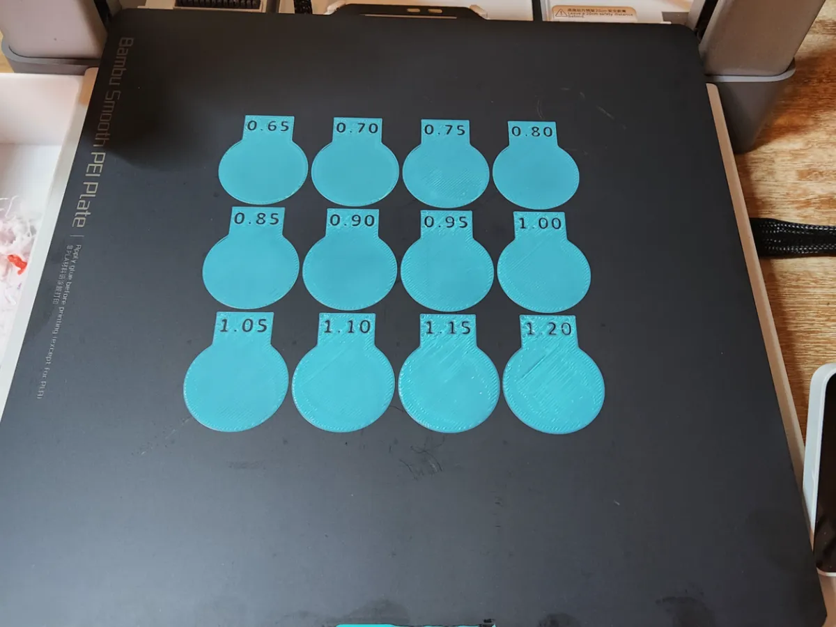

  2. You mentioned Initial Layer Flow Rate but you increased it rather than decreased it. I use this profile to determine the ILFR for a given material at a given temperature with a given nozzle. It’s usually in the 0.90-0.95 range for me.
With time you can sort of use an educated guess for the parameters. I tend to set ILFR at 0.95 as a matter of course when using smooth or effects plates.

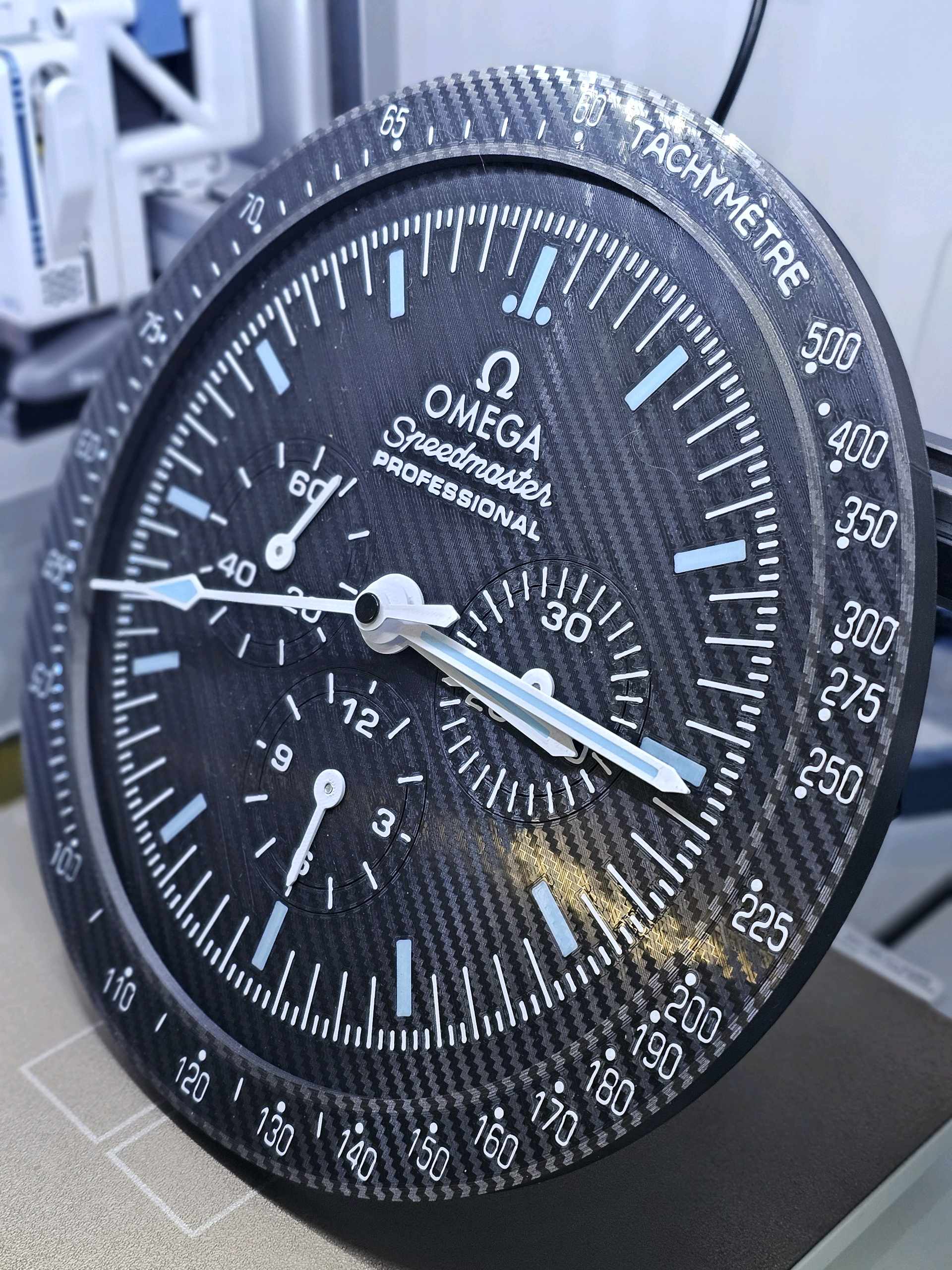

Good question.
I get more successes than failures by setting ILFR to 0.95 on smooth plates. I printed off Grant’s Omega Speedmaster clockface a couple of days ago using a carbon-fibre effect plate. It came out well, with detail on the effect and a shine to the surface. If you look really closely you might see a couple of underextruded lines but you have to specifically go looking for them. The details of the print itself along with the plate effect hide most first layer imperfections.
Apart from ILFR, the only other settings that I check are to manually calibrate the k number for new spools in Bambu Studio, dial in the filament flow ratio and dial in the max volumetric speed. Once a spool has been characterised like that then the filament profile can be locked in and saved. It takes a couple of hours of time and 10’s of grams of material to run the tests, but once they’re done they’re done.
